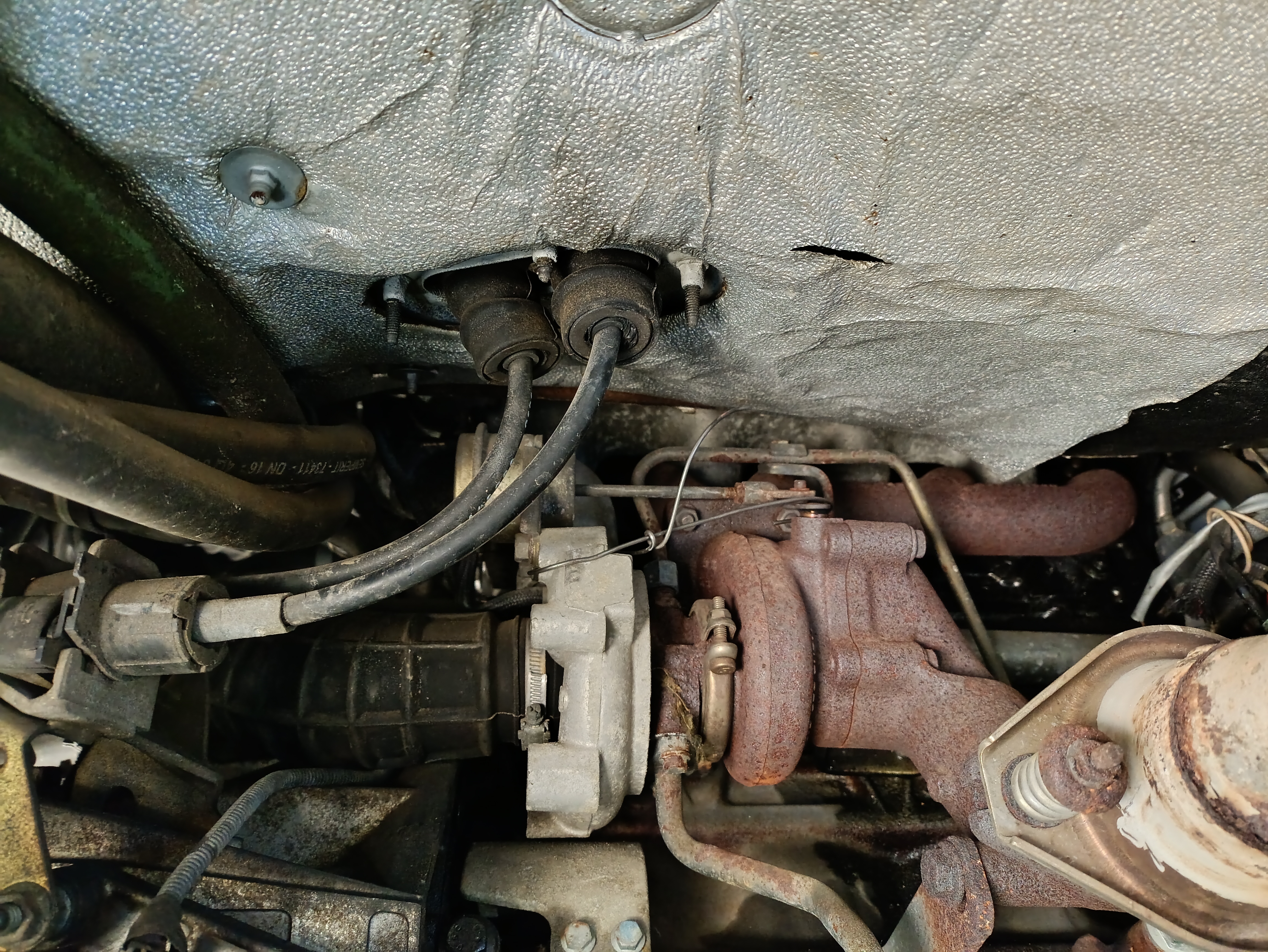

So two things going on here I think.
First the info on the air con was very useful regarding the click so ignoring for now as we don't use it anyway because it's next to useless in 24 C plus.
Next looking at the turbo waste gate actuator linkage and yep, it has snapped off.
Temporary fix with a bit of wire, going in for a new pin to be welded on next week. No more black smoke.
Thanks everyone for the help.
I am pleased that the problem has been resolved. This is not the first broken turbo link that I have read about.
