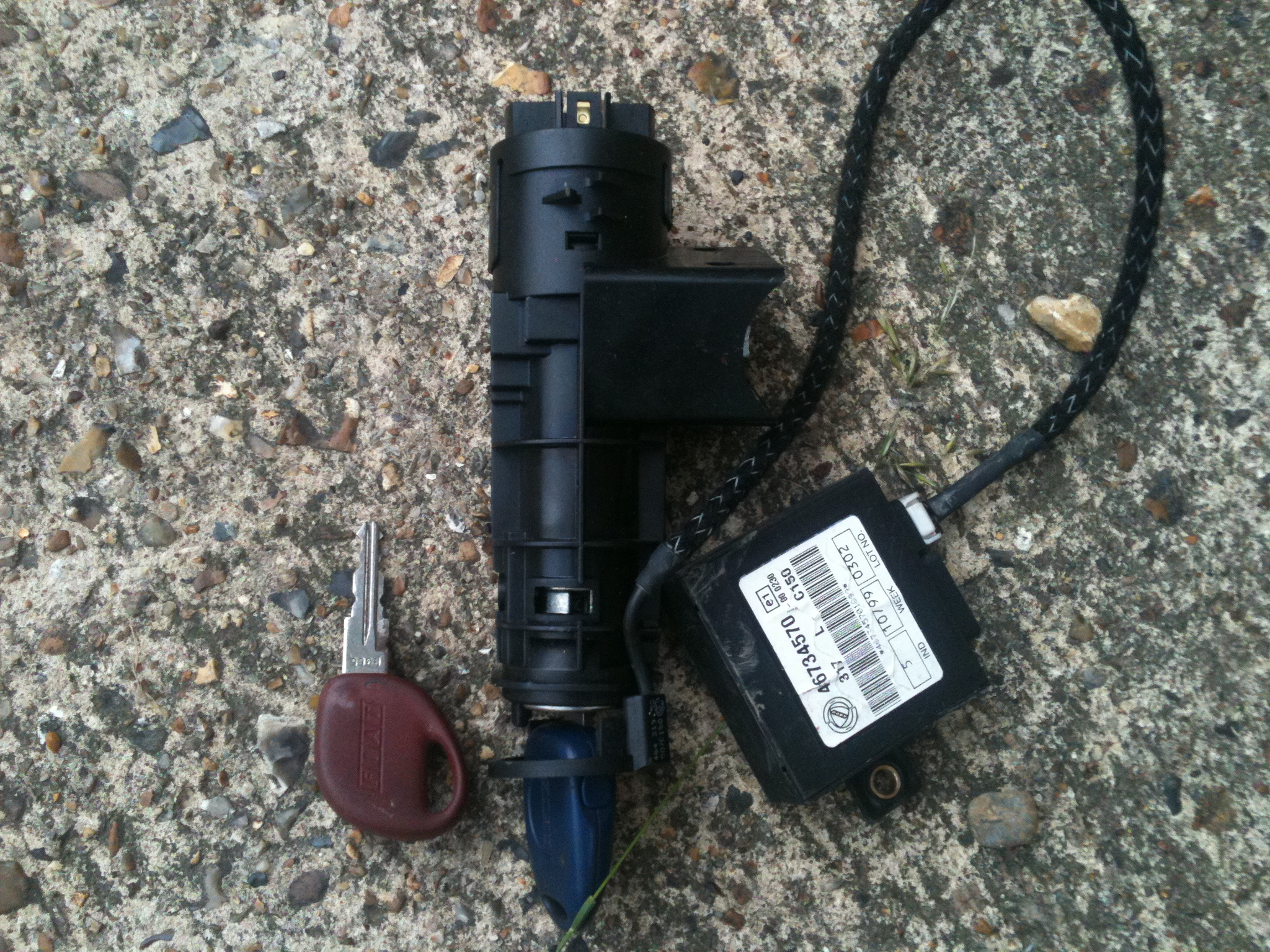

get P85 ecu, code box, key, wiring loom. Then cut and match the wire up to the cinquecento in car loom at the d4.
Ming
what is the code box ? and the d4 is the connector on the picture?
i did my wiring but still no spark ore running fuel pump... i spand many hours no the research...
can i fit the punto codebox on the cinquecento codebox connector?

is the code light going off??? as it sounds as though the immobilizer is locked.you need the transponder key(red key) the code box and the ecu all from the same car otherwise it will not start:bang::bang:

i know the key and the box and ecu are from one car. sometimes it goes out and somtimes stays on :S
but this is the wiring that has been done?
punto codebox under the cinkdash on the cink codebox conector and the red key on the ring
