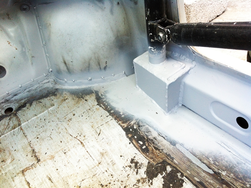

We welded and customized sparco roll cage and welded the chassis as well and painted (primer).

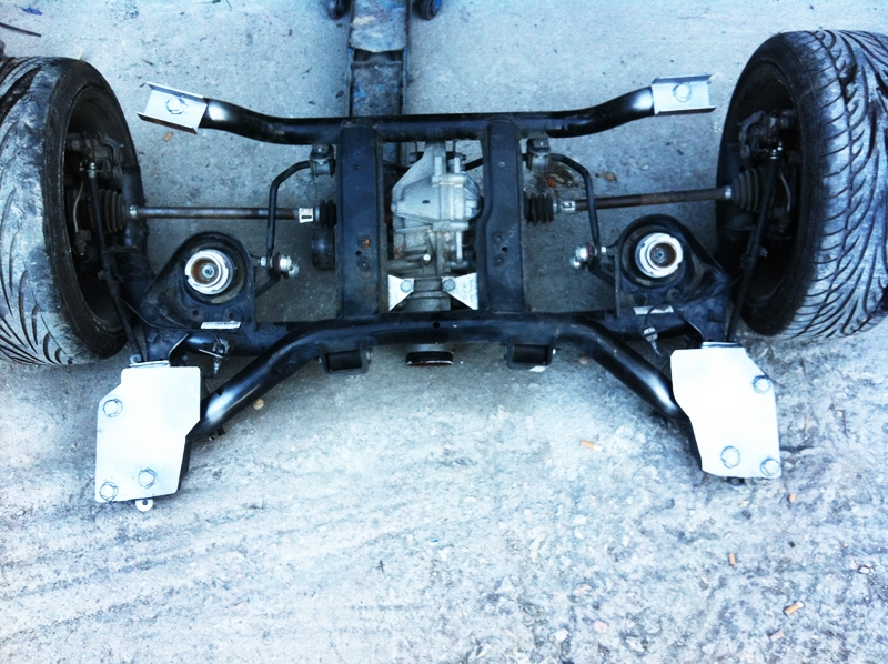

We have customised the mount points of the rear (panda) axle.
attachment.php

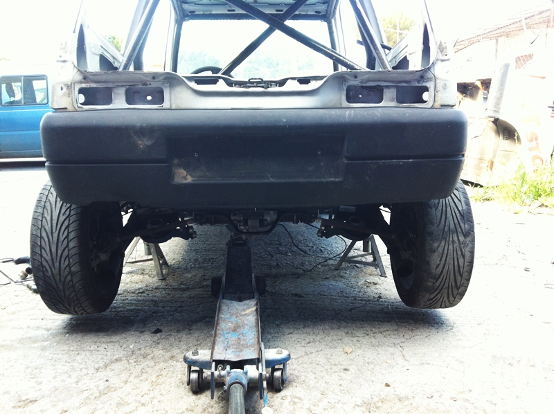

We mounted the axle at place and welded the mounts at place.
attachment.php
I think we will need some WIDENING here...

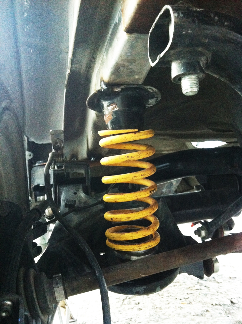

Custom made mount points for rear springs. Notice that the mounts (cones) are from a real axle of a normal 'cento.
attachment.php

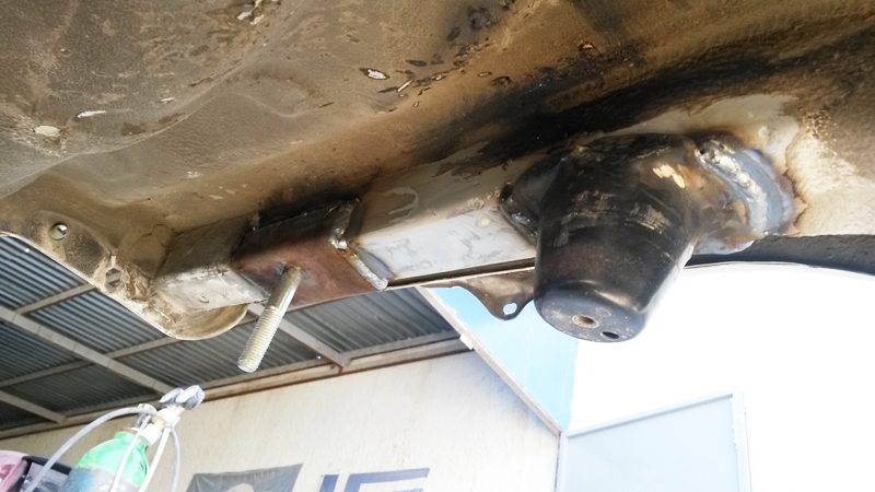

Axle rear mounts and spring mounts welded at place...
attachment.php

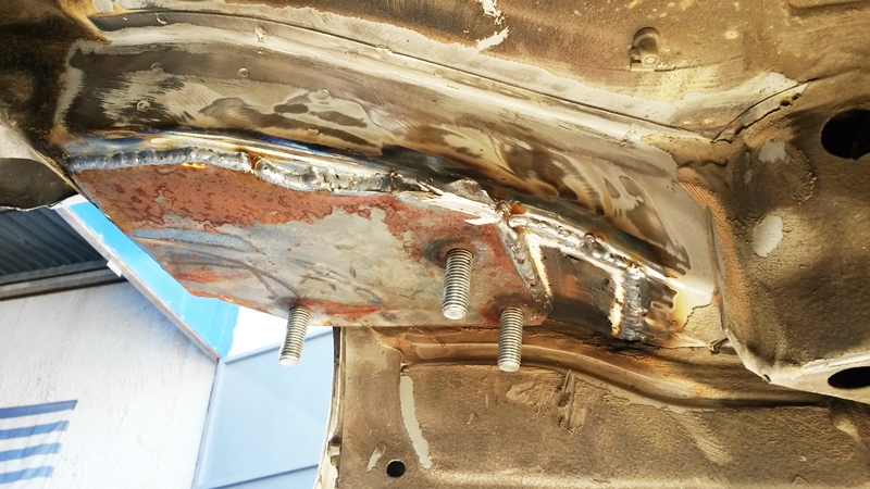

Axle front mounts welded and polished..

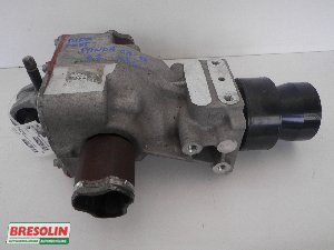

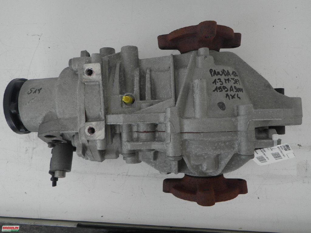

So, first of all, does anyone knows how this diff locks? I mean through the valve? When the valve is open? How? It is not viscus I think.
My Diff is like this type:
attachment.php
I think viscus was this type of diff. Am I right?
attachment.php
