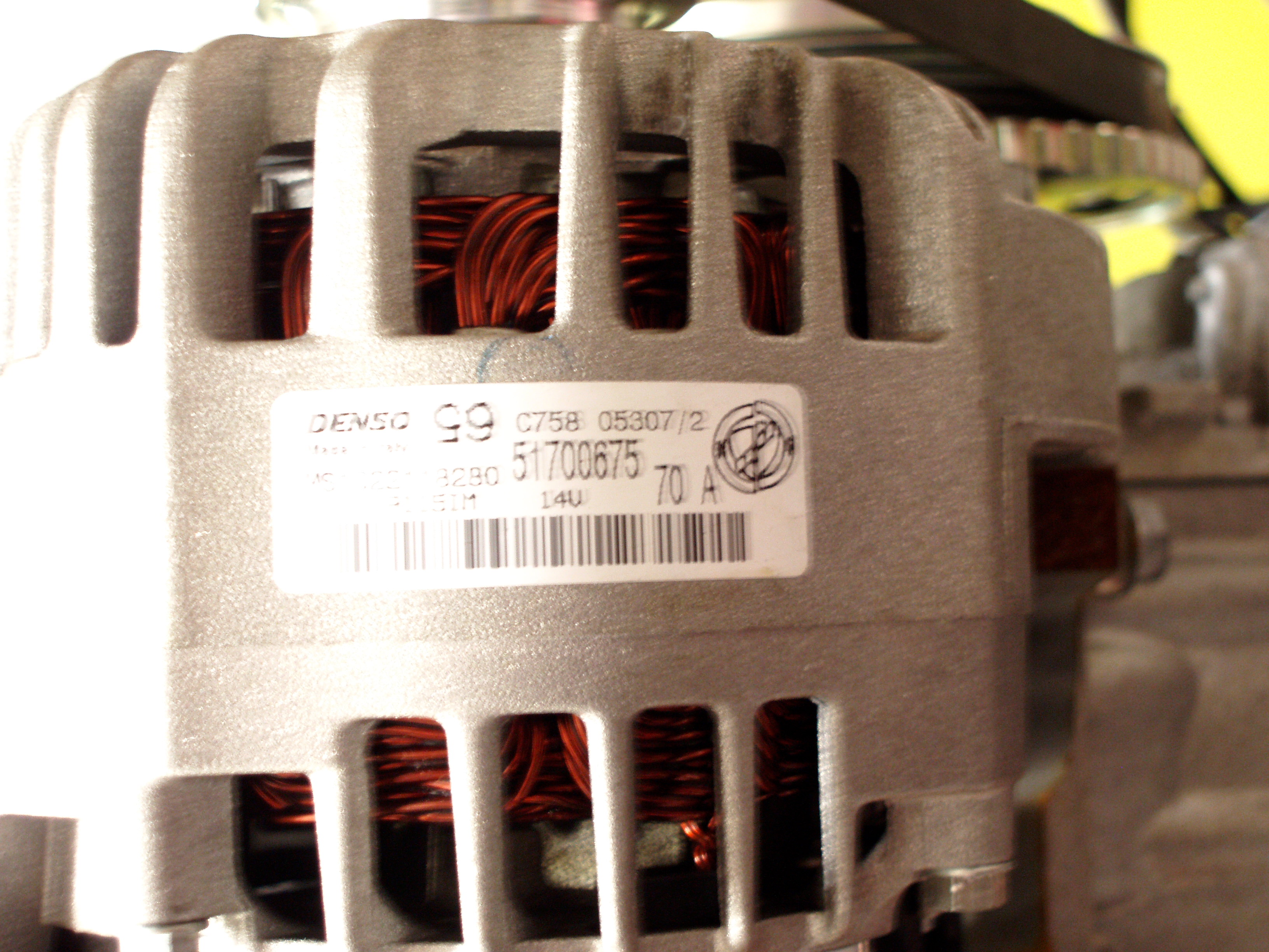

you swapping the alternator and pulley over from the cinq? Still unsure what you did on the sei with regards to that.
No, didn't do it on Sei, so see no reason to do it now :) This is a higher output alternator 70amp, think one on the Sei is the same, bit better than the 55amp Cento's come with. :D
IIRC we took a little off the bracket and made a spacer but there wasn't a huge amount of work in it to make it all fit.
