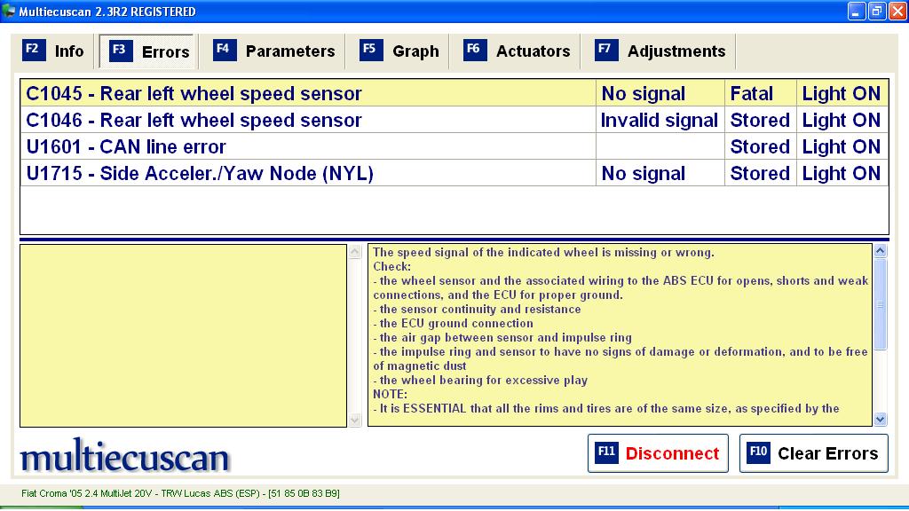

Looks like an issue with the rear abs sensor, either sensor itself of dodgy magnets on the bearing. I`ll get my mechanic to investigate

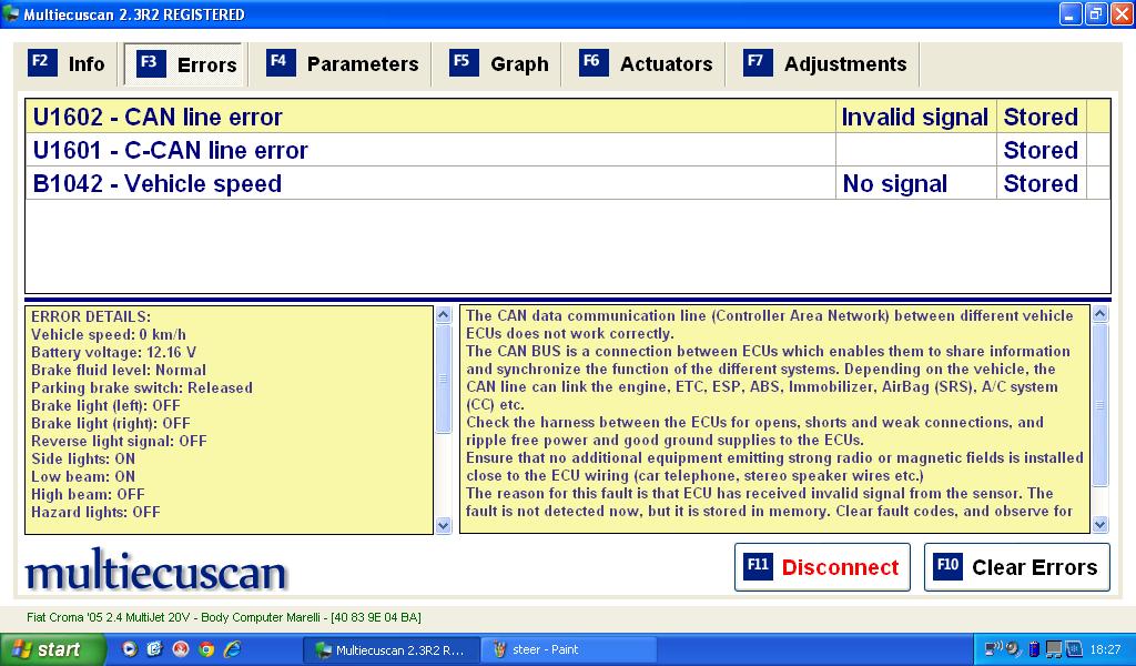

I found the mod for what I think is a 1.5 interface, just had to remove 1 resister and I pretty much have access to everything.
Can bus was complaining it couldn't talk to a pollution sensor,
There was a complaint regarding loose connection on steering and a problem with rear abs
Interestingly, my door electrics are working, however the odometer is flashing.

K, will go in for rear abs issue, I'll get mechanic to check this

Here are some screen grabs.

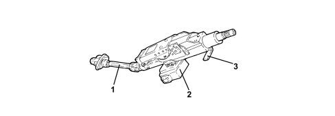

I want to look at this steering connector, is it inside the adjustable bit?

Hi Scub to get at the connector you will have to take the trim off between the wheel and the dash the bottom part is held in place by three or four screws and fiddle with rake lever with the bottom trim off you can get to the screws that hold the top with a push and yank it will be free the fabric will allow you to lift it to one place. Now to that plug pull the wheel toward you and lock it, shine a torch down the left hand side and see the connector six or so inches down the steel column reach down and push it in. I do hope this fixes it trying to find a suspect earth lead will be irritating. The abs fault could be genuine and might be dirt on the probe or a bad connection.
REplaced the abs hub.
Thats the whole underside of the sterring wheel down to the airbag exposed. Only connection I see is to an Aluminium cast box. I`ve given all connections a wiggle and nothing bad is happening.

Sorry to hear of your continued drama, just to be clear have you taken the column trim bottom and upper off it is a fiddle as they fit into the back of the steering wheel but the plastic is flexible ,the upper trim is joined to the dash by a piece of fau leather but just lift it clear. The column inside is a steel box that when unlocked permits in out movement for the steering wheel the connection is on this steel box section column I did have to push my hoof a fair way down to push the connection in .It does not seem to have anything to lock the plug in place!.
If I get a Minuit next week I will take a photo.
Yup I seen that, it seemed fine, and had to pull down the shin airbag to get my hands in.
