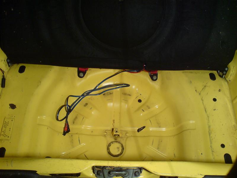

and then remove the battery, cutting off the terminals (battery is on the move)
emptying the boot

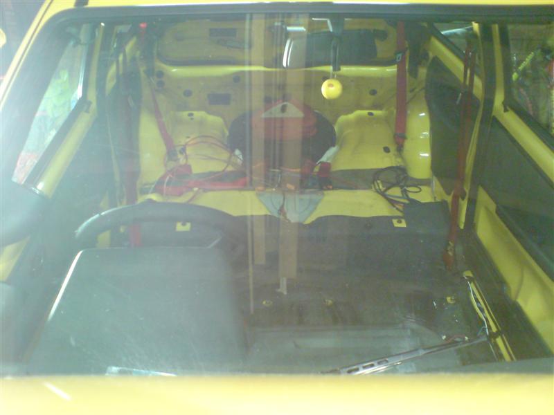

and then empty the car

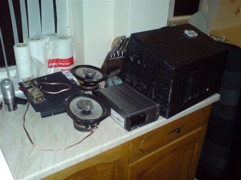

and look at all the stuff that came out of it!
and some of the ICE - bet this stuff slows the car down a bit!

let me know how battery in boot goes its something i want to do to mine really :eek: :D
Its dead easy to do. Use a bulkhead fitting and attach the existing battery wiring to it on the engine side. Then run a new cable from the battery box to the habaticle side. Earth the battery straight to the shell, and Robert is your mothers brother.
Cheers
D
35mm Would be ok. I use 50mm on Emergency back up batteries with a draw of 180 amps at 110 Volts dc. This would be continual load for up to 2 Hrs where as yours is short term load for starting only.
