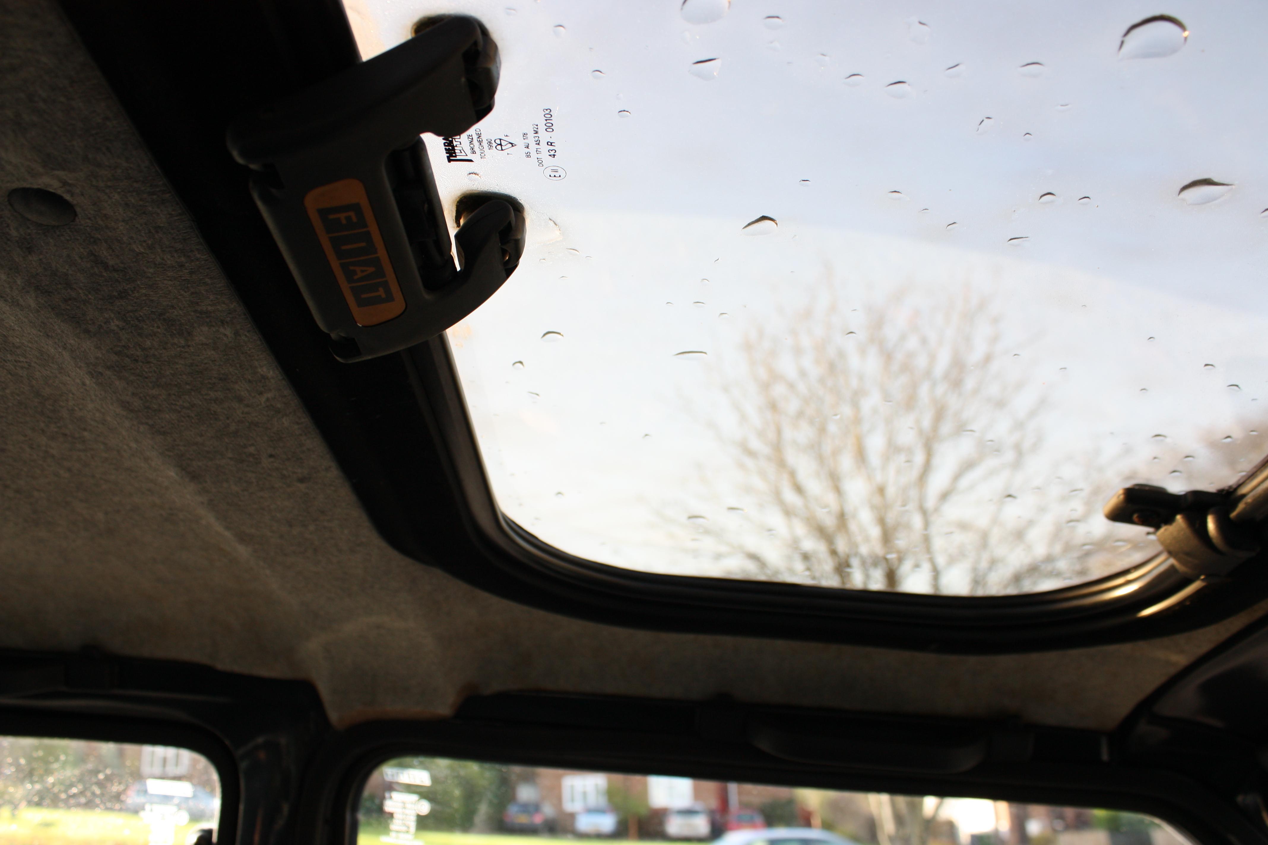

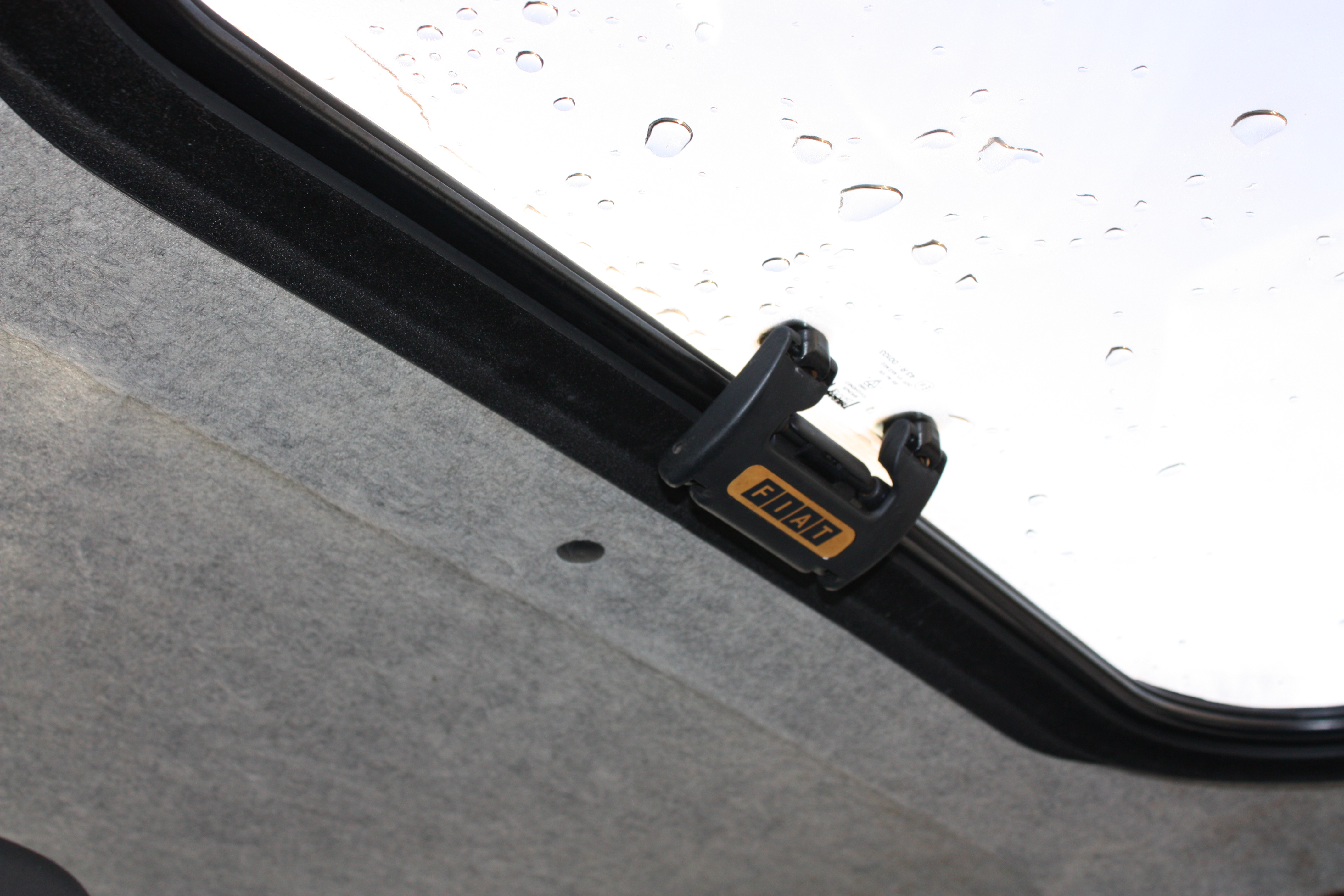

same as the one fitted to my sisley, that poured water in.. thankfully the seats were covered in plastic sheeting when i got it.
you can stop it leaking by adjusting the bolts holding the open and close handle on.. it works really well...
mine does not leak a drop even if you are blasting it with the hose now :LOL:
That sounds worth a go - what needs adjusting exactly John? I know that sounds daft, but I've asked anyway!! :worship:
i took my sun roof completely out to clean it. the bits you adjust are on the glass side. the 2 screws that bolt through the glass. just undo them a bit and slide the whole clamp/bracket.. umm back or forward.. i forgot. to the point where you really have to pull on it to get it to lock closed. then it will seal magic ;)

Palio: its an easy fix, and a 2 minute job. all you need as an allen key thats it.
