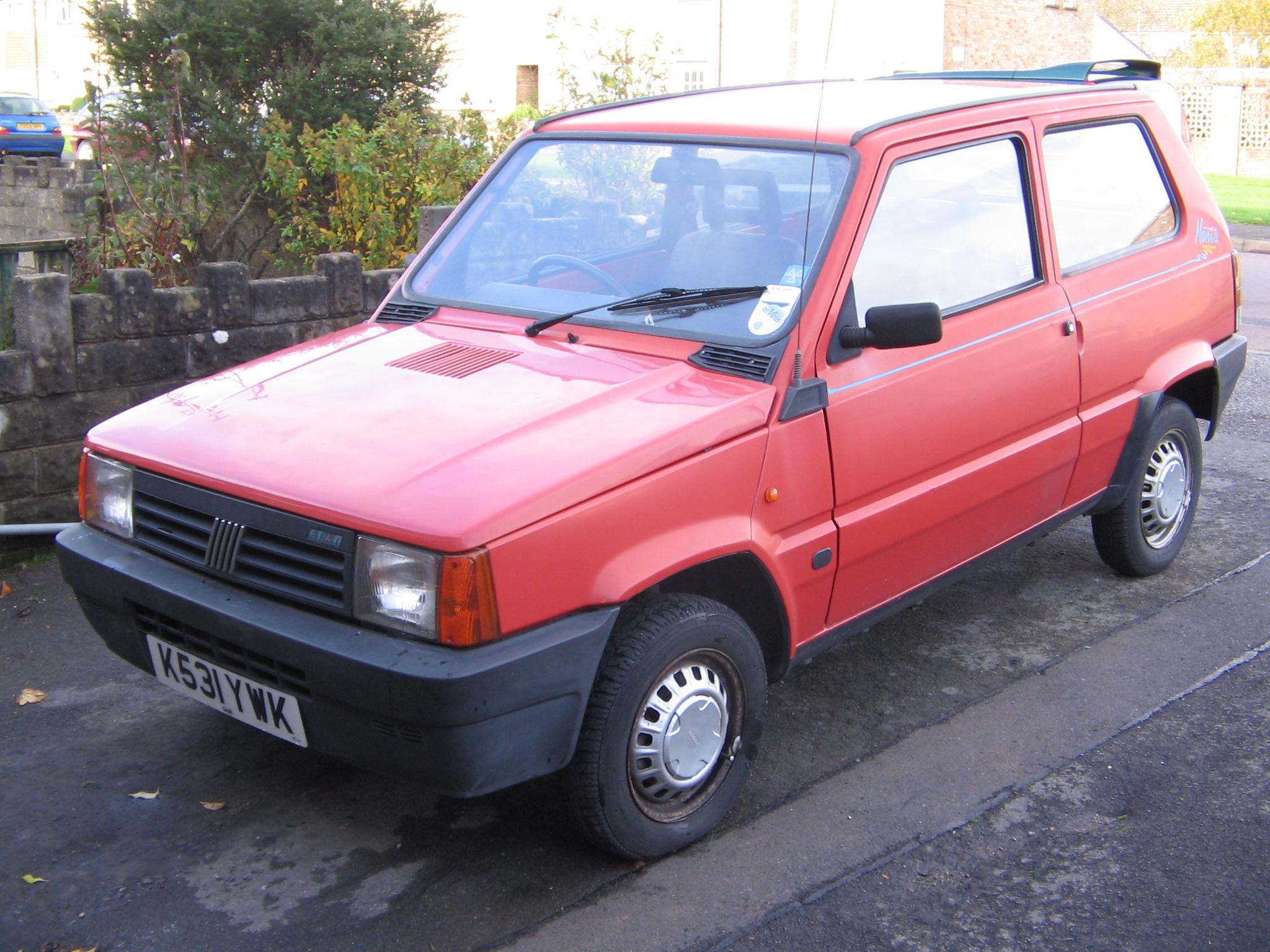

Just so that those in the future don't have to go through the link at the beginning of this thread to see what has been done so far, here is a quick summary, starting with a couple of pictures taken yesterday..............
And one from the first day of purchase.............
£103.00 purchase price.
£ 20.00 fuel for collecting.
£ 31.41 exhaust tailpipe.
£ 80.00 welding.
£ 5.75 4x spark plugs.
£ 2.50.
£ 13.10 4lts semi synthetic oil.
£ 1.99 air freshener.
£ 6.70 hub bearing kit.
£264.45 Total.
Now has 12 months mot and is in use.
