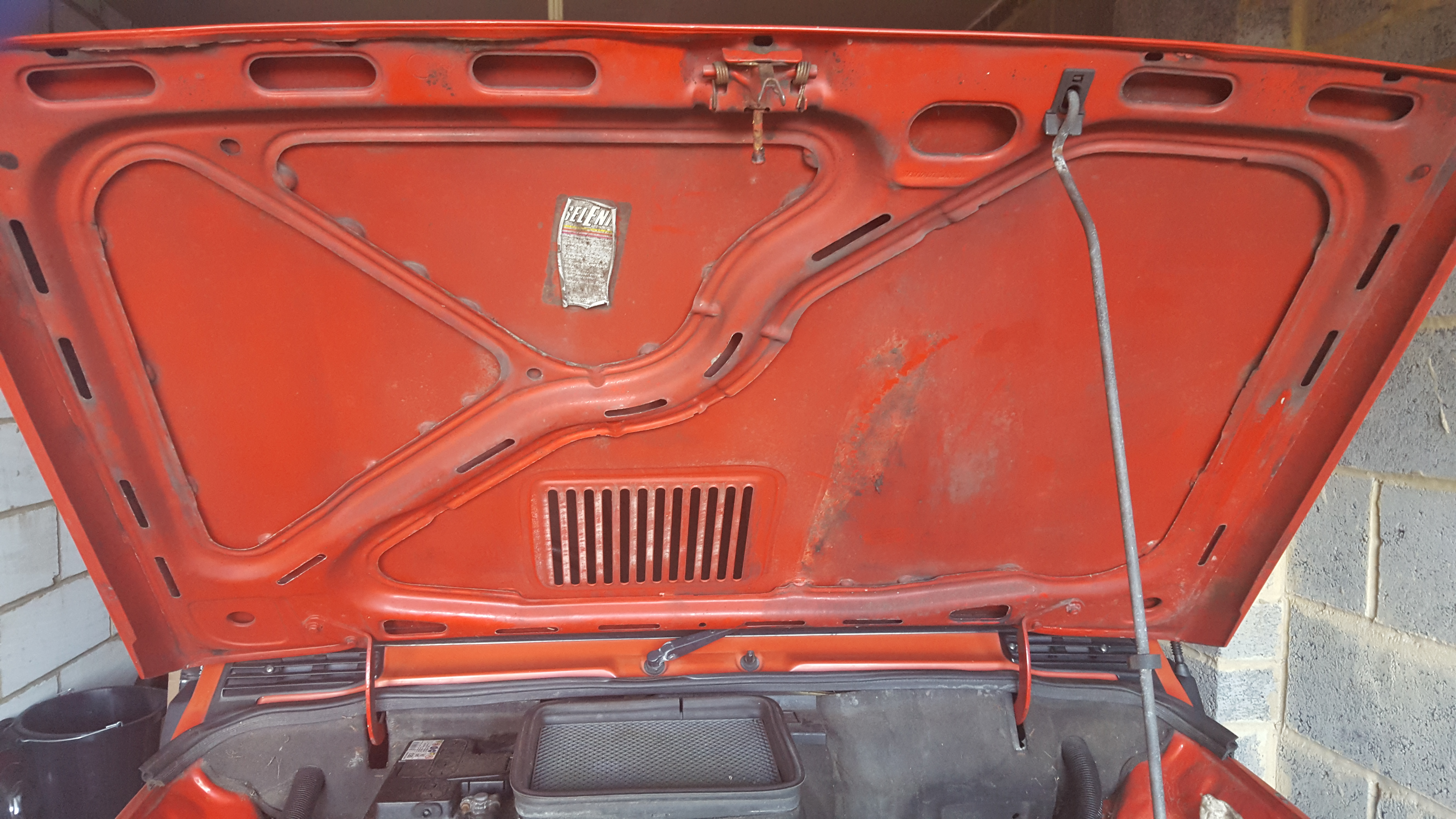

Well as i was out there disconnecting the alfa from the battery charger i thought i would just stick it on Char' now as its a smart charger that maintains batteries as well as charges them...

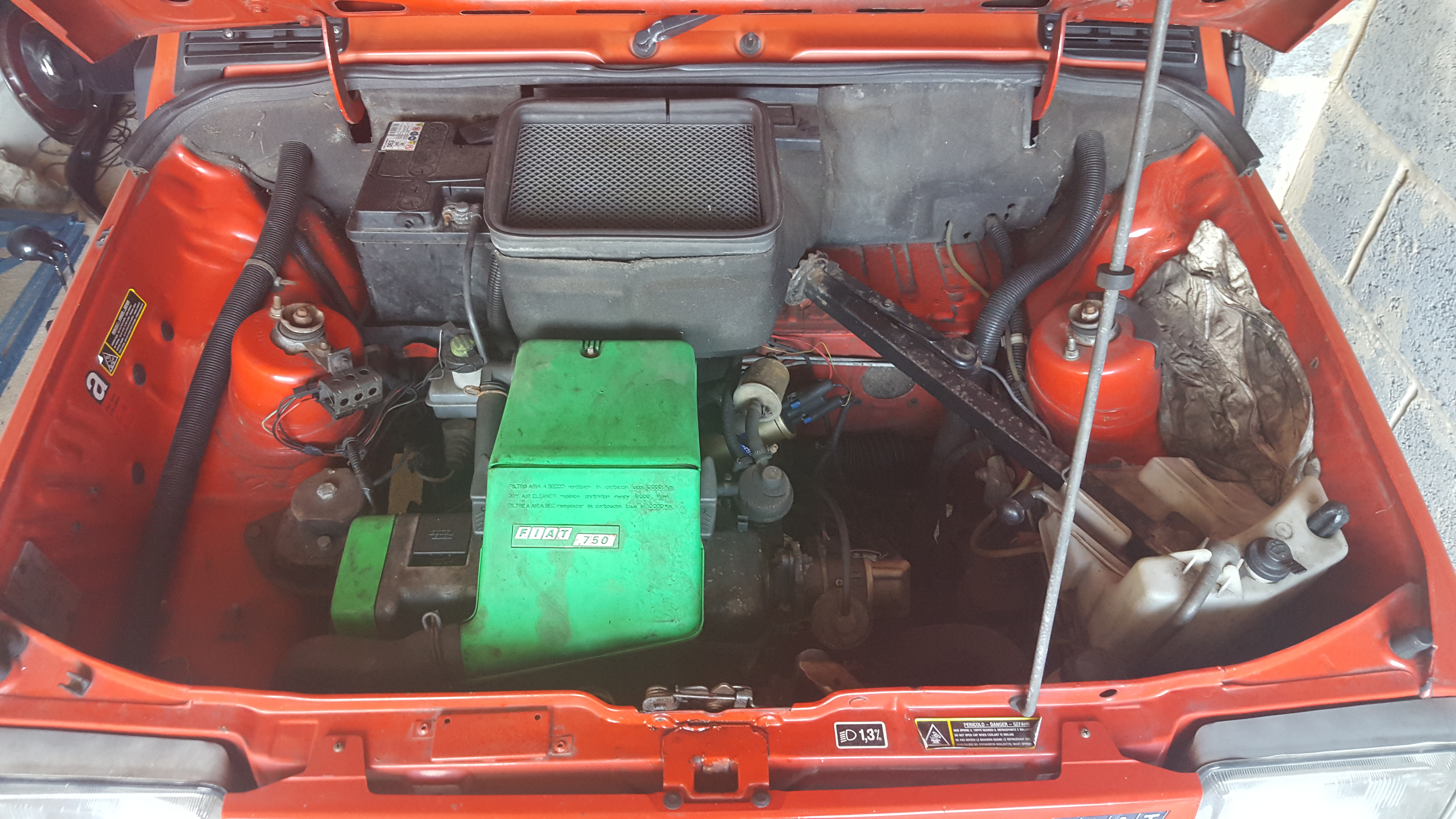

And damn the bay on Char' is dirty - I mean I have never been one for pristine bays or anything but its just plain nasty in there.

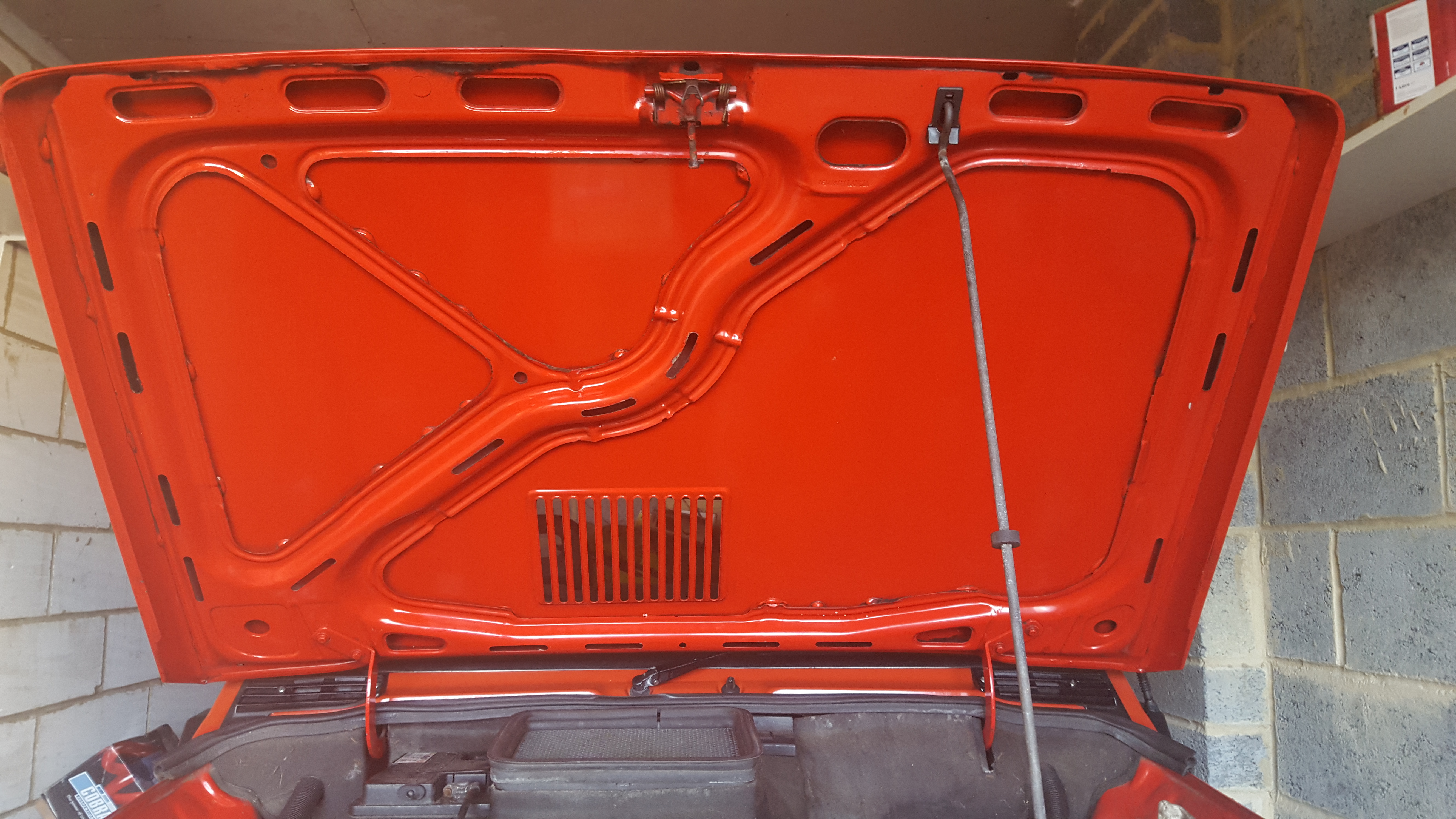

So one thing led to another and I spent several hours cleaning stuff up. Sadly no pics of the bay as it stands as I didn't finish - but the inner wing on drivers side is all shiny, the battery and around it is all clean. Then I took the airbox off and was greeted by the crustiest, oiliest carb ever - so cleaned that up and few bits around it. Went to start on the airbox and my cans of cleaner ran out so had to stop - will get some more ordered and post more pics when i have finished. In the meantime, look how nice the underside of the bonnet came up :D

Wow, I did once clean the engine bay about 6months into ownership then at some point several years ago the cam cover gasket went and leaked oil intermittently for about a year and I'd just top the level up every so often. I replaced the gasket but never cleaned the engine bay since :eek:
Oh looking at that picture reminds me, the dip-dim resistor is unplugged for a reason, it blew up some time ago (literally it erupted smoke) so I left it in place because why not? But I wouldn't go plugging it back in (y)
