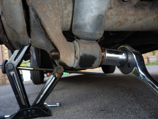

Don't look, only one jack. Thread sticking out to left lowest point.

With the 22m socket and breaker bar, loosten the bottom bolt, I even had to put the jack under the end of the breaker bar to budge it.
Note this bolt is so heavy duty and tight it will resist all the way on the 10 or so turns to remove it.

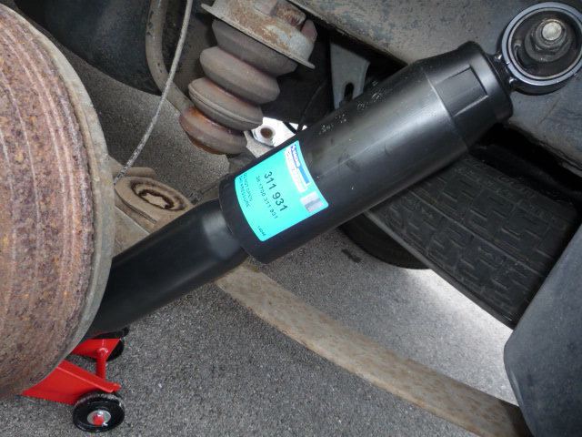

Pump the shock absorber three times to prime.
Fit to the top bolt, do up the nut lightly so the bush can still move freely.
Fitting the lower bolt may well need the axle raised a bit so apply the trolley jack to the axle.
Apply thread lock to the threads and do it up. To do this properly there are torque values, I took a short cut here and just did up the top bolt very tightly like I would do a wheel nut, and the bottom bolt, I did up insanely tightly using the breaker bar, I think the combination of that and the thread lock should do the job. I will check in a weeks time but really I don't think those bolts are going anywhere.
