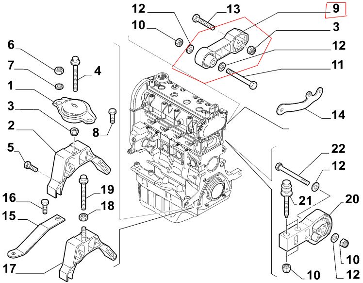

Hi Pete, not done one, but here's a pic of the beastie, looks fairly simple, only 3 bolts (providing you can get to them :eek:)
Its the same as part 20 in the pic (ignore the ringed part, that was mine) --
A bit steep though, £74 inc vat !! yikes - !
I used the 100HP one on my 1.2 and it was only 25 Euros from Fiat.. their pricing is weird.. but....
Hope the piccie helps, the bolts are M12 / 1.25 * 85 (part 21 , 2 of) and part 22 M12 / 1.25 * 90. so should be ok, plenty of meat on them.

Thanks CaptainSlarty - very helpful. The version of ePER on the forum doesn't show the 4x4 bracket that you've shown (only shows the normal support (9 in the drwing) - item 20 looks like what's under my car, so I will go and order that part! Closedr inspection under the car shows the rear diff mounts are giving out too... function of age I suspect
