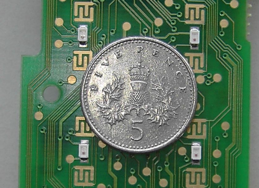

Once you've had some practice soldering your SMDs in, you could do some of these minute ones from the Connect Nav+ front panel. You'd need a pretty steady hand for them. :)

having said that, they are ****ing tiny! i thought that was a 10p!

Thanks for the offer guys but I only posted the picture to show how small these ones are.
