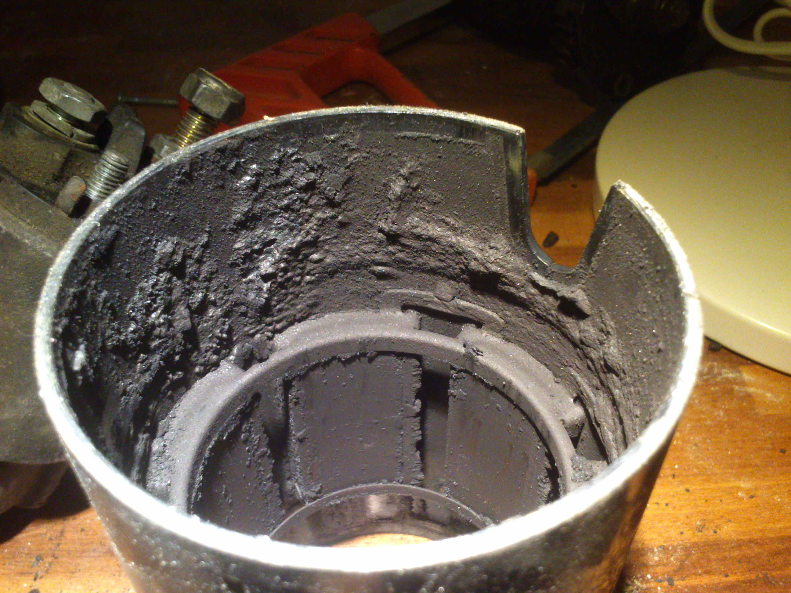

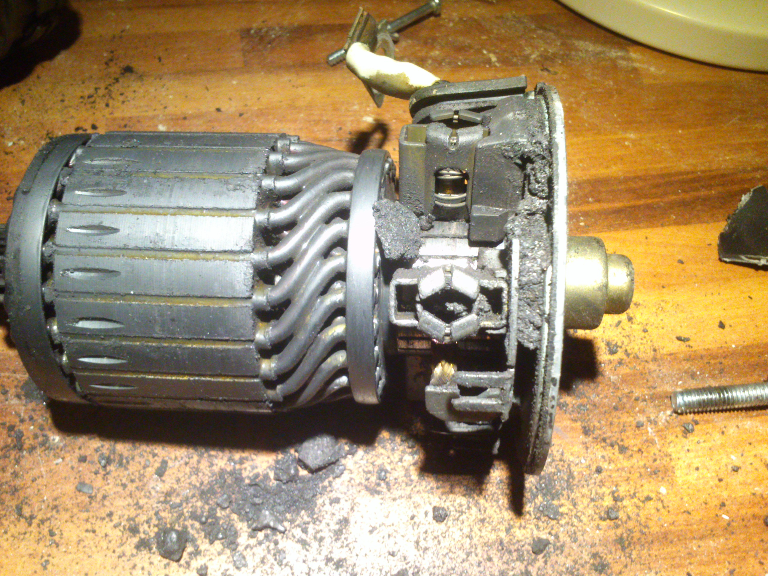

just in case anyone is curious, i opened up the old starter tonight, it seems the brushes are *slightly* worn.
i think a set of carbon brushes and a good clean is all it needs.
Charlie, do you have any suggestions as to how i remove the crud from the stator magnets, i would take a wire brush to it and then blast off the magnetised bits with compressed air, but my compressor is dead, due to (take a guess) worn brushes! :rolleyes:

I have 2 x old jam jars + LIDS with a toothbrush + petrol in ,
1, for the cruddy jobs..
and another for "flush / rinse effect",
my older motors were always full of an oily paste ( oil , carbon, road grime)
several rinses - and an old t-shirt - ..did the job,
with a toothbrush.. you shouldn't scratch any grooves in to cause a short / arc..,
Charlie
