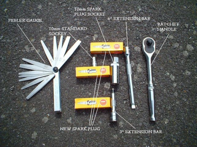

You don't need a massive amount of kit for this job. The thing you might need to aquire is a 10mm Spark Plug socket/wrench. The typre I used was just the socket that attaches to my standard ratchet/extension bar. In addition to the tools in the picture, you'll also need the sppropriate hex-key to remove the battery box, and the socket set to remove the airbox (if present). Also, you'll notice there's only 3 plugs in the pic. I'd already changed 3, and I'd already binned one
