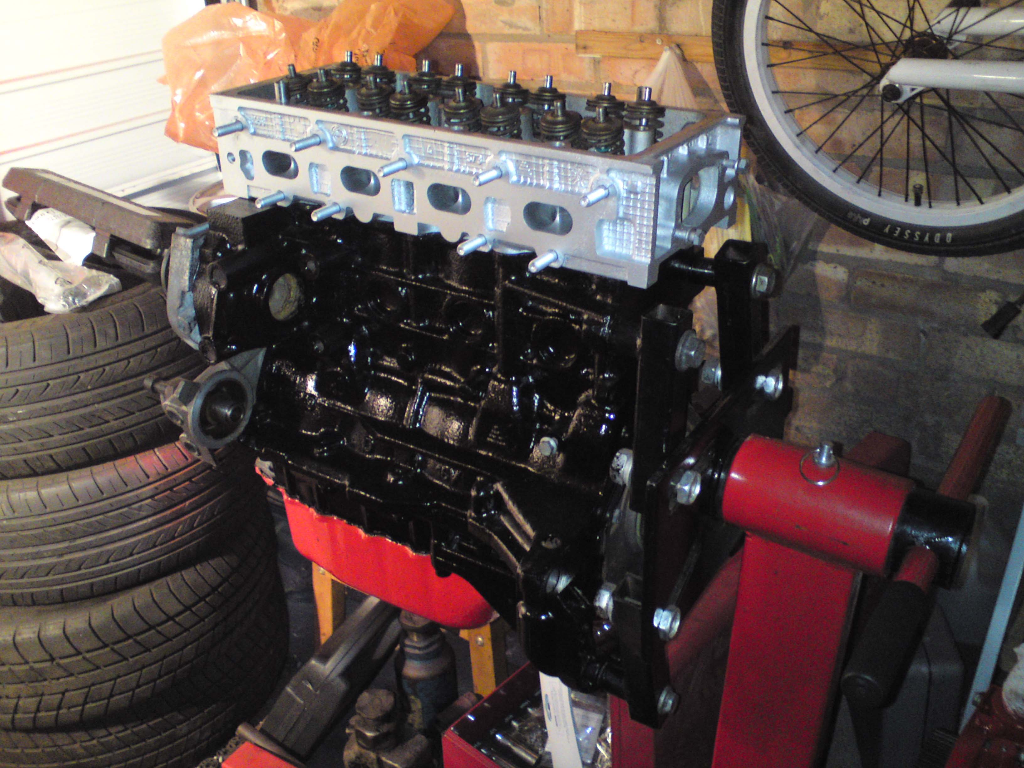

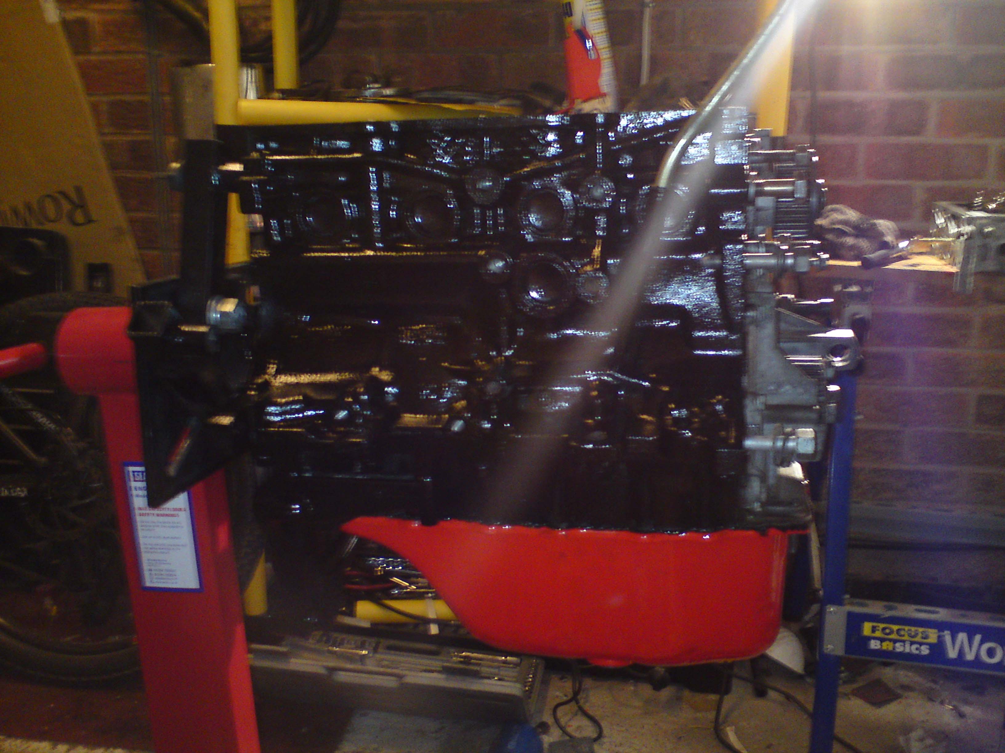

The donor engine was removed from a 2003 fiat stilo 1.2 16v with only 28k on the clock.
I got the engine home, stripped it down and painted it pretty much straight away (getting quite high in the garage during the winter
Re-assembled with pistons soaking on oil for the next several months.

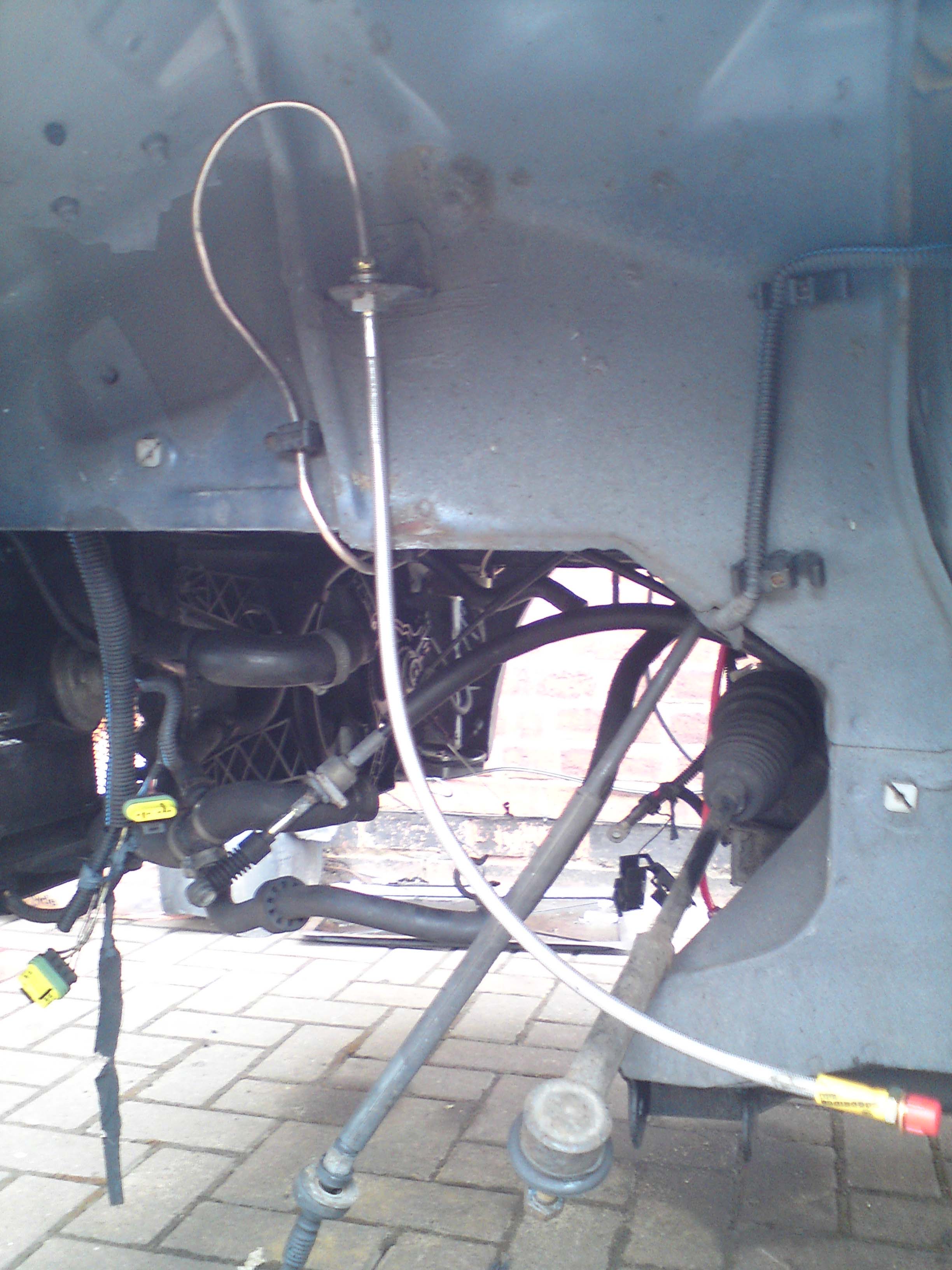

So off came all the brake lines (They were definately on their way out, so it should be on everyones checklist. Please I do advise this), radius arms, rear beam, petrol tank, handbrake cable, wishbones, front uprights, front calipers. I took everything off so that it was just a shell with windows, steering wheel and seats.
Brakelines were all replaced with 3/16 cooper nickel and shiny stainless fittings, finished off with some nice goodridge braided lines.

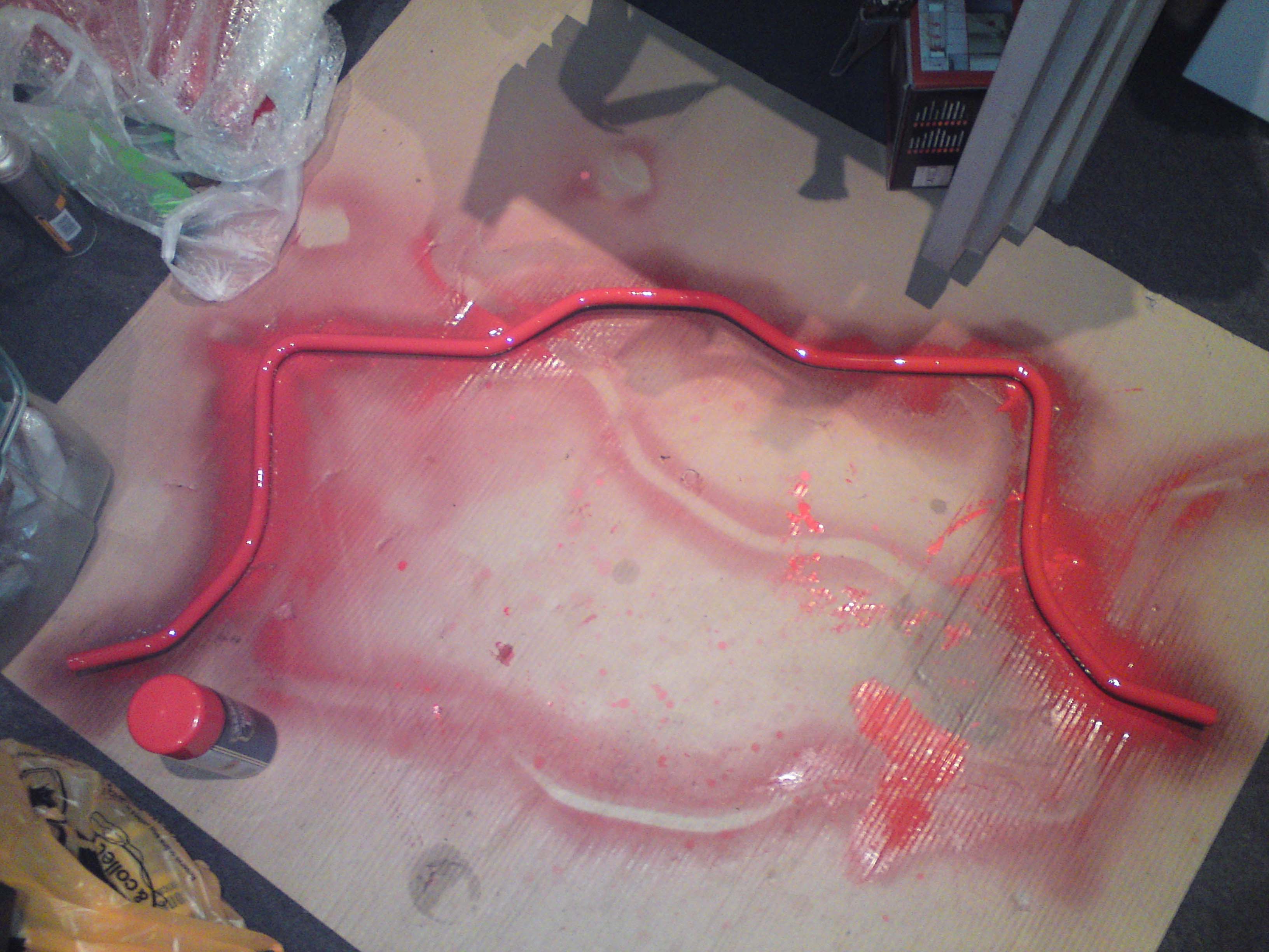

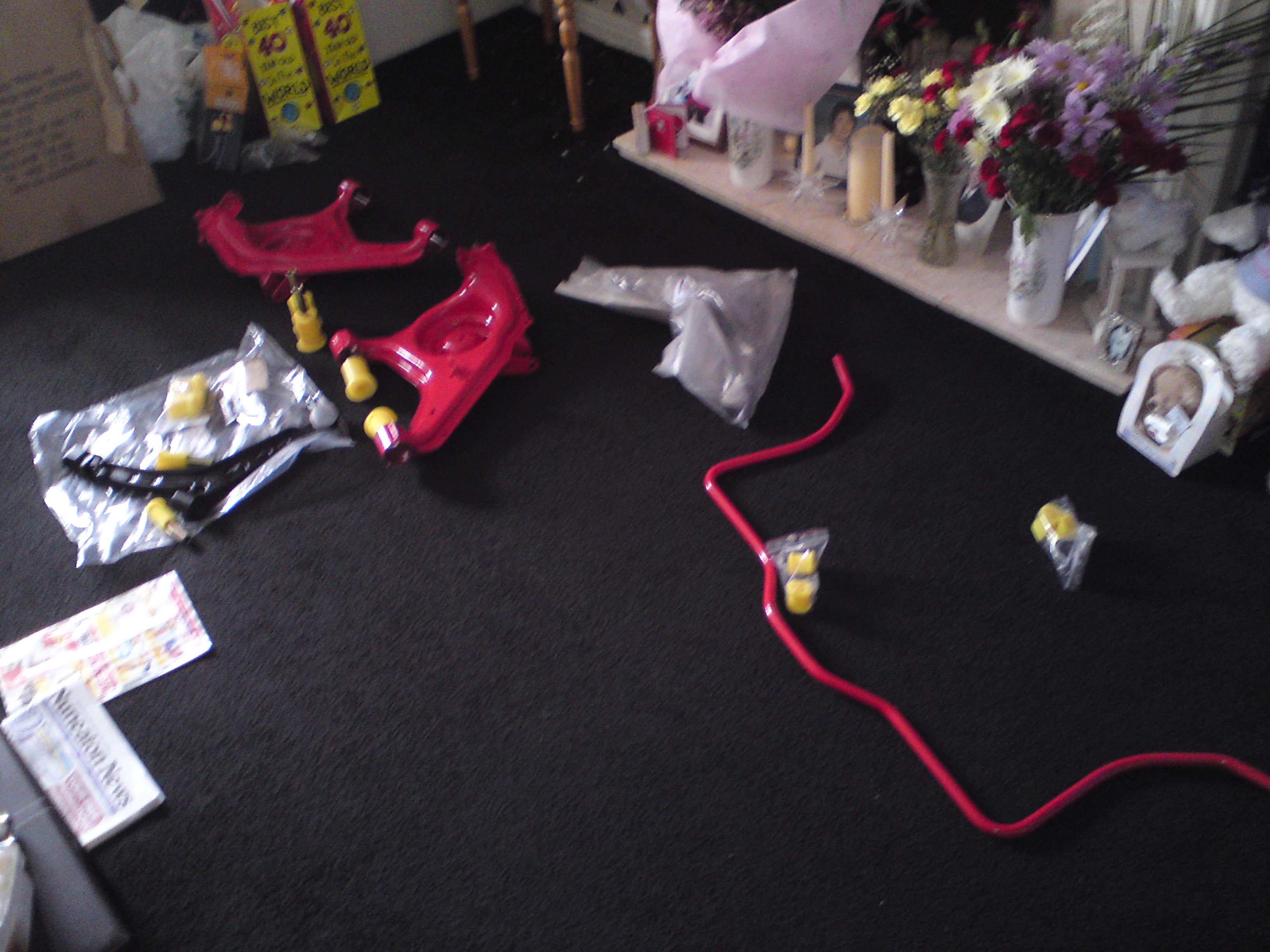

Whilst I was doing the brake lines the radius arms were also being tidied up and painted, along with anti roll bar, uprights, and my front upper strut brace.
Then came a nice delivery of my marea rear calipers to go with my PGT front, they got stripped down and wirebrushed right back to the shiny stuff
. (see the before and after)
Then got a lick of paint again.

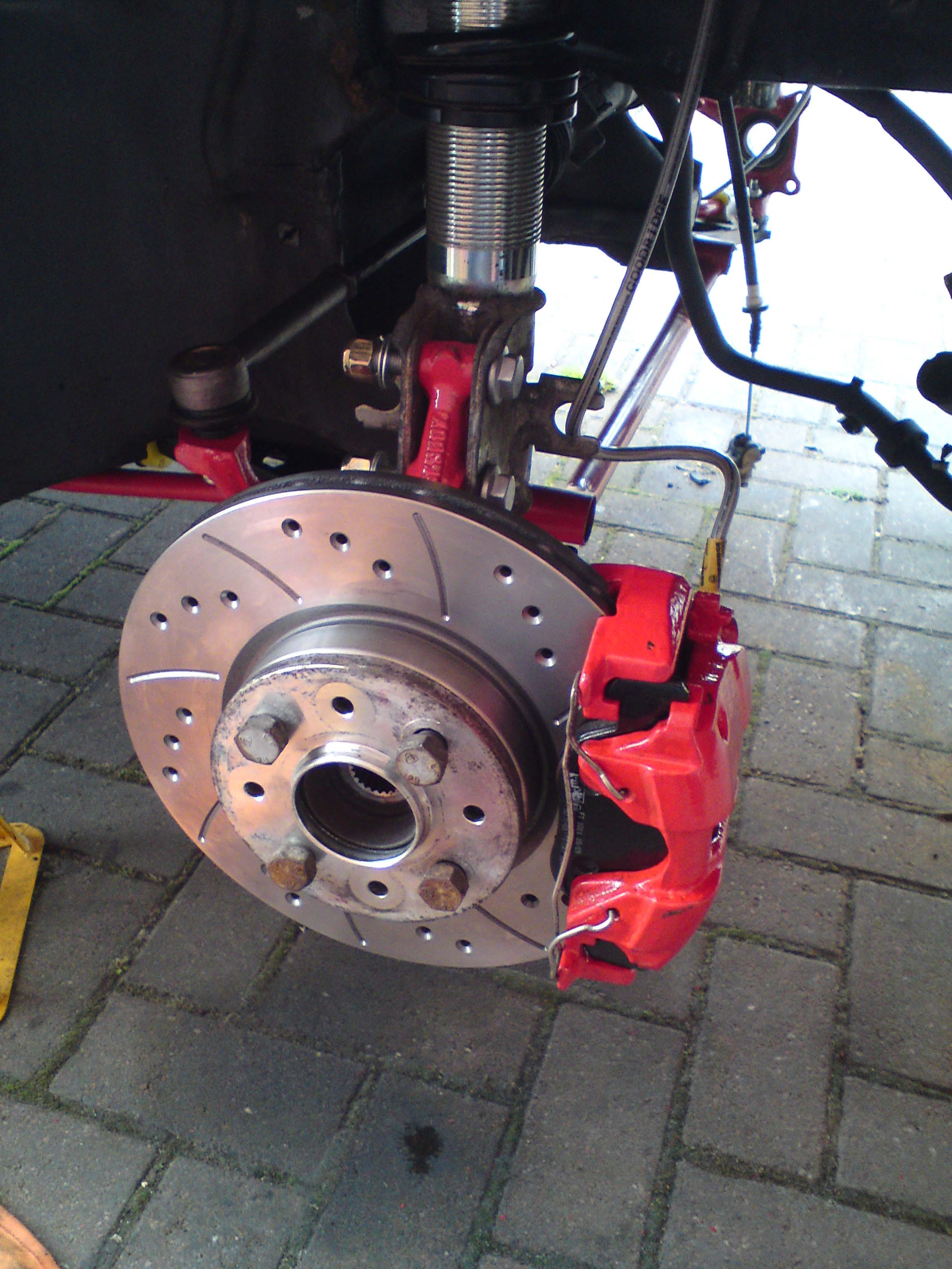

Trial fitted my wheel with the 10mm spacers from the front, Discovred that i'm in need of 15mm at the back due to rubbing on the radius arm :bang:.
And same day I got bored and re-fitted the front too. All finished off by my custom Gaz coilovers on the front, and custom Gaz dampers on the rear (Need a coil chopping out on the rear mind just so the car is nice and level).
The bushes were noticeably stiffer even off the floor, no give or flex in the material at all. I theory with some decent tyres this car should stick to the floor nicely

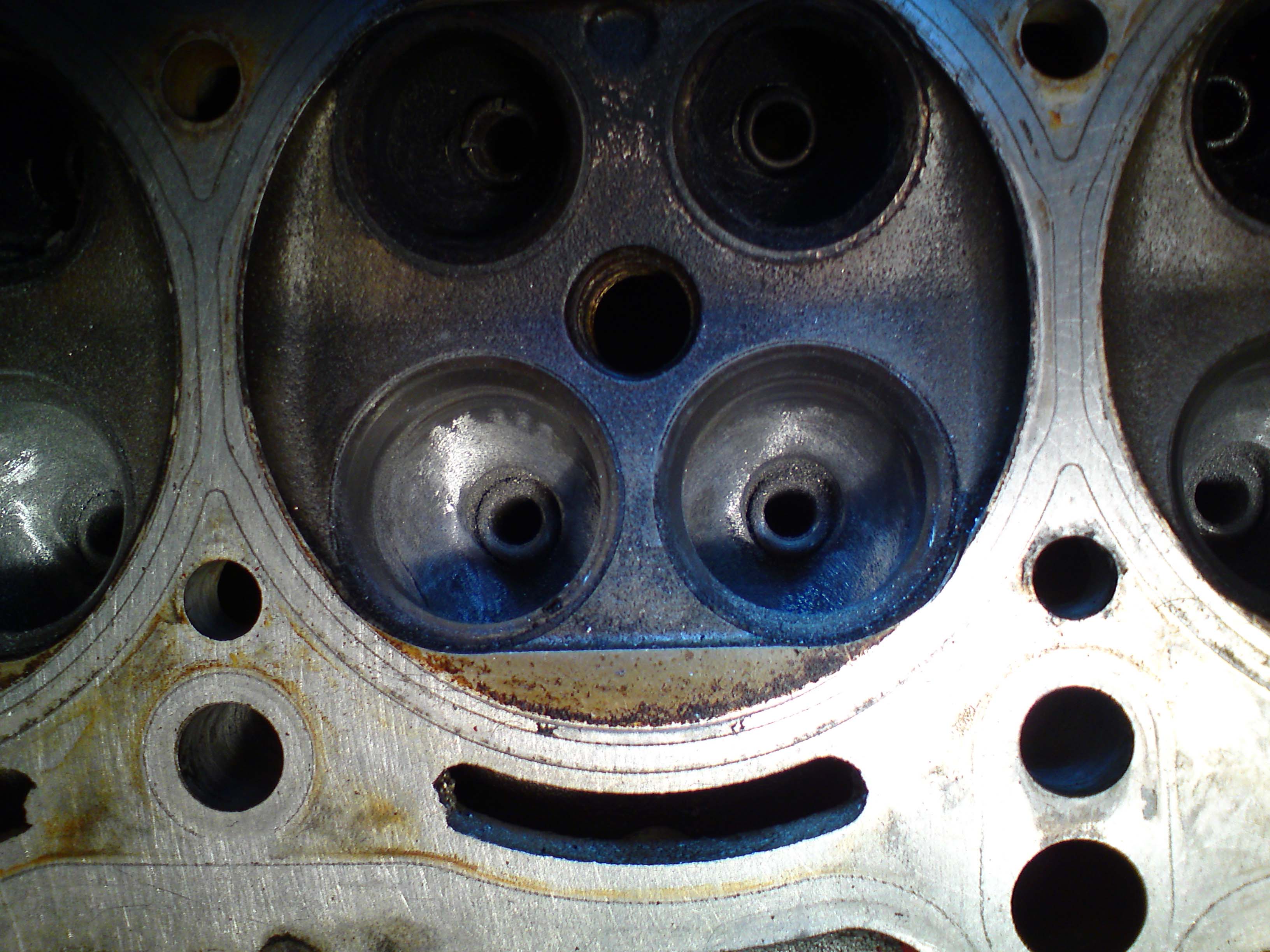

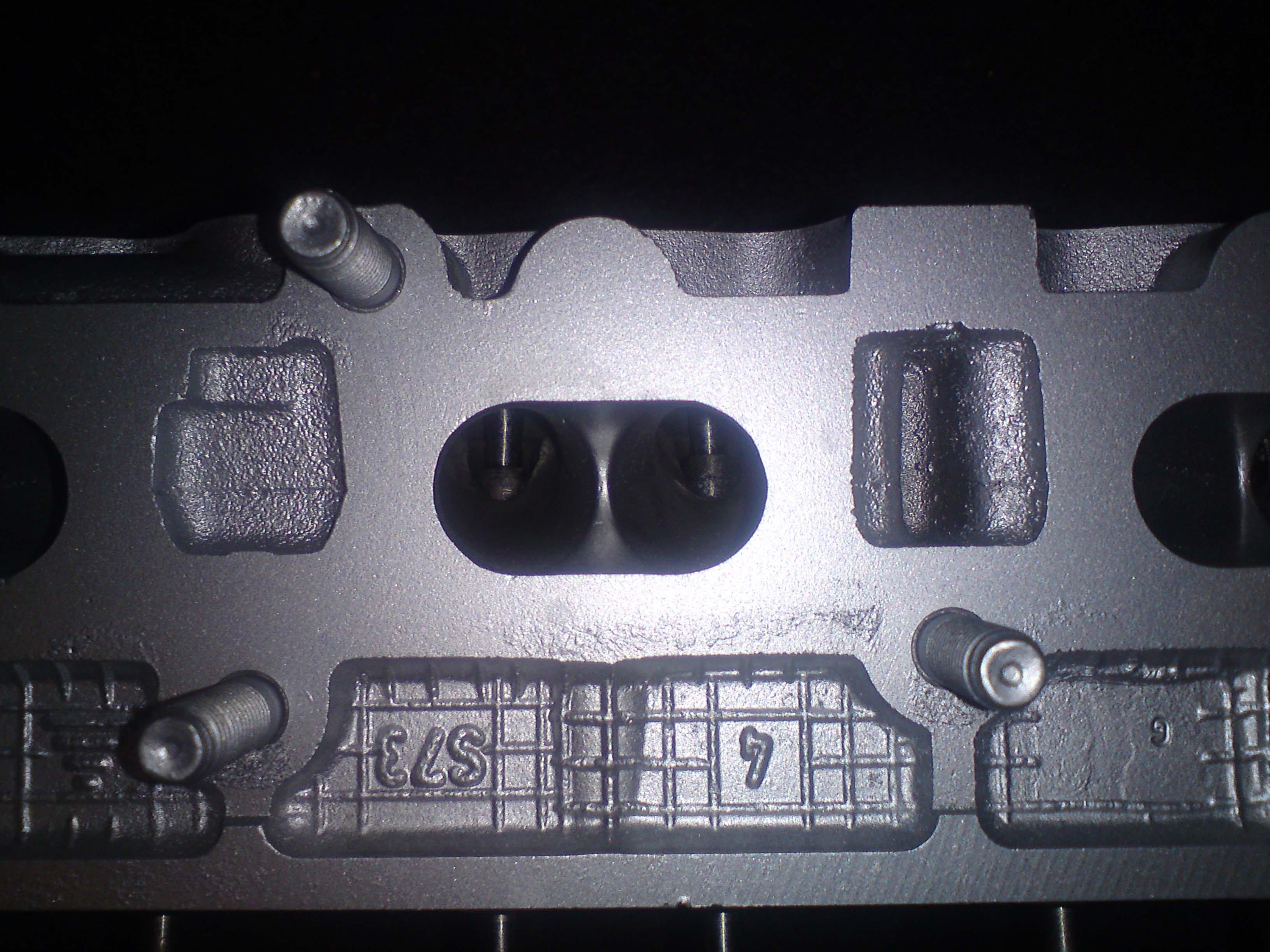

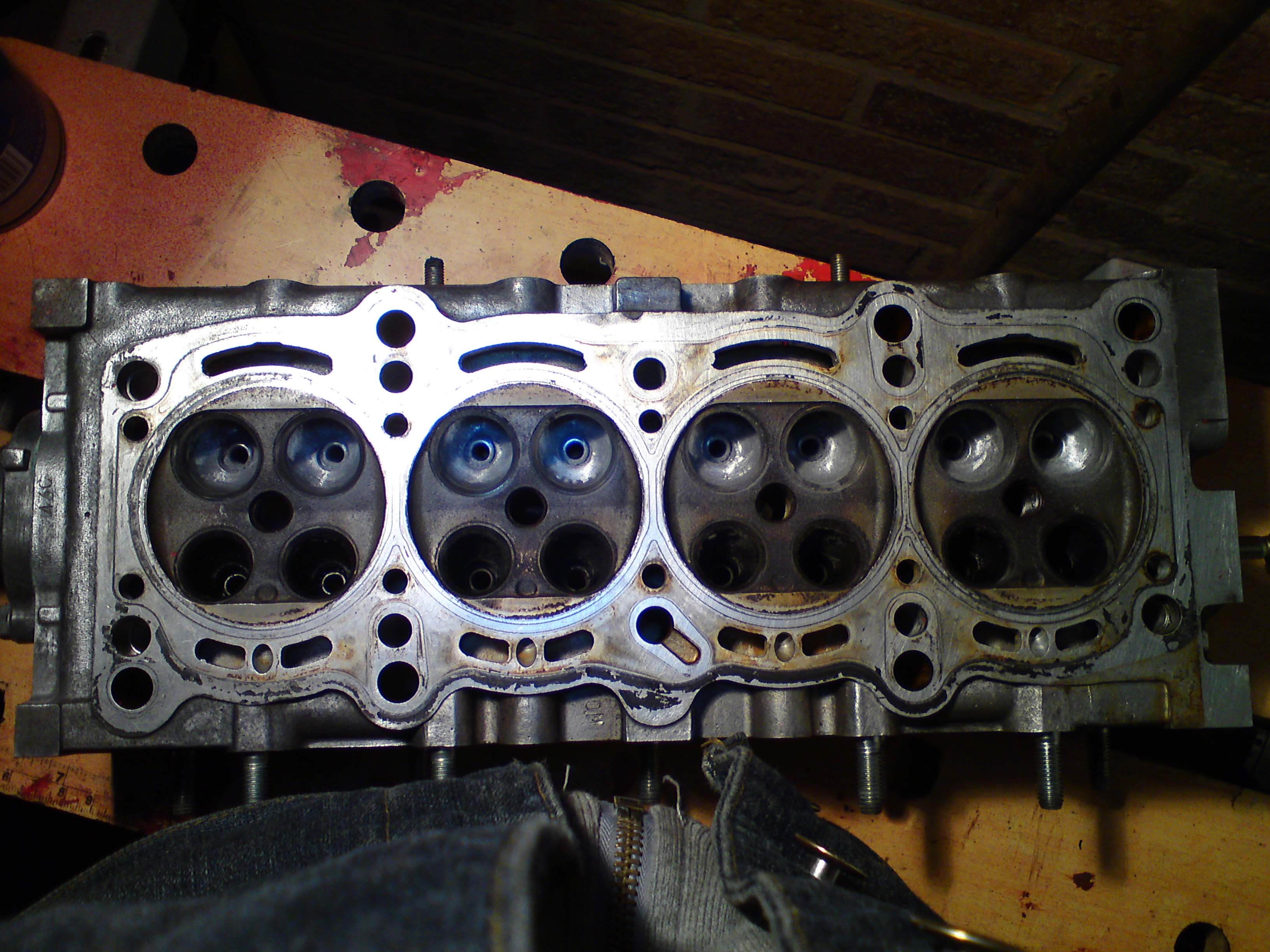

nother payday was coming up so the head got some attention in the form of a dremel, dividers were thinnned down, ridges ground out, drill marks were ground out and smoothed, and to finish off. Hand sanded all off it smooth with good ole 80 grit for the inlet, and outlet was smoothed out finer and spent a few hours polishing till bling bling
Valve hole on the right shows what it was before grinding, left shows part way through grinding.
Never got any photo's from that night of finishing it off but It will improve flow no end (I hope

Inlet:
Exhaust:

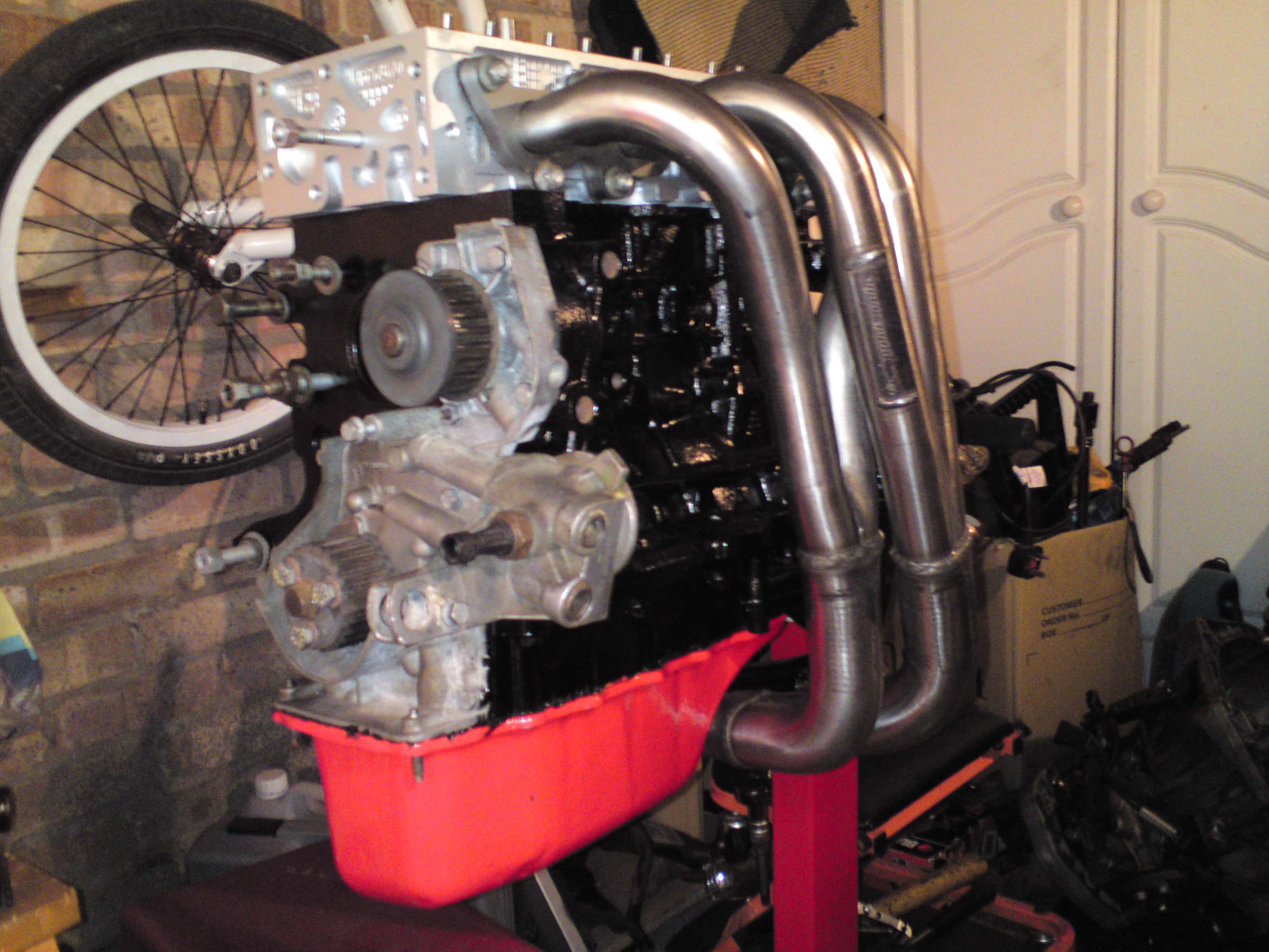

Then began painting my head and fitted it next day along with water pump pipe from the old engine (new seal, again advise checking quite oftenly).
Timed up and ready to go in

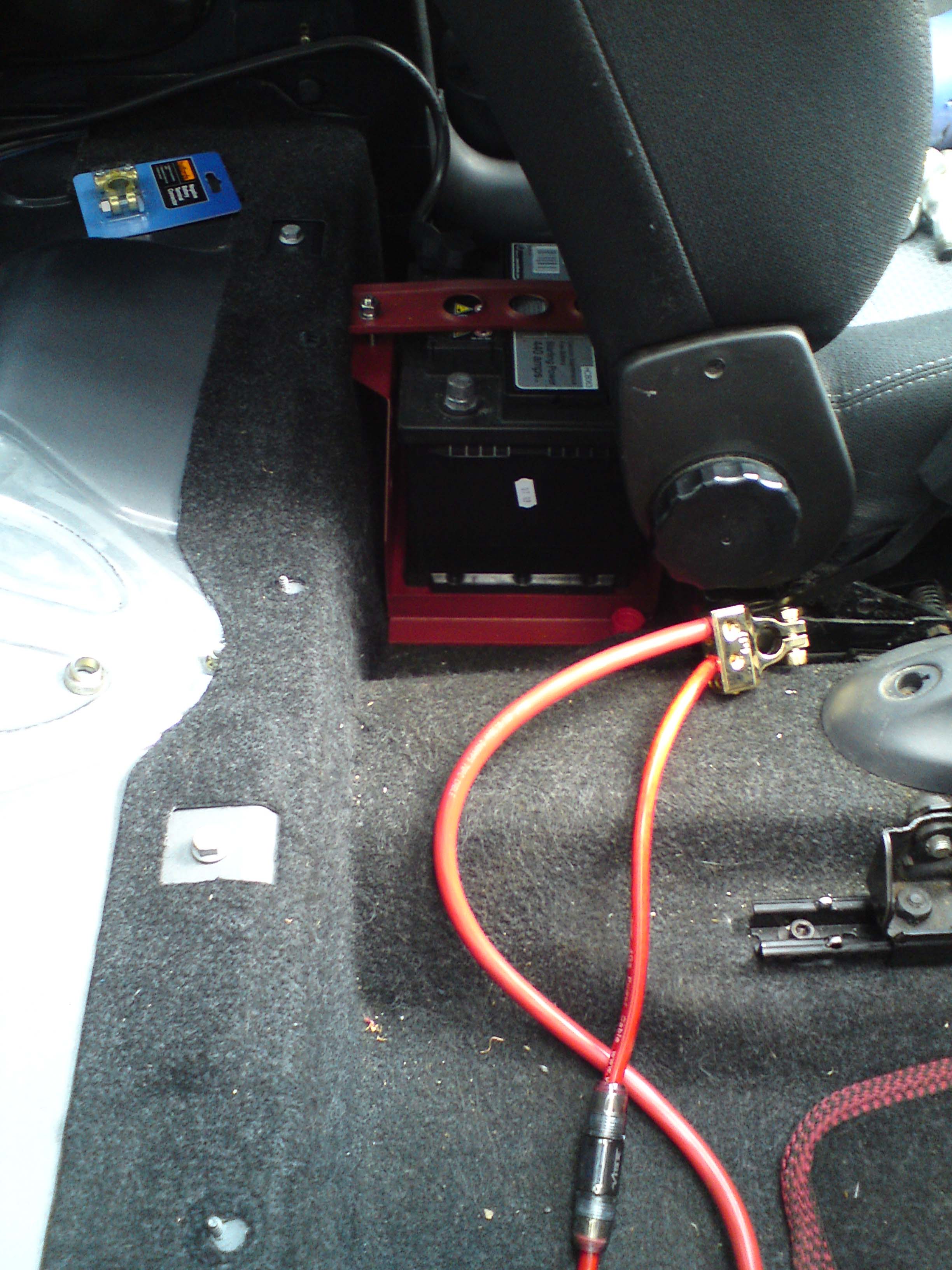

Ohh before I forget, here some pic's of the new wiring for the battery, starter, and alternator:
Hint, it's the big thick one without the fuse on it
