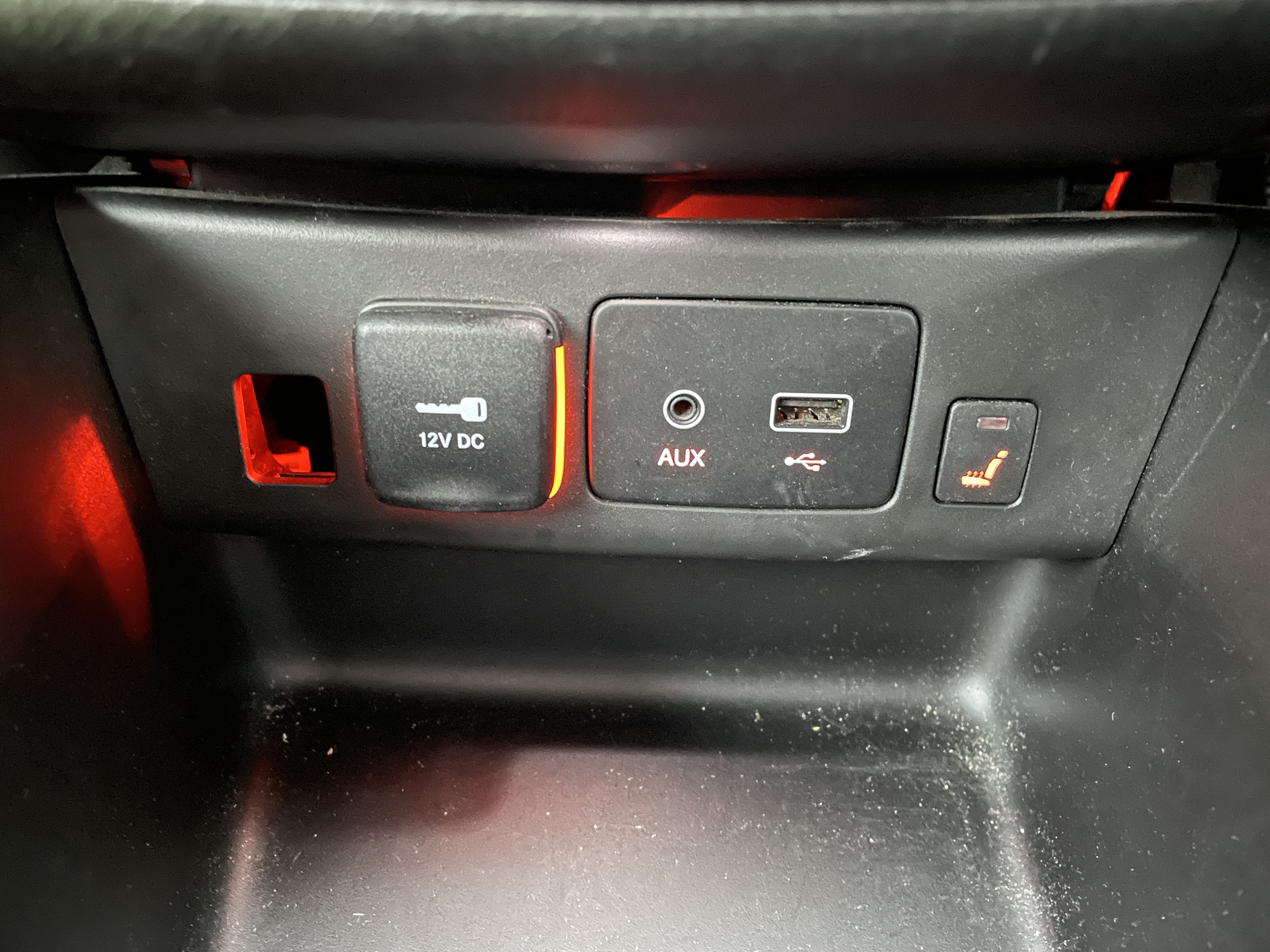

Hi folks. Does anyone have a guide for removing this panel in the centre console?
One of the heated seat buttons has popped inside, and I need to get it back.

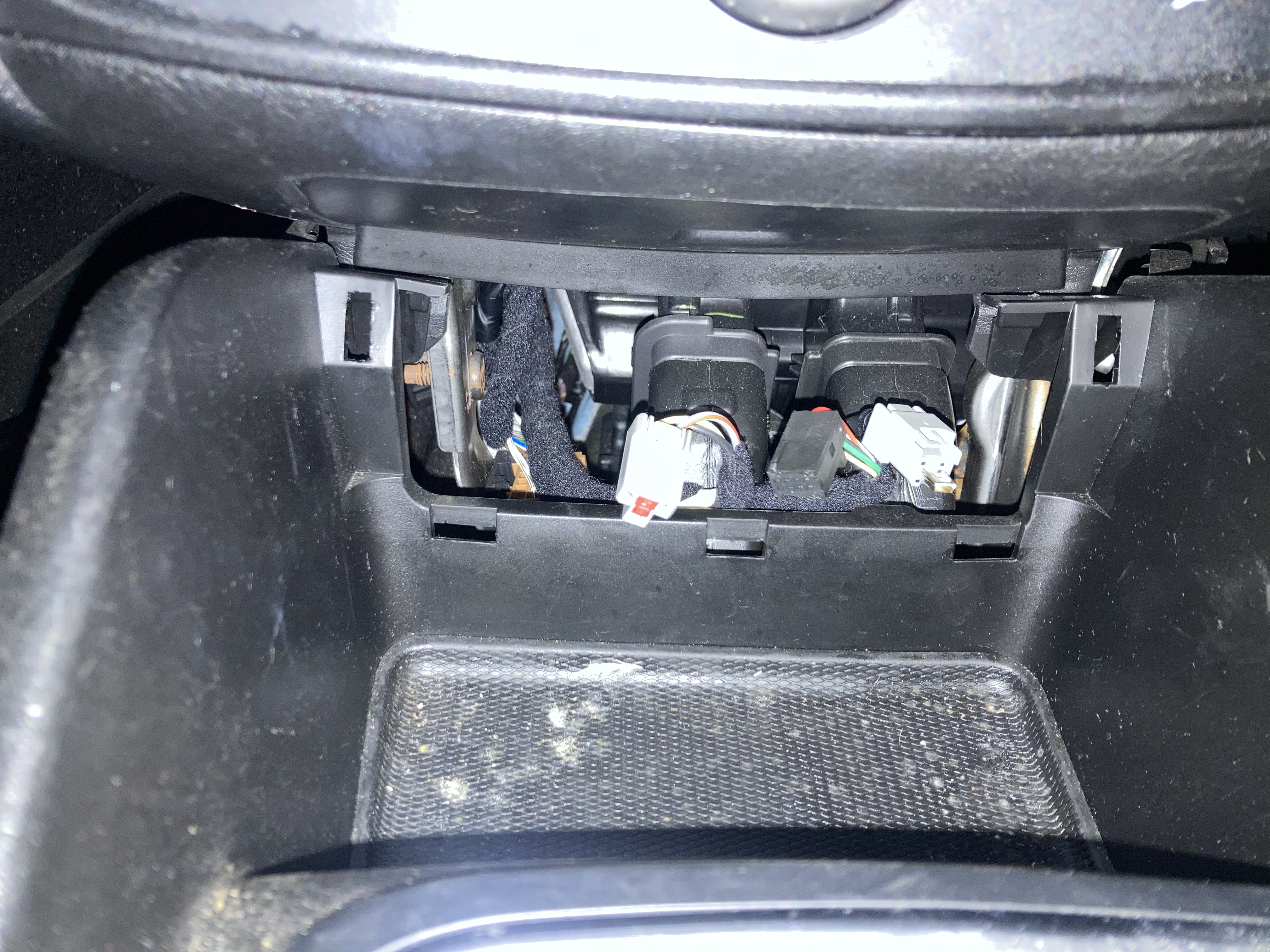

It’s just clipped in with three plastic tabs at the bottom edge and two spring clips at the top corners. If you can squeeze your fingers in the gap at the top and place your thumbs on the bottom edge. Give it a squeeze to release the lower tabs and give it a tug
This ones missing the bottom left tab but gives you an idea how it’s held in
