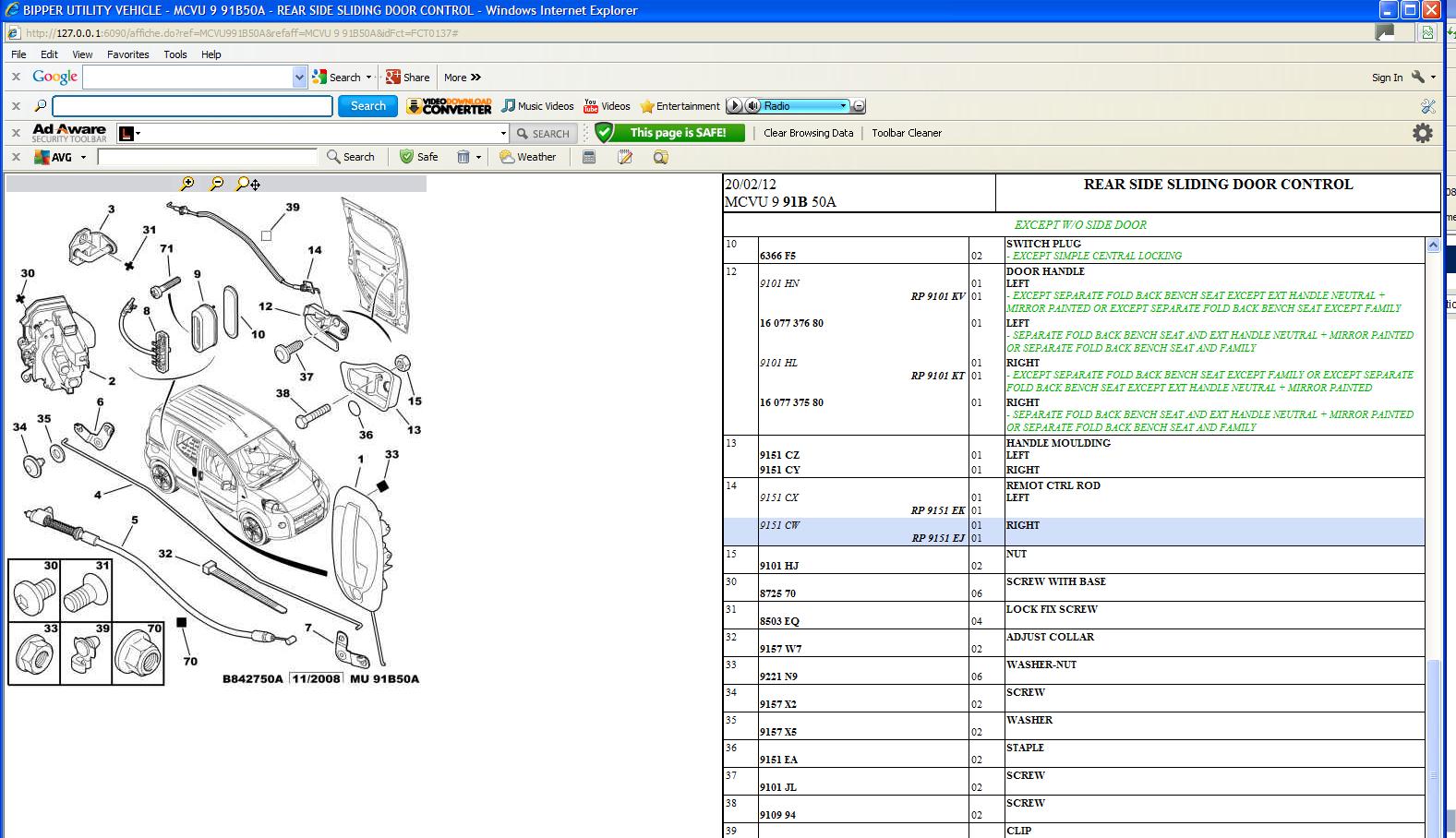

Hi,
I don't know if this helps but it does show (on a Bipper which is pretty much what we have only not as good :cool: ) that internal door releases are a unit that's fittable to the sliding door.
It maybe that you have to change the door card to accommodate the release unit or perhaps there's a press out in the metalwork to fit it to..I've not been to look although I did think only this morning 'is there an internal release on my sliding door?' and I looked to see from the driver's seat but wasn't seeing one! I've got the door card off at the moment (sliding slam-contact issue from a month or so back) and it was only when I was working in the rear once, I thought I'd better leave one door open in case I got shut in. I did find though that there is an internal release on the back door so I wouldn't have been trapped. (I've left the door card off as I want to put soundproofing in there before I replace it.)

Rear sliding doors on the Qubo are the same as shown above on the Bipper. The release handles fit into a pressed shaped aperture in the door above the card, so I doubt they would retro-fit easily. All four doors and the tailgate lock operate on the central locking system and although possibly catered for in the harness, you would need all the hardware to make it work. You could fit one Qubo/Nemo/Tepee sliding door and operate it manually. It locks like the front doors by pushing the handle in.
