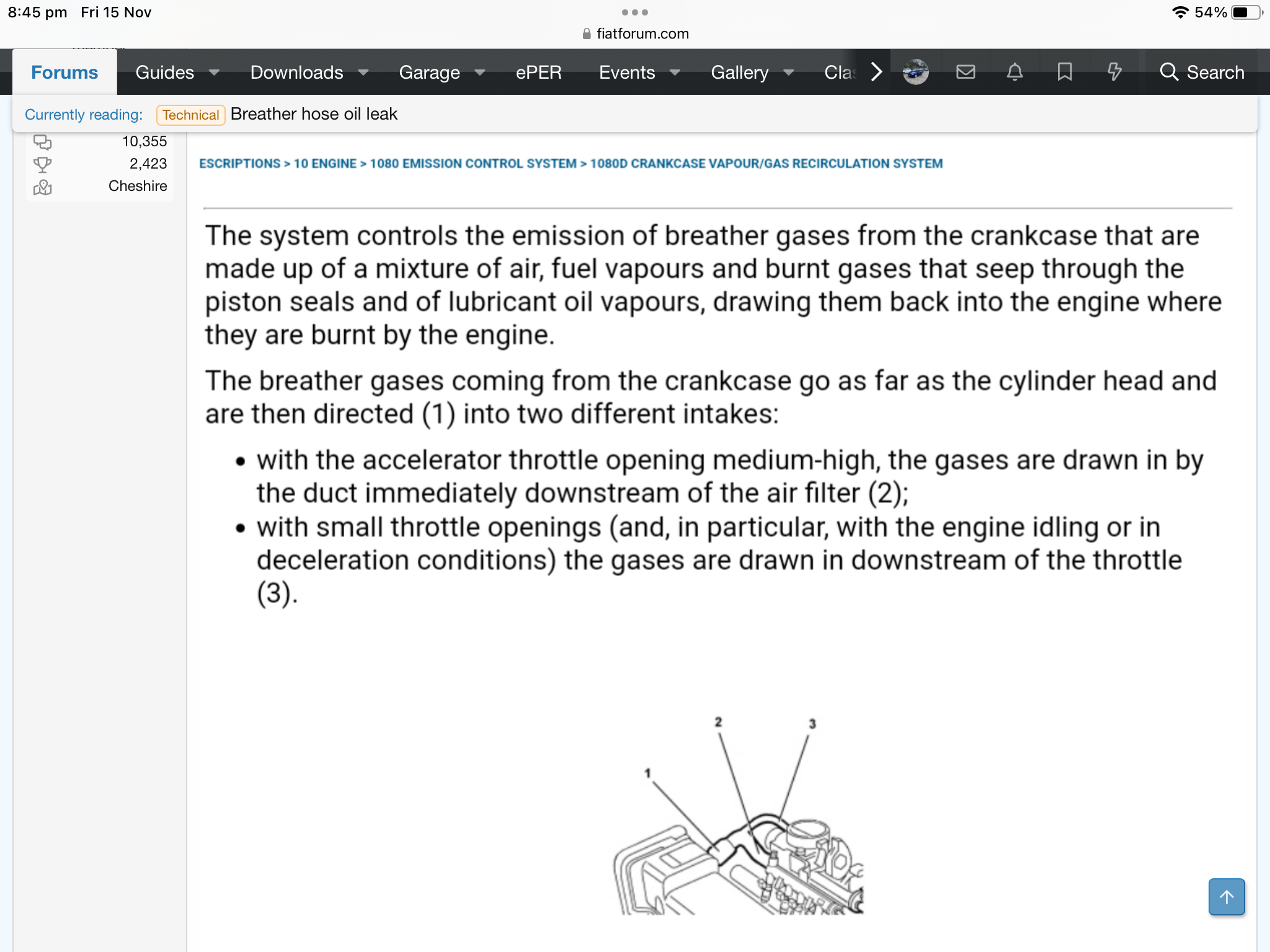

There's 5 holes that run from top to bottom of the engine, all the oil and air is open to the atmosphere, it's not a sealed system , it's more like a sauspan, a byproduct of combustion is water You often see it dripping out of the exhaust and / or steam exiting the exhaust

Engine gets hot, air inside it expands, hot air is able to hold more moisture than cold air.
Stop the car, the air inside the engine contracts as it gets colder again, as it contracts more air is pulled into the engine which also contains moisture.
Cold air is not able to contain as much moisture as warm air and as a result the moisture condenses out on the inside of the engine and runs down into the oil. You start the car the crack whips it up into a nice emulsion of oil and water. As it heats up again the water starts to evaporate into the crank case air again, and is pushed out of the breather as the air expands again.
If you think an engine is a “sealed” system then look what happens when a car turns over.
It’s only sealed in the context of oil not pouring out of the bottom, the top is not sealed.
