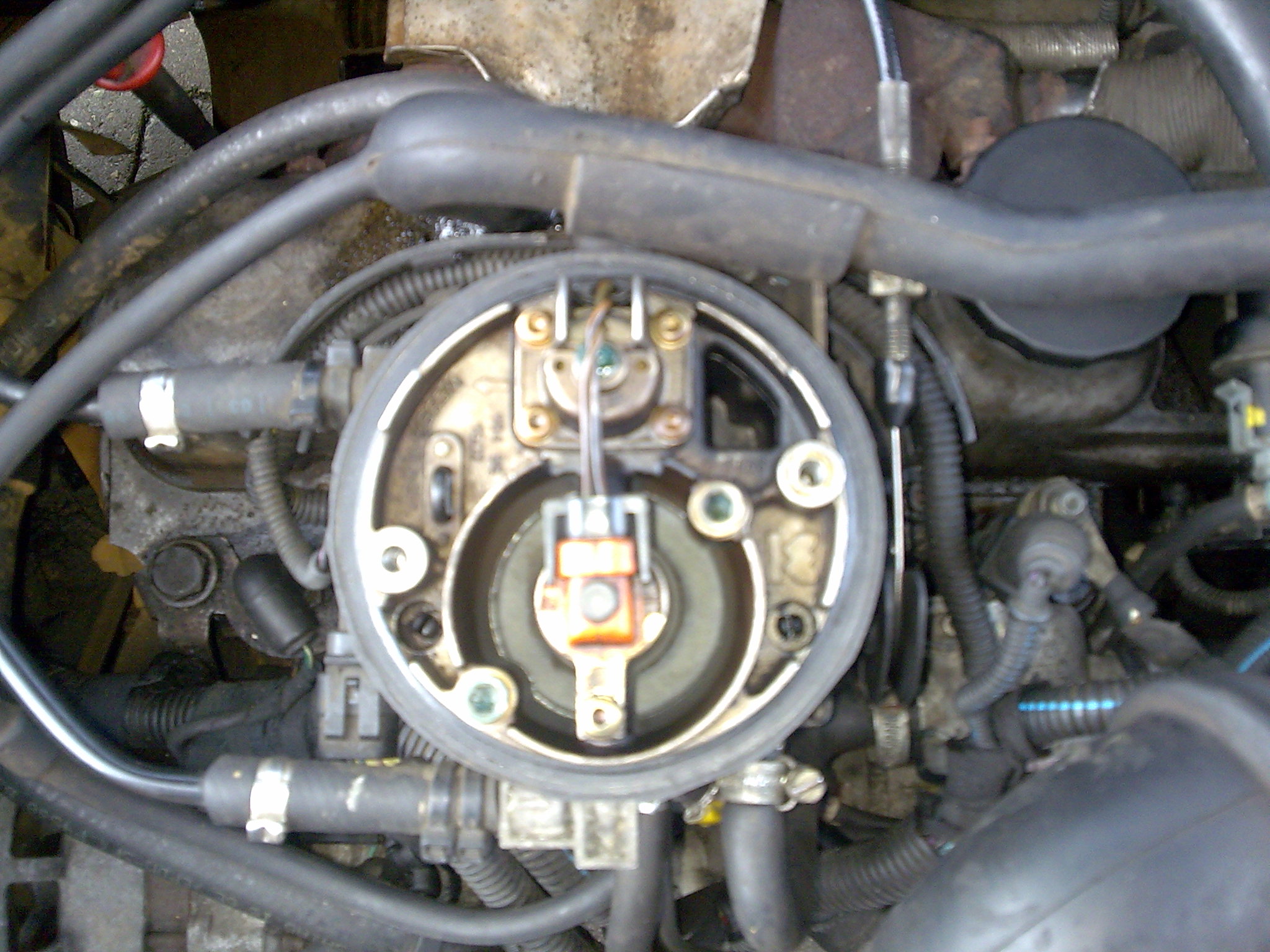

picture of inector to help identify the bits on it!

CHECk the coolant temp sensor. It should be light blue, two pins on the plug and its in the thermostat housing on that engine i think.
Also check the inlet air temp sensor. It is in that picture you have taken. Small bead with two wires into it. It's in the air flow and is connected from underneath the spi unit
