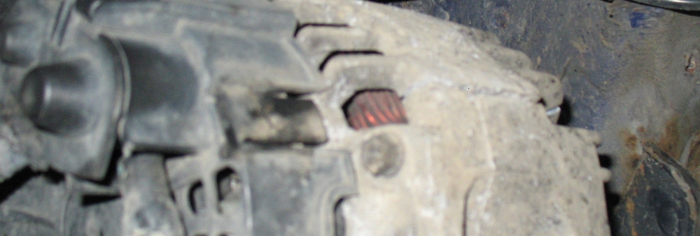

The first one has a crack across the middle from pulley front to back. Is that what you mean? I haven't yet got under my son's because my axle stands and jacks are under mine
Thanks. That is like mine. It may have the more typical ones as well!

I wonder if this is all related to a crank pulley that is failing or has failed at some time in the past? All of these cracks look like fatigue failures to me. If the crank pulley gives up and leads to the bag 'o' spanners rattling that we're all familiar with, it's not going to be doing the alternator any favours.
