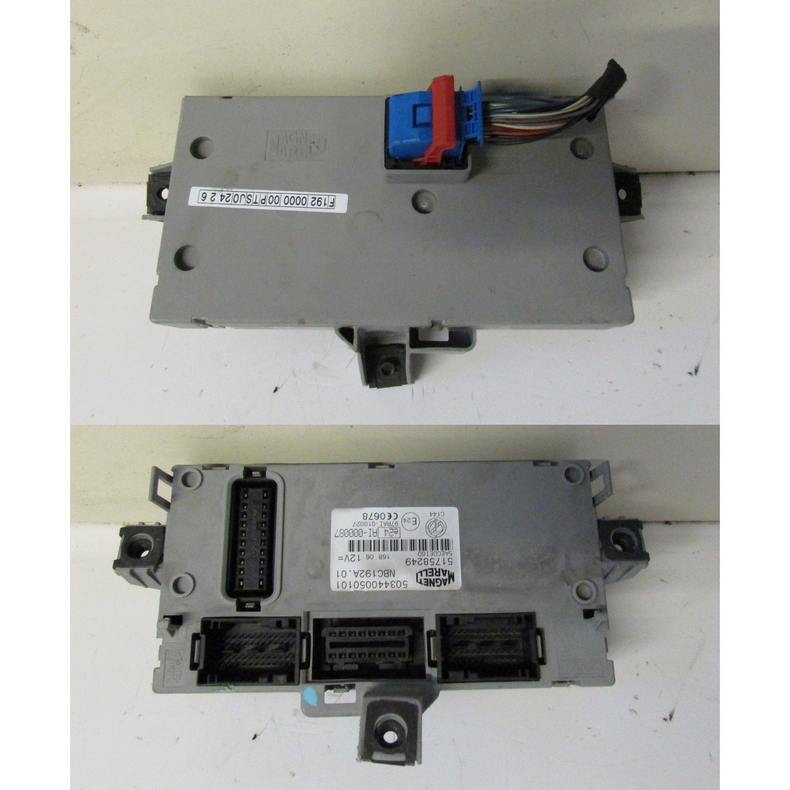

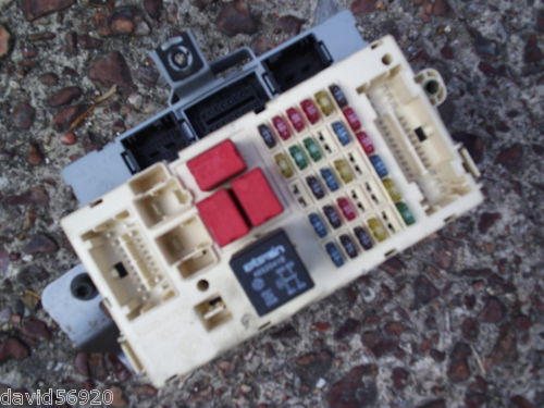

It would only need programming if the body computer was changed. The body computer can be separated from the dashboard fuse box and fitted to a replacement fuse box, so would not need programming in this scenario.
