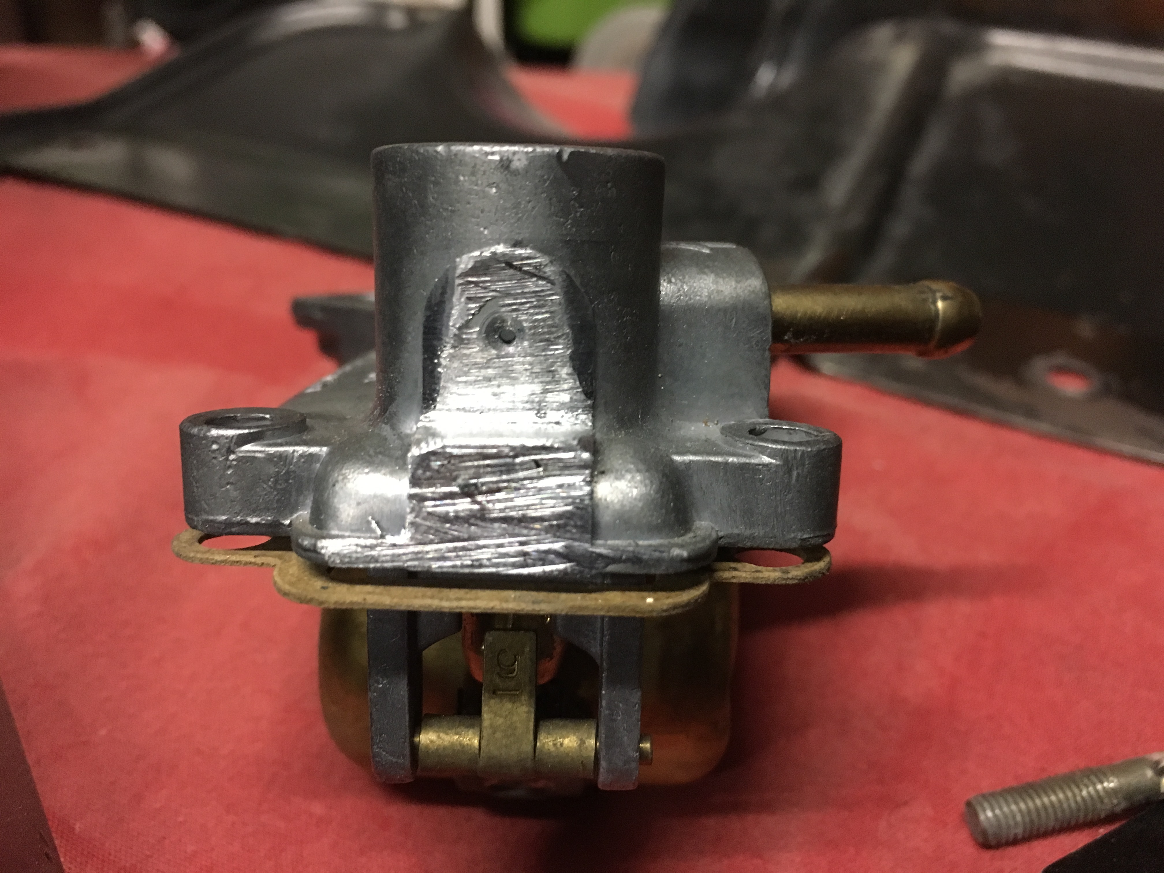

About two years ago. Before all this talk about the cooling effects of the fuel return line, I decided to cut off the brass fitting so I could block up the tiny little return hole with a small bolt tapped into the hole and loctited in.
Has anyone done this with success or do you think I’ve destroyed the top of a perfectly good carby?
I was aiming for a neat solution that didn’t require extra plumbing.

I will keep going with the idea of tapping the hole and inserting a bolt. Once it’s done I will Use an electric fuel
Pump to check for leaks and report back.

Here is the tiny little hole of that needs blocking off. Has anyone ever used lead solder or similar to block a hole in a carby?
The drilled holes for jet passages are blocked with something that appears to be jammed in the holes.
Would fuel tank repair handle the heat of the engine bay?
Any thoughts?

If you are going to go down the route of blocking the 'return' outlet on the carb's top-plate, I would have thought that the best material to use would be "J-B Weld". This is a 2-part epoxy metal, which is resistant to most things. My old marine engine had part of one of the barrels repaired with this stuff about 15 years ago--it is still water-tight and regularly is at 140-160F. It does, of course, have a MUCH higher working temp than that, and is impervious to petrol.
