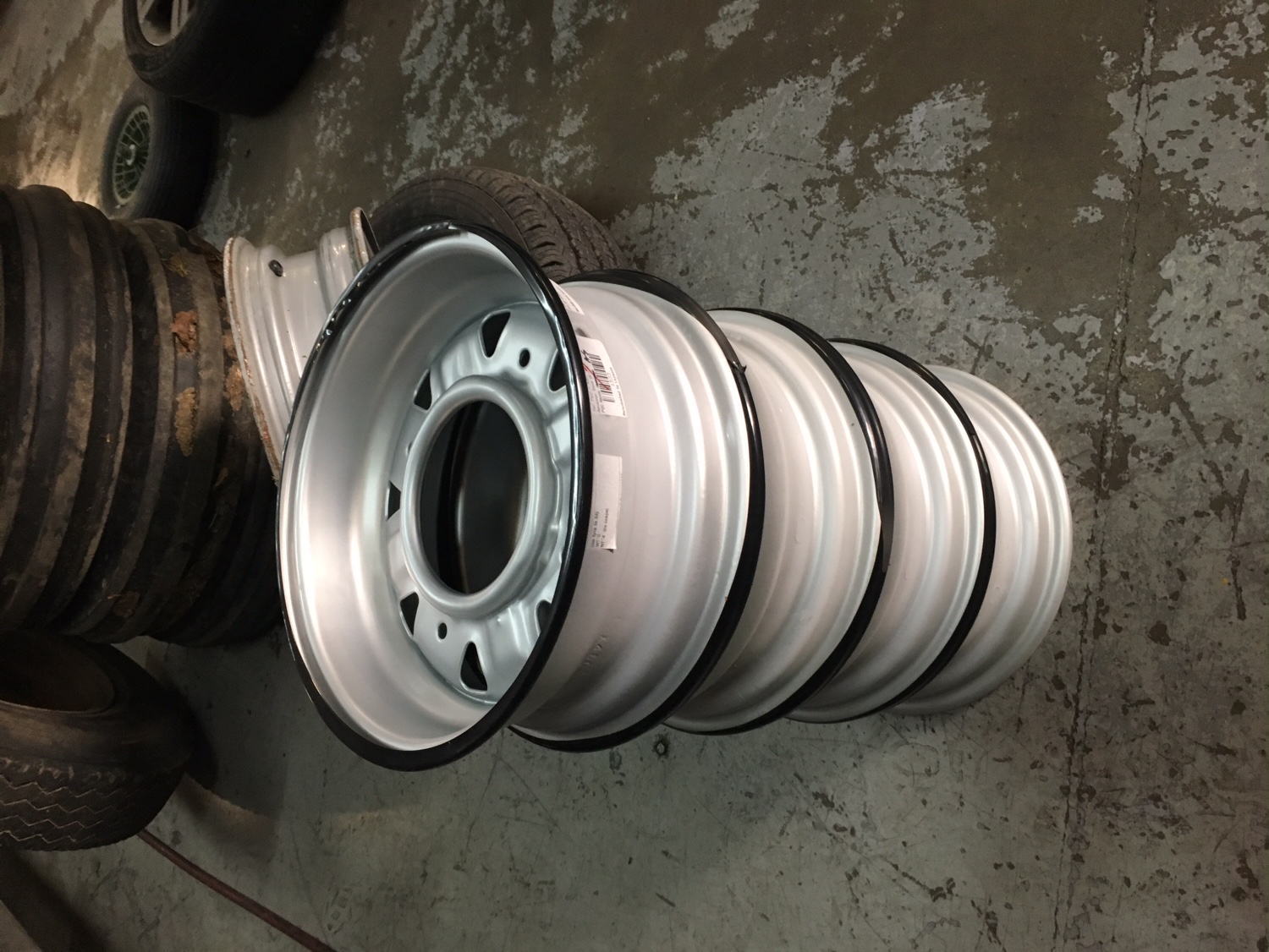

Finally the wheels are back!
The car looks completely wrong with the standard wheels it currently sits on...the offset of the Borrani wheels is the reason for the bolt on arches - so without them the stance is very under whelming.
I haven't seen the car with the arches and wheels - so there's something to look forward to.......
