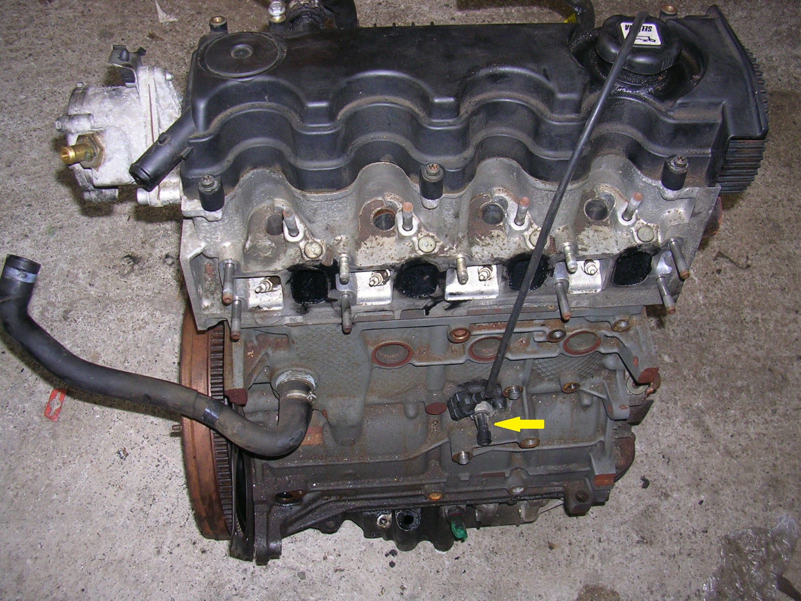

Fiat stilo 1.9 jtd, spend 4h and didn't find it...
It's at the back of the engine, at the back of, and slightly above the alternator. The electrical connector is held on with a locking clip that needs to be held back while pulling the connector off.
The black cable and connector seen hanging in the picture below is not for the oil pressure switch.
I got to mine recently without moving anything out of the way. Perhaps you have bigger hands/arms than me. If you can't get to it from above, you'd need to get the car on a lift or axle stands to try from below.
Whichever way you go, be very careful of the fuel pipes around the fuel return manifold (black plastic box), they are very easy to break.
