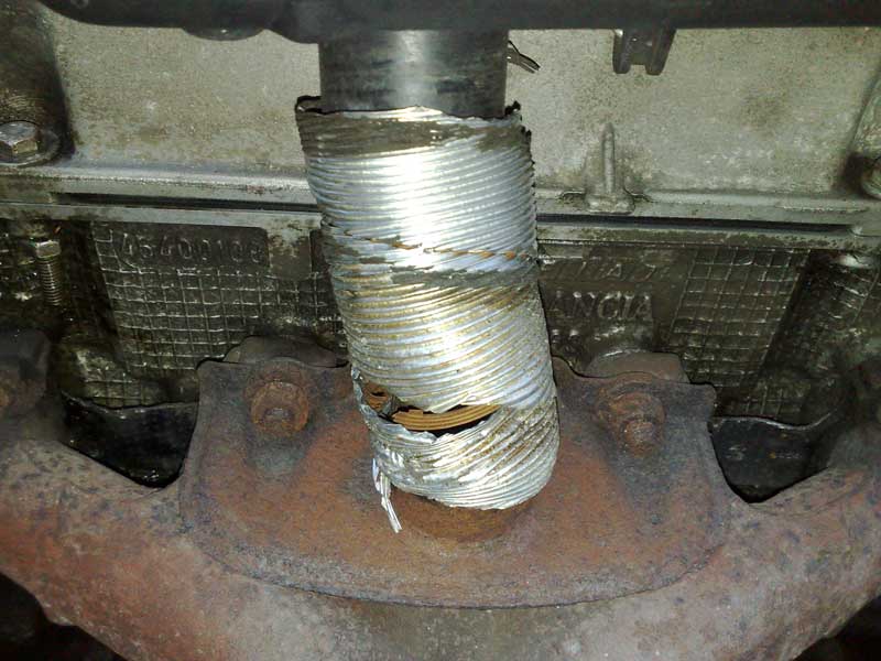

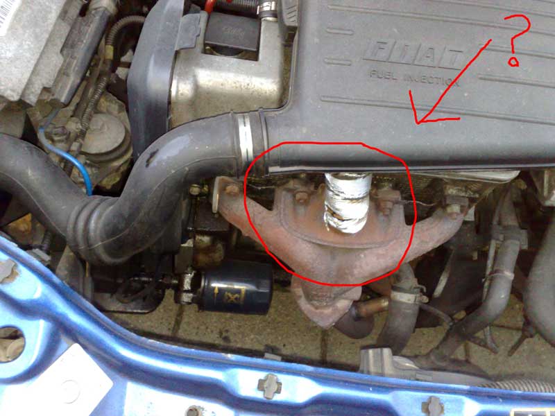

2) There is a cylinder in the motor, which is broken. I've attached a photo of it.
What does this part do, and what is it called (need a new one :)

directs hot air from manifold to intake to warm up car faster(operating temperature)
you dont say what car/engine/model you have;)
mk1 punto...this wouldnt be causing the burning smell
Are you sure you have abs? its not the type of thing you "see/feel working", unless you need it. . . that ofcourse if you have got it in the first place.

warm air comes from around the engine (heated by the engine). The intake is the casting beneath it and at the end of the pipe on the airbox (goes to the drivers side on a UK car).
This air comes out of the exhaust after it has been combusted with the fuel in the engine but will not cause a burning smell!
Okay. So what that broken cylinder does, is only to "guide" the hot air to the air intake. Is that correct?
And the air we are talking about isn't polluted yet. Right?

Hi mate,
The broken cylinder in your photo is sitting on top of the exhaust manifold. As T says, the exhaust manifold heats up quickly when the engine is started, and the broken cylinder sucks some of the warmth from around the manifold into the engine air intake. This air does not go anywhere near the inside of the car, but goes into the engine and eventually out of the exhaust. So i would ignore it all together.
I would check the exhaust manifold itself for leaks/holes. You may get a leak where the exhaust manifold meets the cylinder head, or if the manifold has rusted through in any place. This would cause exhaust gasses to escape into the engine bay instead of out of the exhaust at the rear. In turn, these exhaust gasses can then make their way out of the rear of the bonnet as you are going along, and into the cold air intake for the inside of the car. This is DANGEROUSE! as it will contain carbon dioxide which can cause you to pass out and lead to brain damage etc. Also check the downpipe from the manifold. There should be very little exhust fume smell in the engine bay when the engine is running.
Hope that helps,
Alan
Hi mate,

I think I undertsand now. It is not the exhaust air that comes out. But only heated air?
What cylinder head are you talking about now?
Hope that helps,
Alan
It did help a lot. Thanks.
If I drive with the fans all turned off (for now, until I have have figured this out) it shouldn't be dangerus right?
Arite min, yes it is the exhaust air that is coming out that is heated but its going straight back into the engine so lets not worry about that, right in that picture you posted up the hot air feed going to your filter box is coming from your exhaust manifold that is bolted onto the clyinder head, check your manifold for holes/cracks that could be letting the exhaust gases into your car as your driving along, as for the dangers imposed i wouldnt like to pass comment saying that turning the heaters off would remove any dangers as i cant be sure, best thing to do it to identify and correct the problem quickly! after all if the car has a strong smell of exhaust gases inside perhaps it isnt a good idea to drive it!
