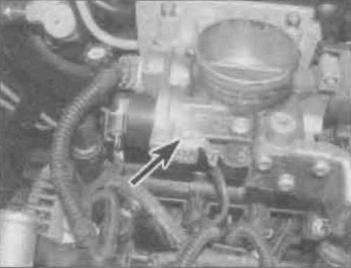

I cannot find these earth connectors for the life of me.
Can anyone please point them out on one of my photos?

I assume battery terminal photos are pre-cleaning. They are very bad. At a minium you need to take them completly apart and clean all the surfaces and cable lugs. The earth lead is the black one that runs between the battery negative and the engine by the ignition coil. The engine compartment does not look great. A mixture of old an new nuts on the exhaust manifold suggests the head may have been off recently, not good news.

In your second picture just to the left of S-shaped pipe is the earth coonected to throttle body looks like it could do with a clean.
