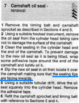

finally bought original fiat camshaft oil seal and gonna change it soon
sealing lips?

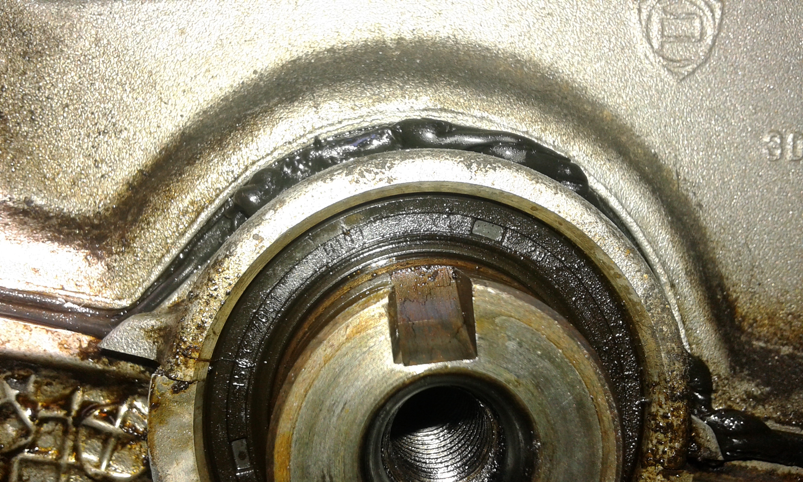

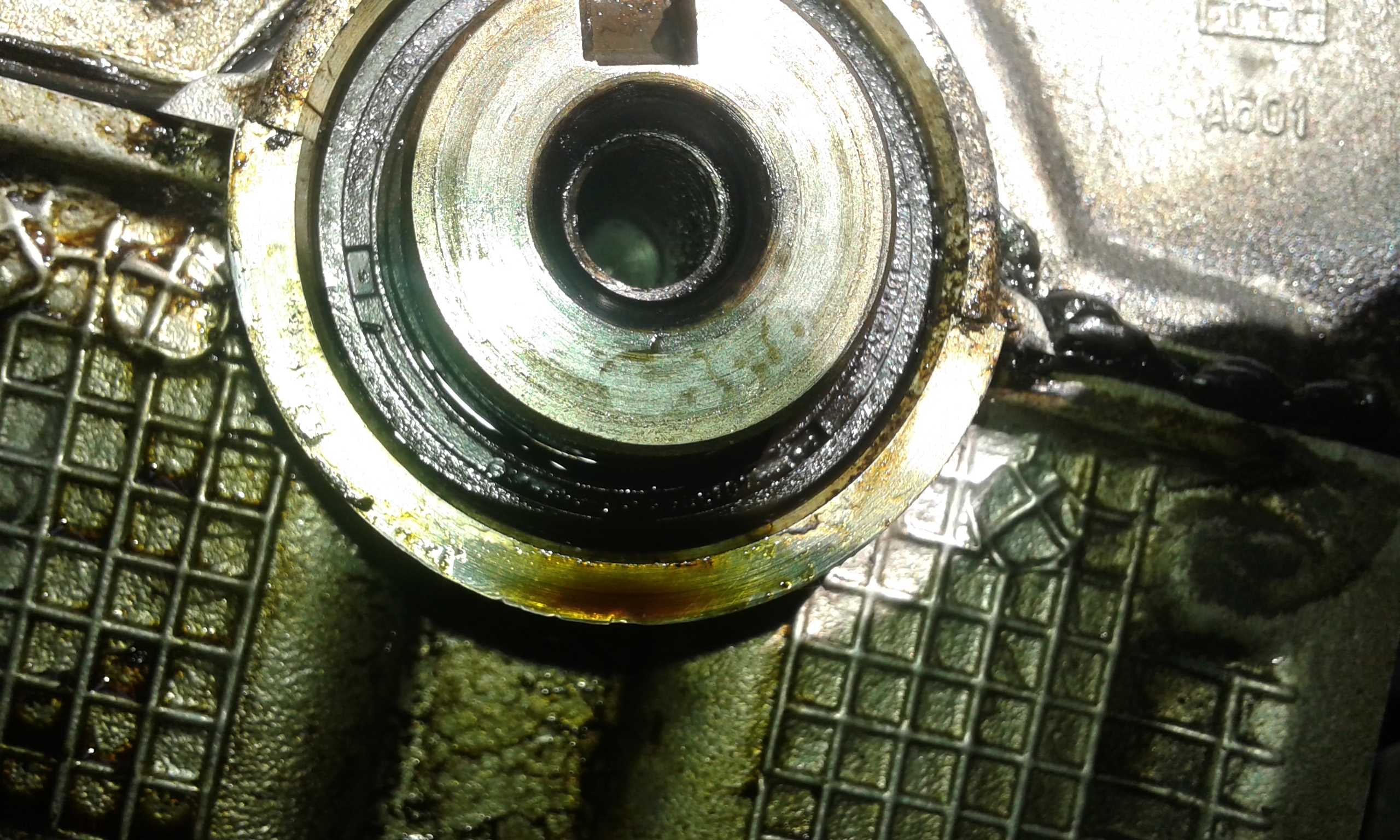

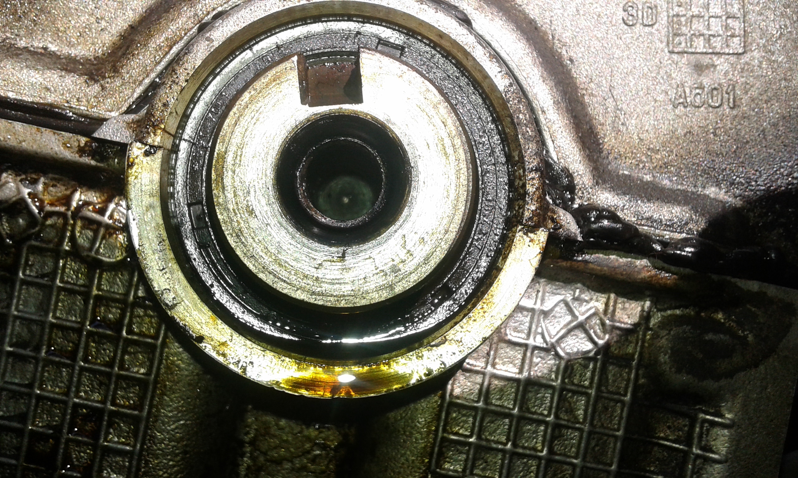

changed camshaft seal yesterday and it may appear it doesnt leak anymore
it is clearly seen its not leaking from above but directly from camshaft seal
pictures before

Nice pictures. Just one thing I see is that the rocker cover seal looks slightly untidy. It may be the leak came from there.
My may need doing but at the moment I am leaving with it. I did this in the past when it start leaking, I ignored it and then suddenly it stopped. Hope it does stop again so I don't need to take any actions. Is no where sure to diagnose it in my case as I don't have the luxury to remove the the camshaft sprocket to have a proper look like in your pictures. I am driving the car without the timing belt cover so if it gets worse I should notice in good time.

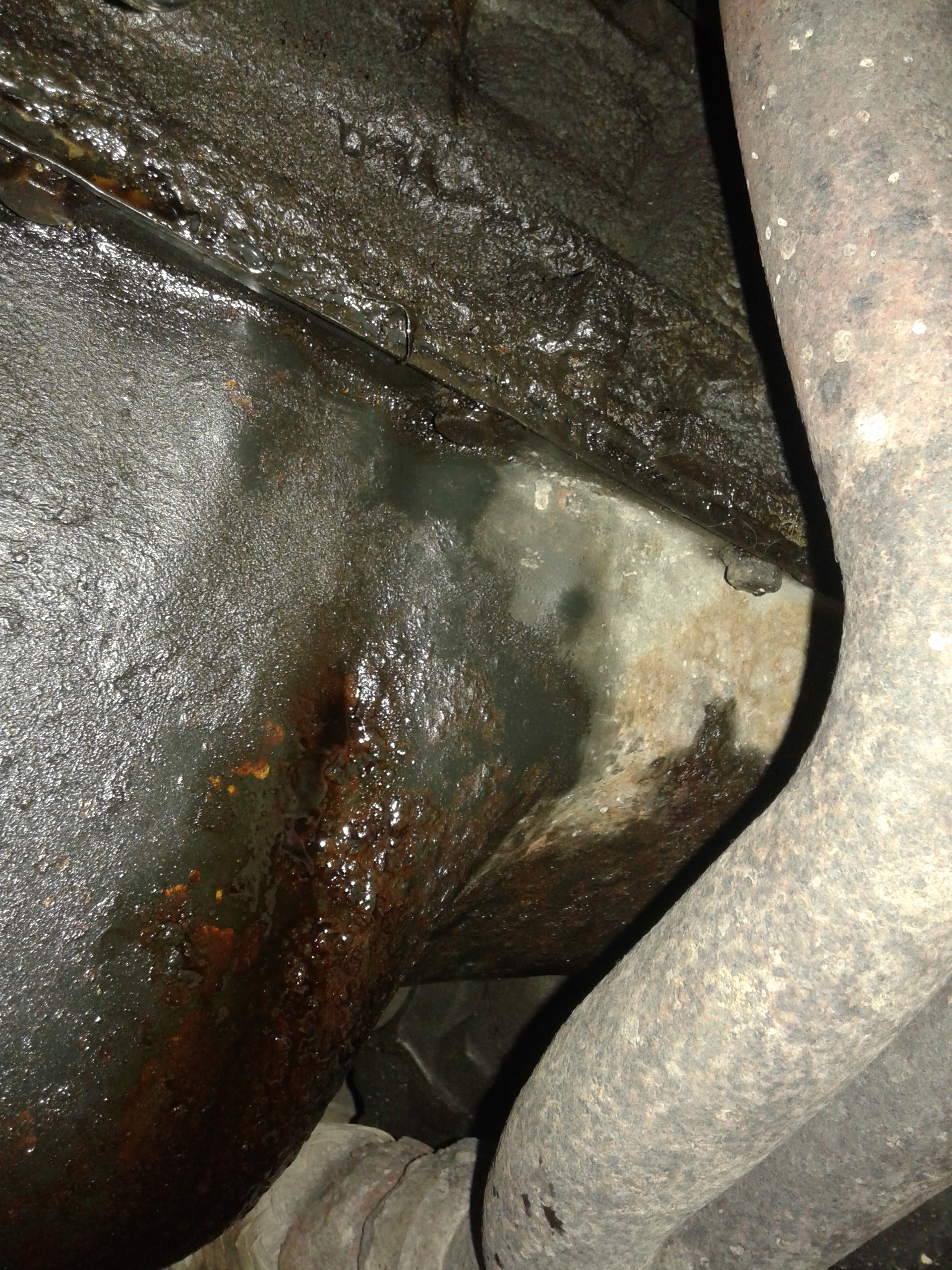

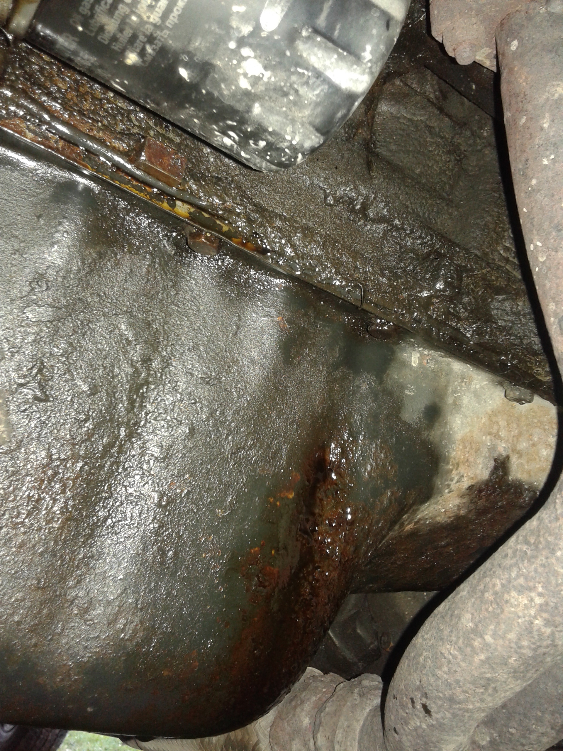

doesnt leak anymore at camshaft oil seal but just to be sure i have put cardboard under car overnight and this morning there was oil on it, found out there is a tiny hole in sump and it leaks there, well sump lasted 21 years
should i use sump from my donor car or better to buy new?
