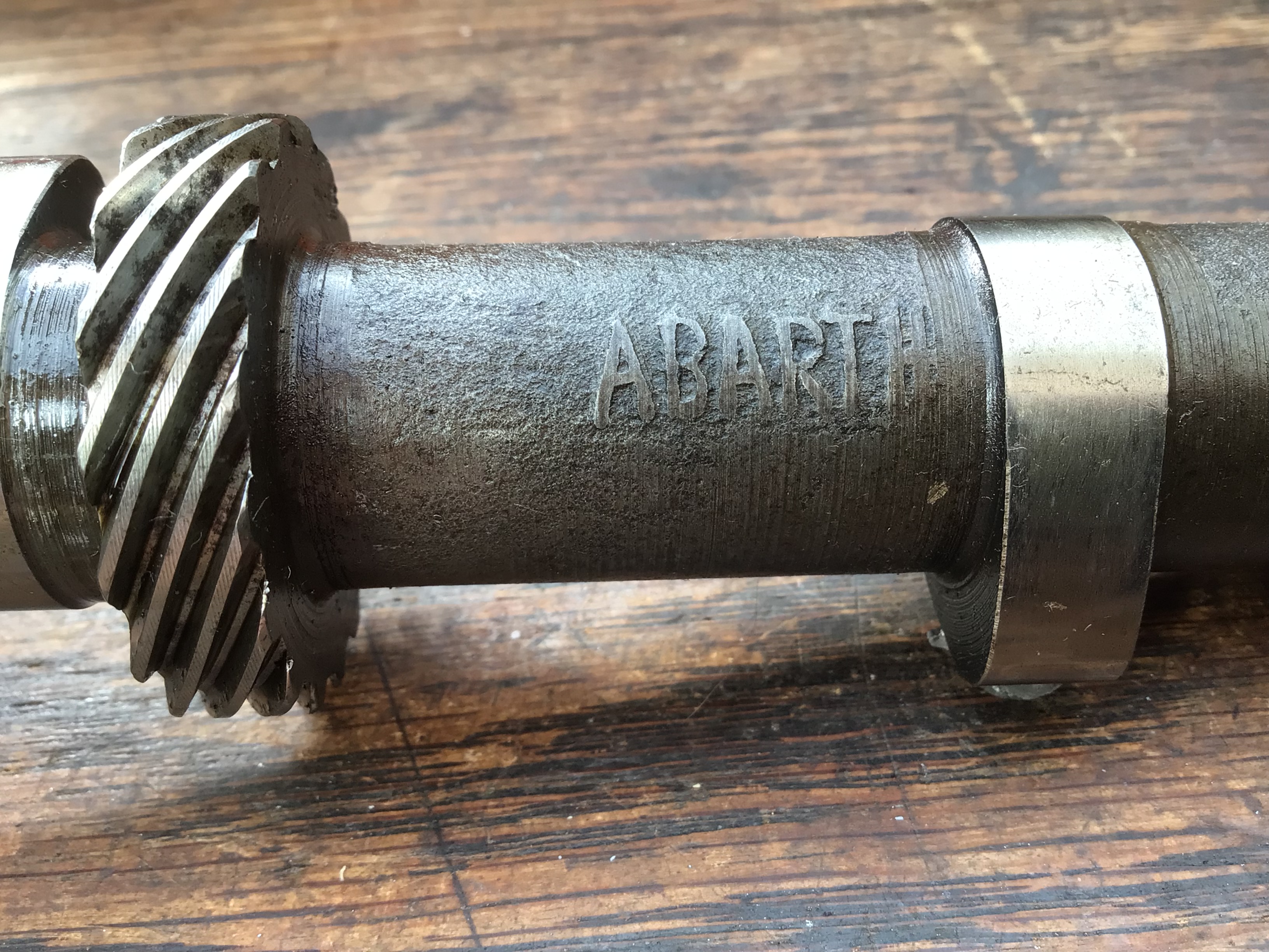

I am starting the restoration of my 1959 500N Jolly and am having the engine rebuilt. Rather than increase the case opening to accommodate a larger cylinder, I plan to reuse the original 479cc cylinders and fit new 66.8mm pistons that I already have. The question I have is concerning the camshaft. I was planning to install a new camshaft that can provide better performance (nothing too radical). I was thinking about installing an original Nuova Sport camshaft, but I can't find one. Nanni Ricambi have two different options for a 500N camshaft, a 75/35 - 35/75 and an 80/40 - 40/80. However, those numbers are not even remotely close to the Sport Specs in my original 1959 factory workshop manual 25/51 - 64/12. Perhaps I am not interpreting the differences correctly. Knowledgable advice would be appreciated.
Eric
