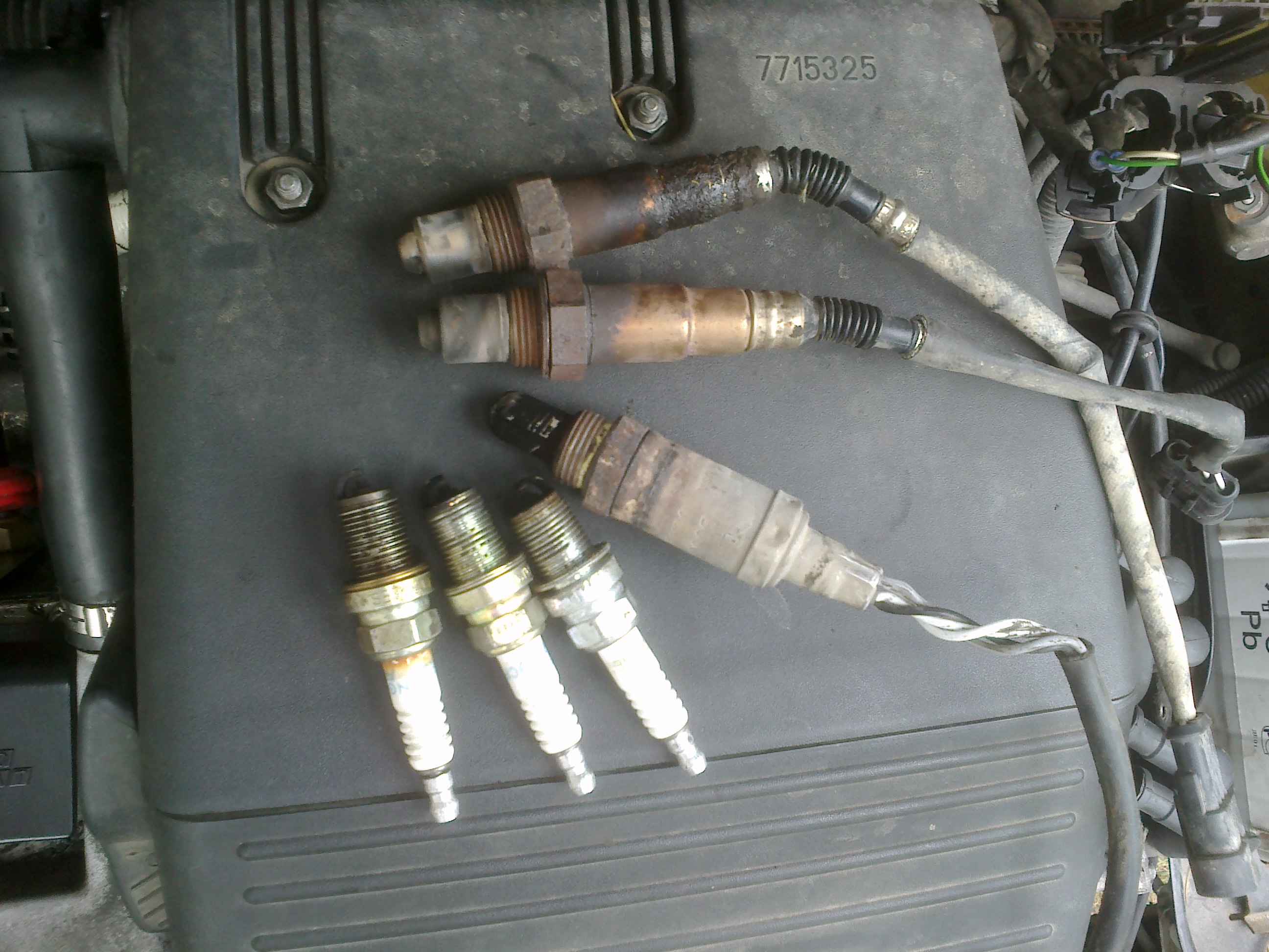

black on electrodes yes, didnt clean them
Mmmmm, indicative of running rich. Try cleaning them up and re-gapping them (0.9mm from memory but look it up) - see if that makes it start and idle better - and if it does do resistance test on the coolant temp sensor

mk2 lambda fit mk1 ? i know i will have to rewire, but will it work properly?
Yes that's the one mate
