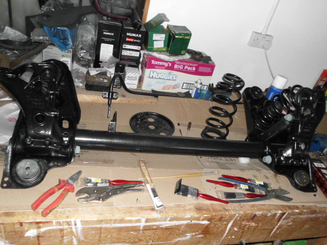

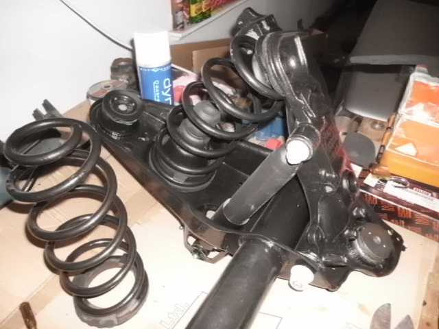

Photos of the nearly finished subframe after final coat of hammerite.

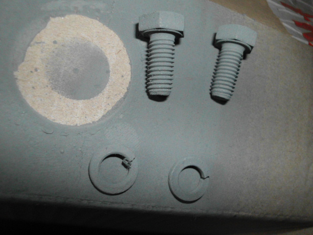

Here is the level I am working to , these are the 2 bolts and washers that fasten the rear towing hook to the chassis, the bolts and washers have been dipped in a bare metal rust remover, re painted in zinc galvanizing paint and when the tow hook is bolted back to the chassis it will have a final top coat of hammerite.

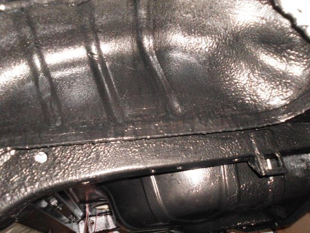

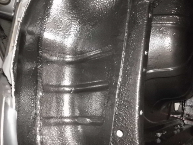

Back under floor of the car has any rust removed , inspected with jewelers eyeglass to make sure no rust remains in any pitted metal, primed with zinc paint and top coat of black hammerite.
