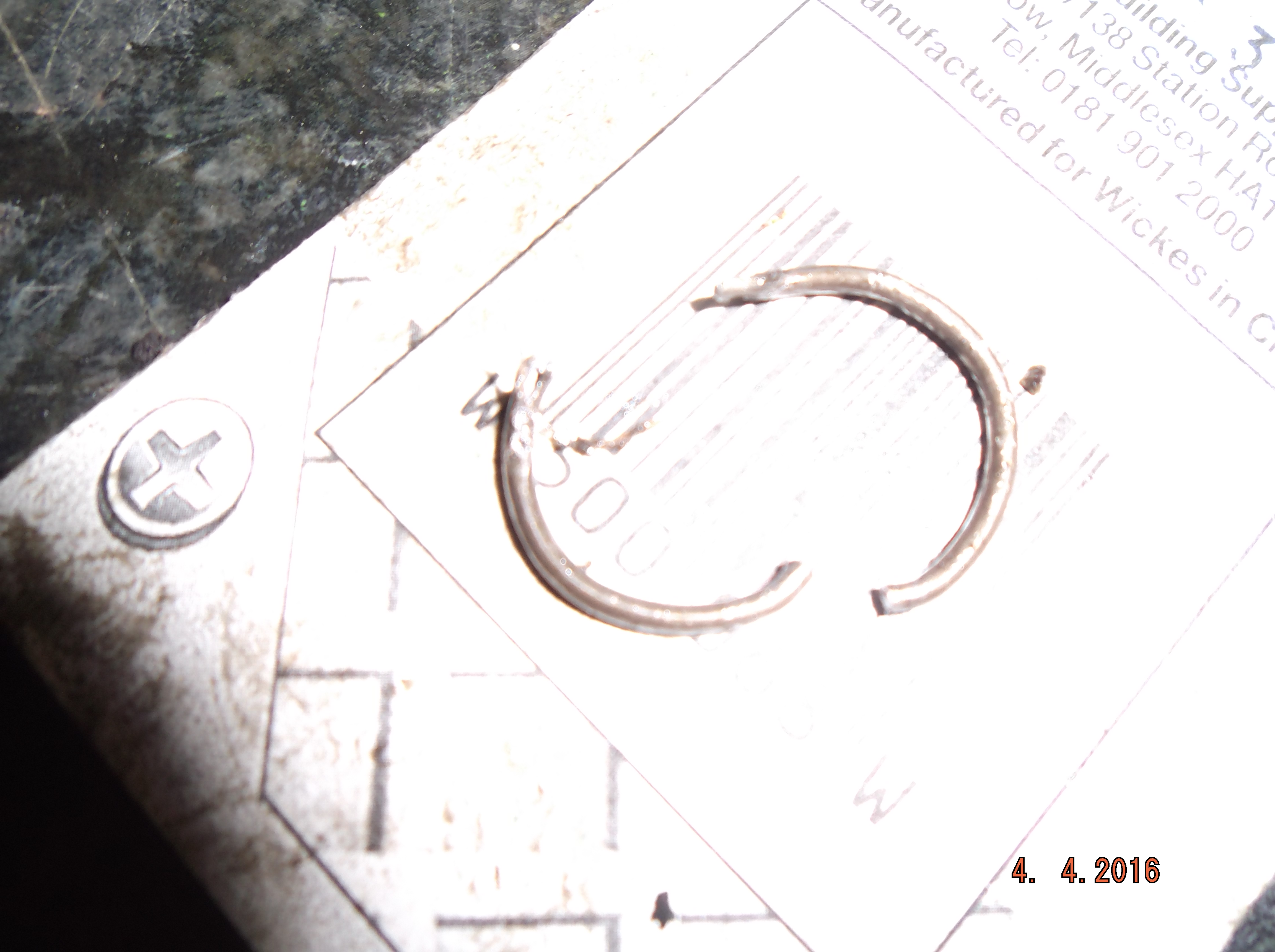

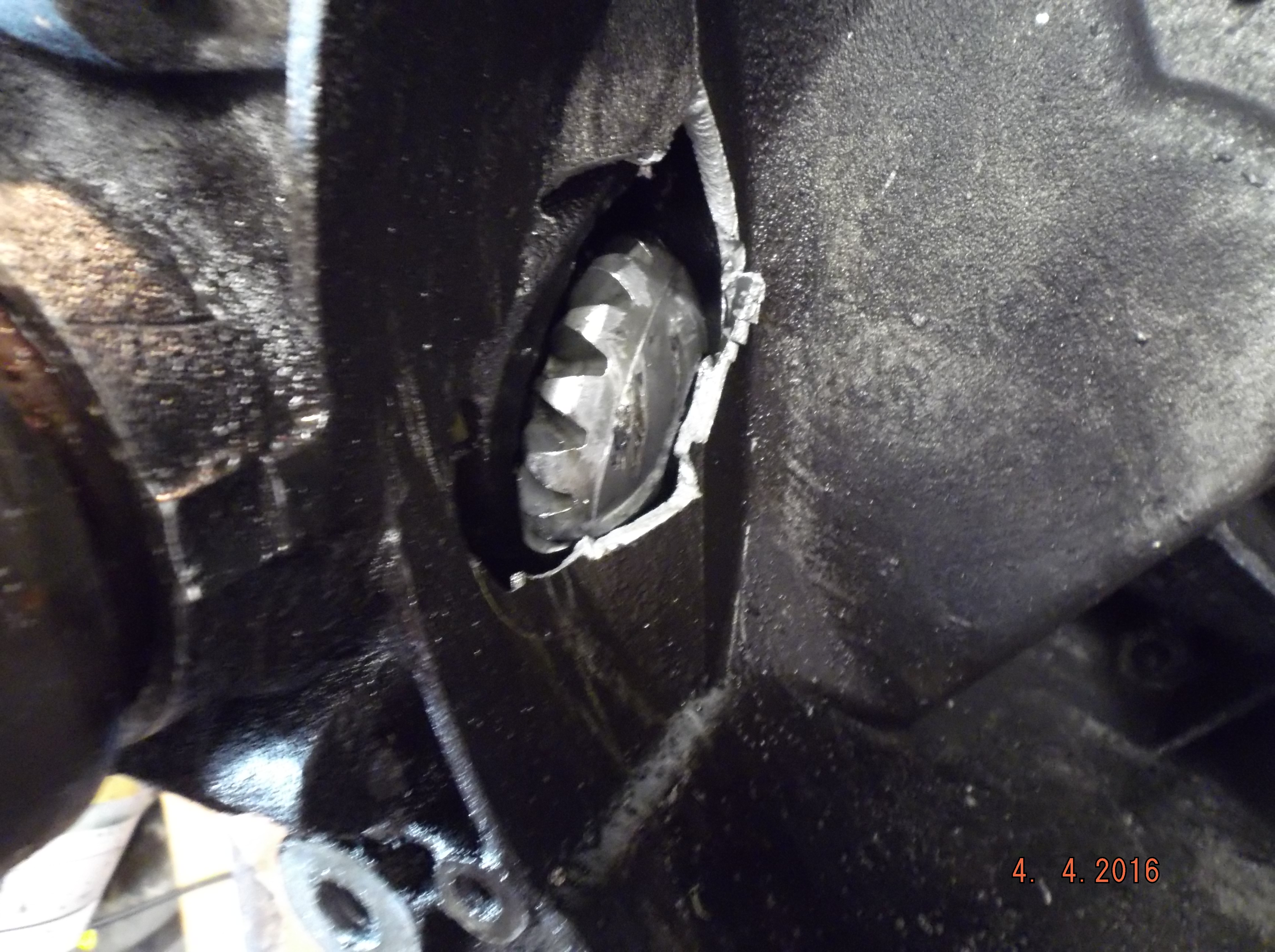

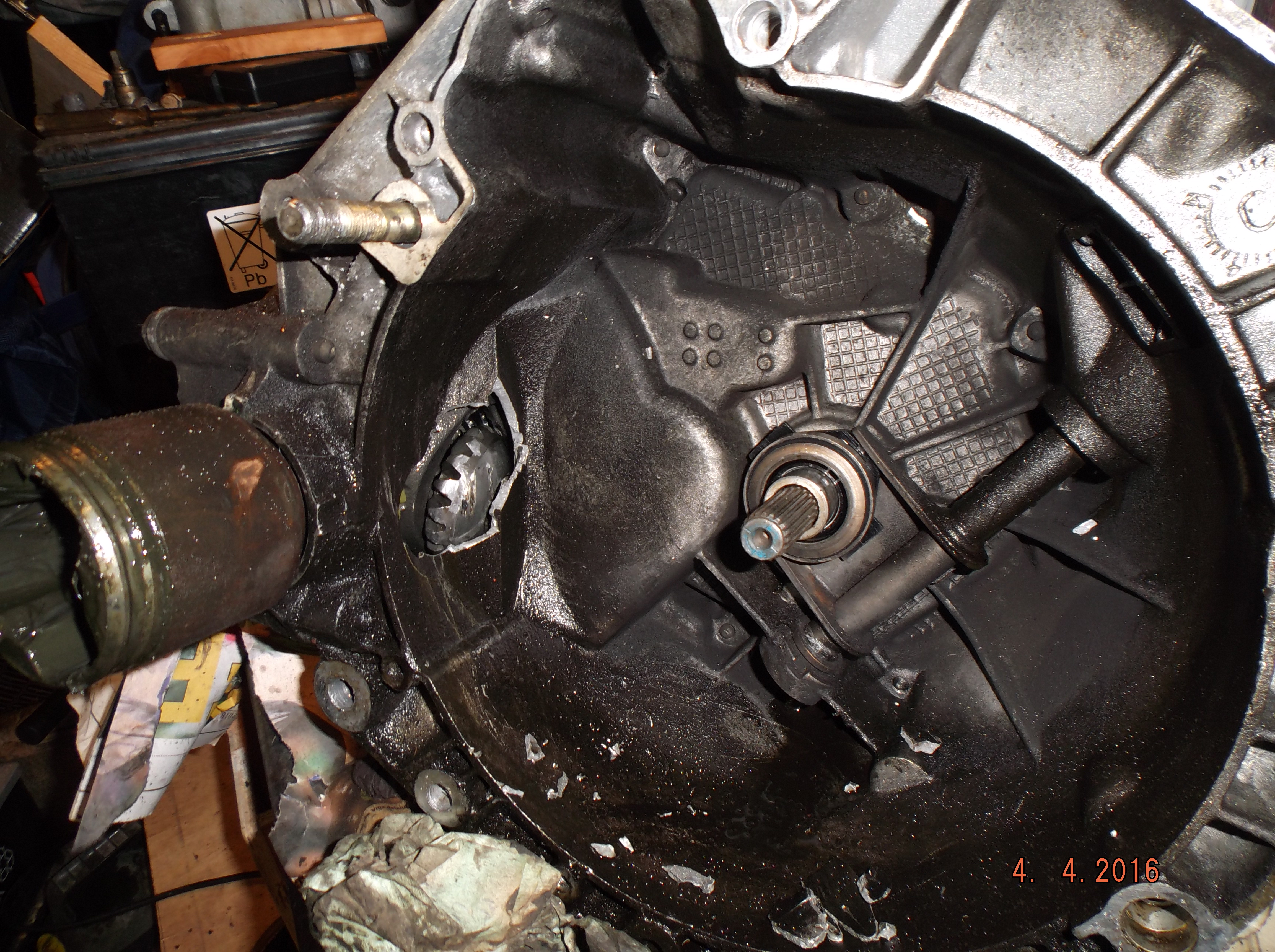

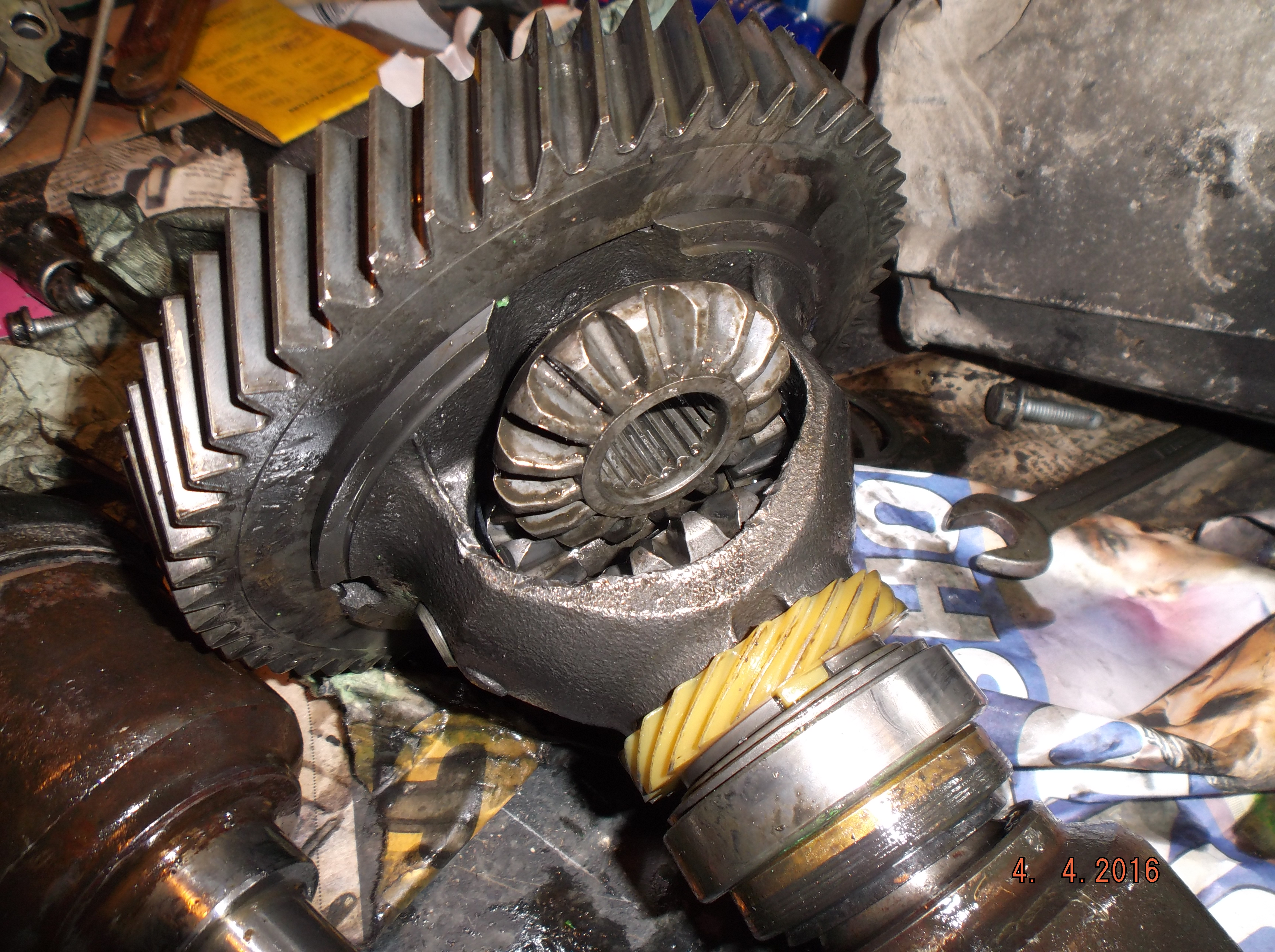

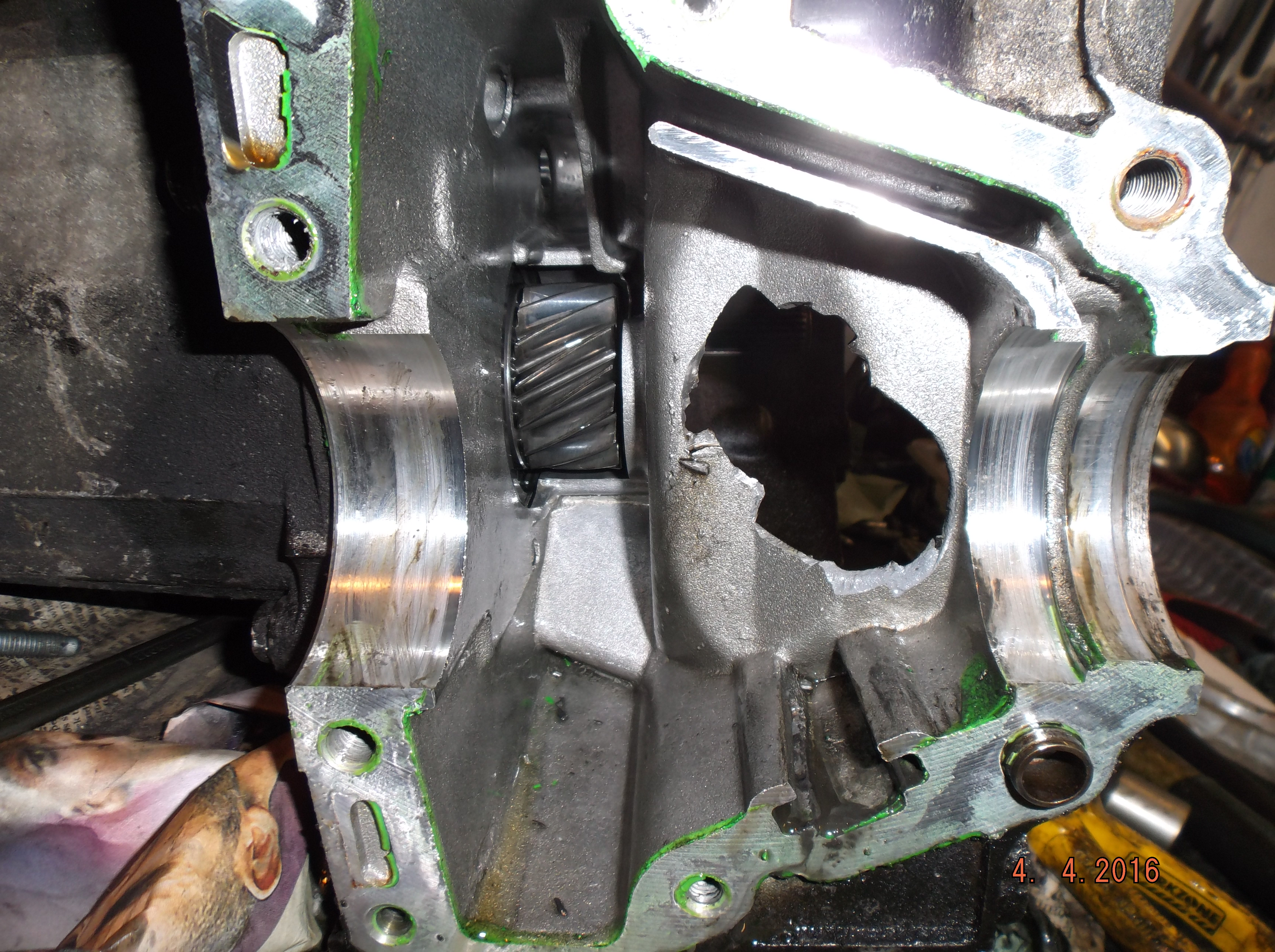

Just put a new clutch, brakes etc in my 99 Cabrio, Renewed seals on drives as well as rear crank seal. All back together, started no problem, into gear and bang!, Oil out of box, a good few F>>KS etc and then left it alone for a few days. Took box out today, one of the sun gears out of housing through into bell housing. I suspect that the circlip cracked when I replaced the shaft and caused the problem, found the two pieces of it in the bottom of the diff. Plastic speedo drive well chewed as well.Few pics attached. Isn't life a bitch!

Thanks for that "Messing":p I reckon it was the circlip that broke and got caught in the gears. I've just stripped the diff on the replacement box, new seals and checked it out, no magnet in housing, obviously been apart before. Hope to drop it back in tomorrow, took disc off today as there were oil splashes on it, all cleaned now.
