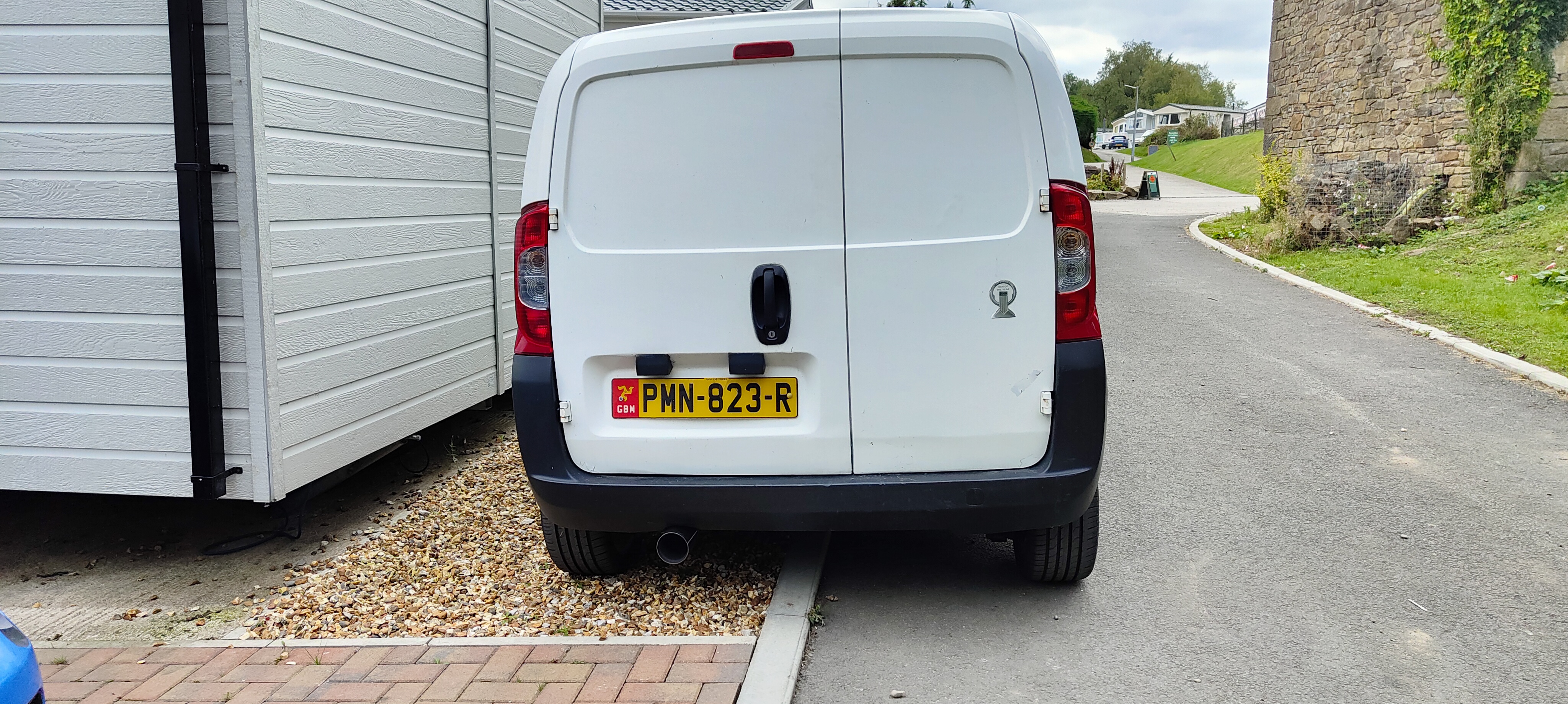

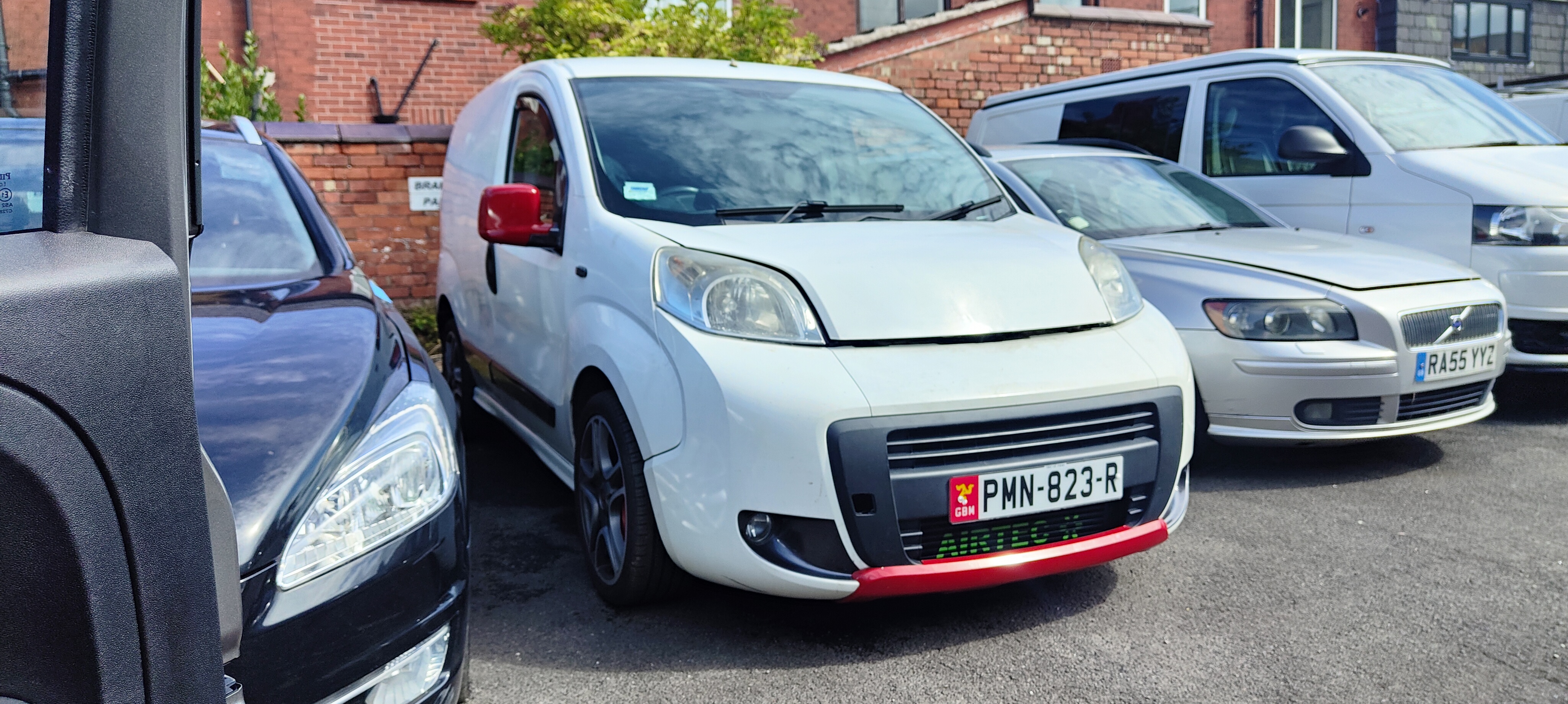

Did a quick shakedown round the block, definitely pulling back but needs a remap for the TD04, injectors and FMIC that's been fitted as it's running stock 180 T-Jet. Gonna be a serious little motor when done.
