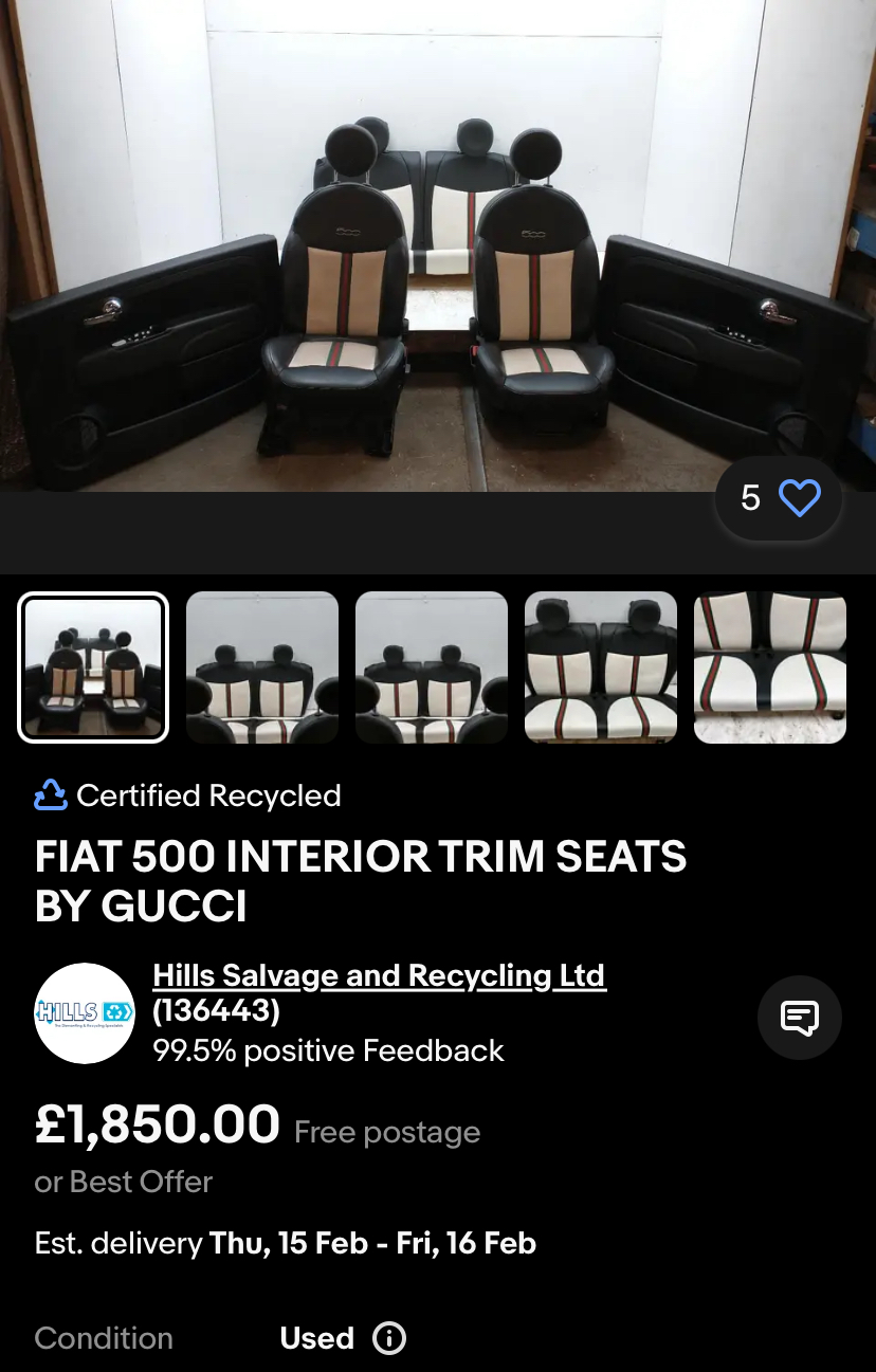

I see another Gucci has gone to the big scrappers in the sky….. just shows you what their interiors are going for 😑 a bit scary actually…. I’ve often imagined going to my car in the AM and finding my interior missing 🤣😑
