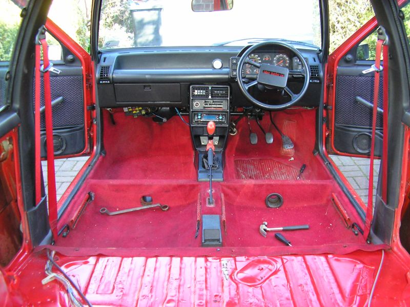

Ive had the week off work so in the rain and wind ive been outside pulling the interior out and seeing what needs doing to the floor/sills etc.
cats like carpet

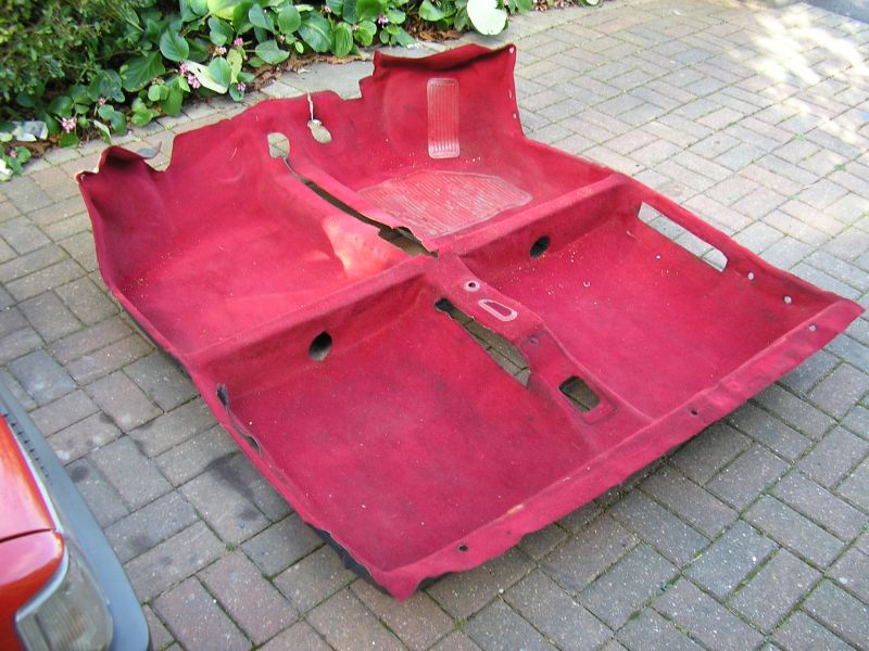

Seats out, just waiting to get the carpet up now
Its out! :slayer:

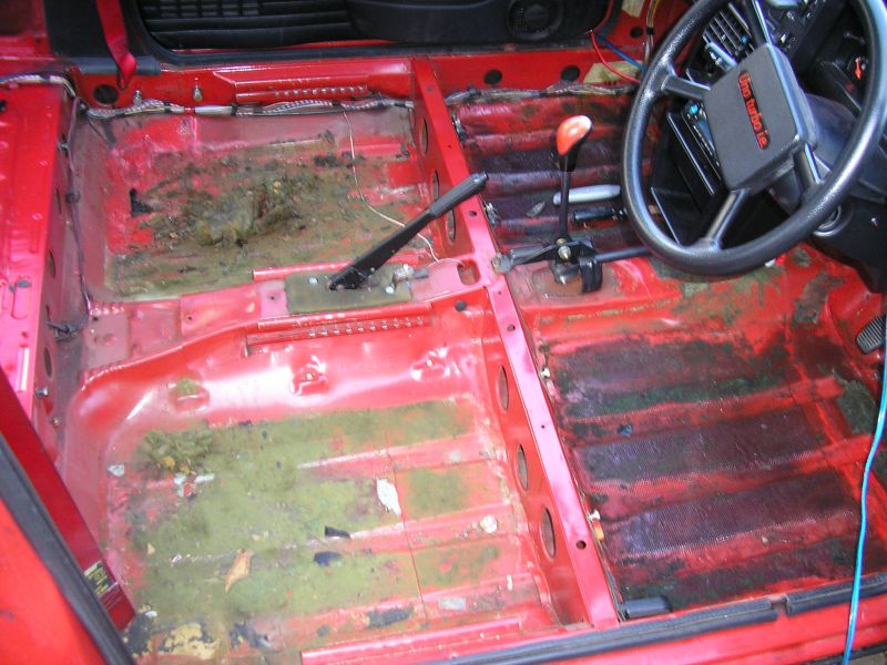

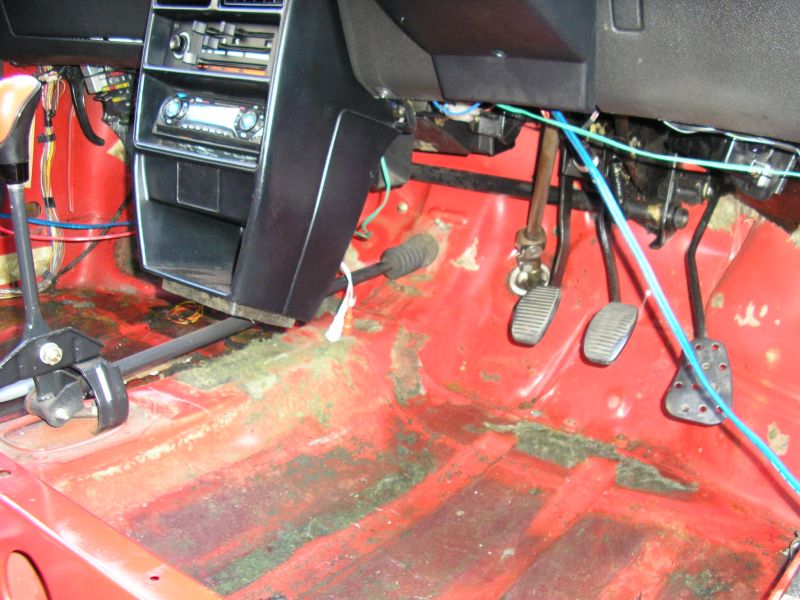

An overview of the floor under the carpet. looks a bit messy and is generaly damp and pretty disgusting :yuck:

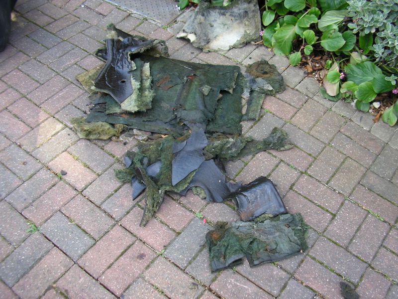

Turning it over, its also mouldy so its all come out and in the bin :yuck:
The floor underneigh the soundproof carpets. still got the glued on sound proofing to go but its generaly still filthy and green
Looks worse than it is. most of the rusty looking patches here are just stuck on bits of crap. the drivers footwell is generaly fine! :slayer:

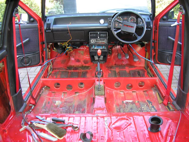

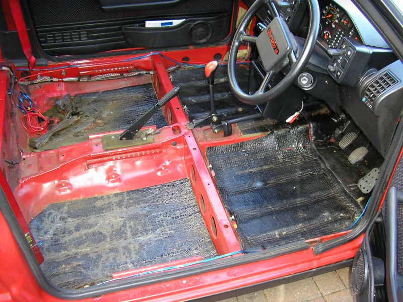

A quick look from the back

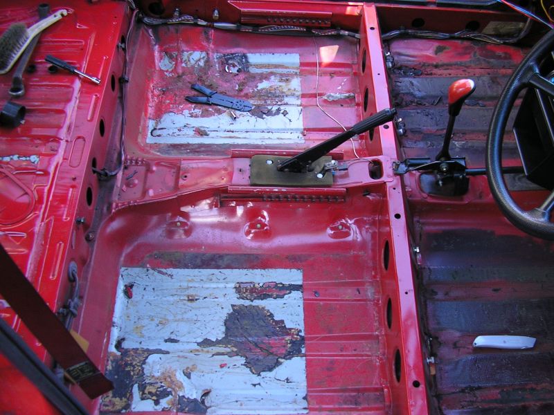

Taking out the glued on sound proofing to see whats underneigh. The passenger footwell brings up the work that was done for last MOT. pretty shody work if I must say myself. its already started to rust again and its a complete mess on the inside. underside of the car looks ok though.

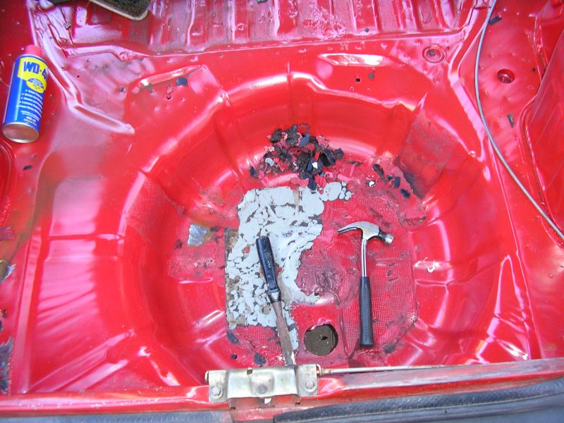

taking the soundproofing out of the spare wheel well. No more rust than I reported last time
All out

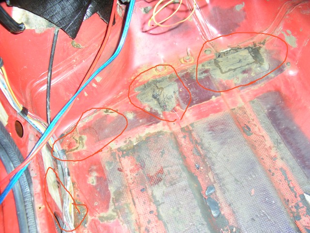

The worst part ive found. Ive circled all of the major rusty bits. well, the parts that arent just surface. Its the passenger front footwell. part of the floor has come detatched from the sill from rusting. Also there are holes and rust running along where the floor is welded to the front. and again, an old weld has started to rust again.
Unfortunatly I didnt take anymore photos but I basicly ground all the rust I could back to bare metal, treated it with krust and then sprayed with anti rust primer. For the holes I did the same but ive also temporarily fibreglassed over to stop anymore water getting in etc.
Ive also found that the front windscreen is leaking :bang: , thats why it was so damp underthe carpets and why there is so much rust in the passenger footwell as thats were the leak is
Theres a chip in the screen anyway (apeared last week) so i could get that sorted on insurance and ital fix the leak too
