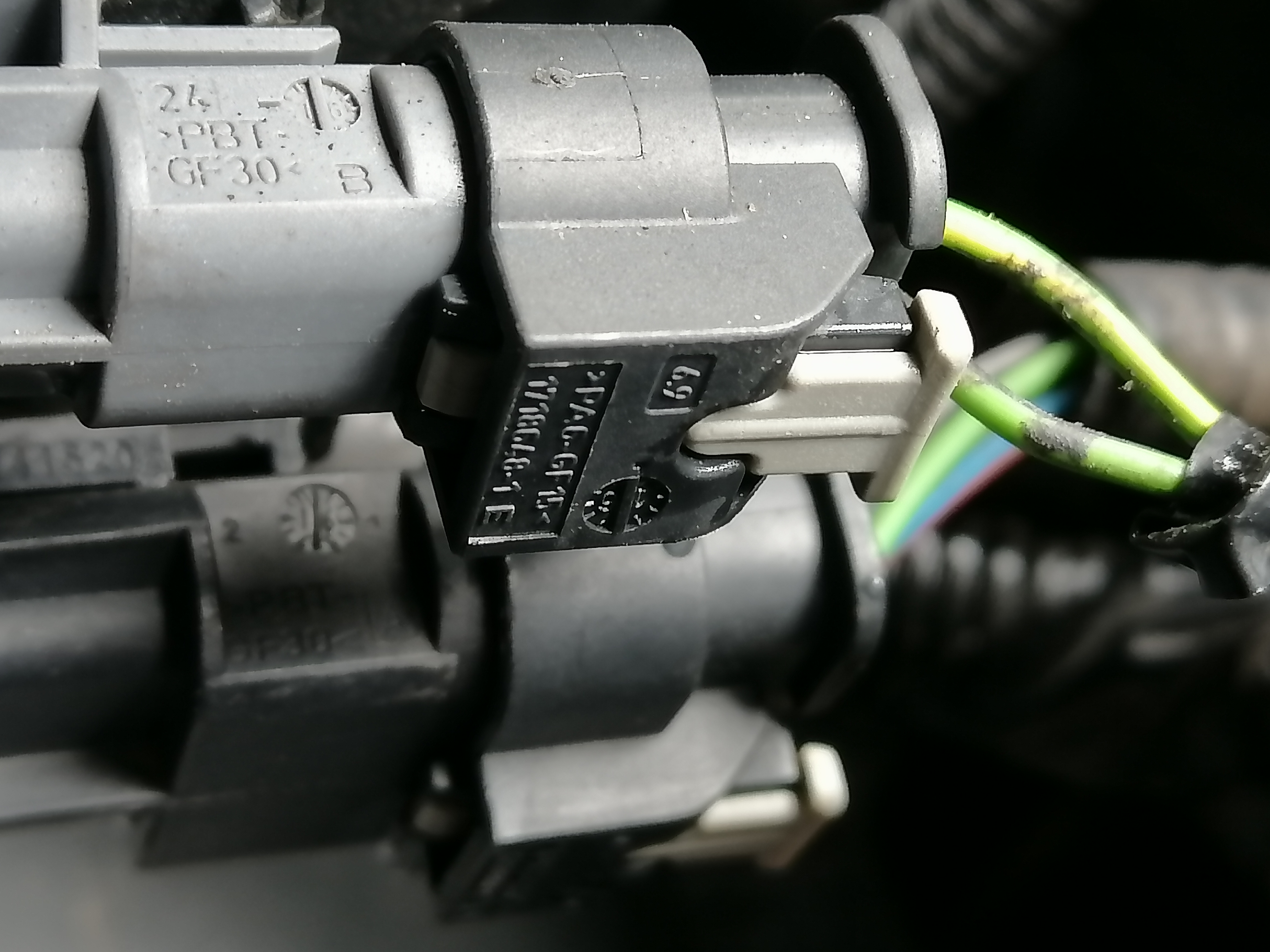

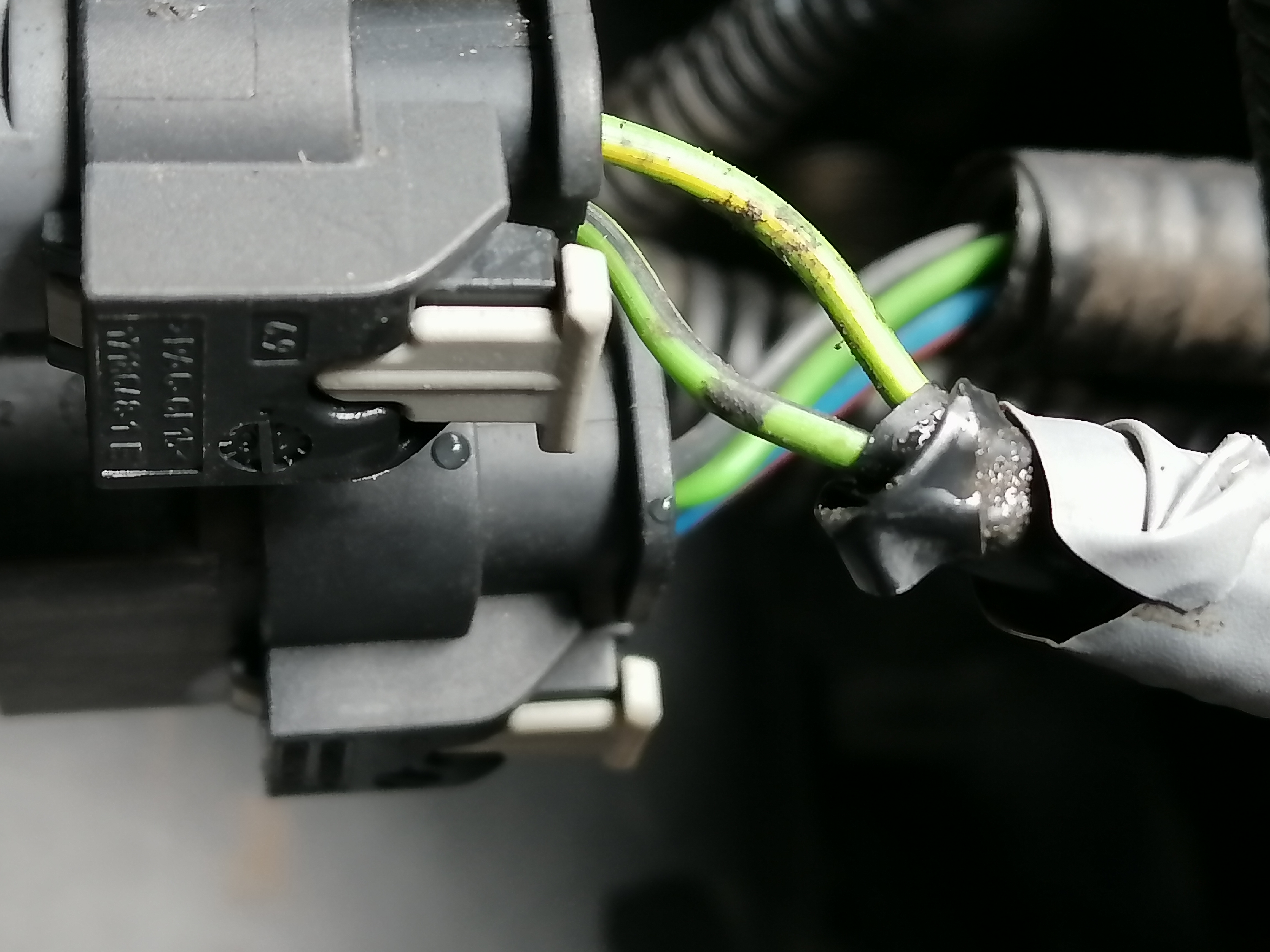

Could anyone know what the damaged looking wires go to.. Thanks

Looks definitely like the Flux Capacitor. :whistle: 🤓
But the black "charring" looks like gum residue from the cloth tape, not actually burning. Get some WD40/paraffin/carb cleaner on a piece of cloth and give them a wipe to see whether it comes off.
There seems to be two of the plugs, so depending on the car could be the feeds to a pair of coils. It's tricky to tell from so close up.
