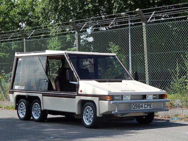

If you want to go all out special cars take a look at the WIlliam Towns Hustler series from the 1980s. They were based initially on the old Mini (and looked really weird) but later Metro got the balance right and he even built a supersize version with Jag running gear.
The idea would work well with Panda parts and subframes even 4x4 frames at the back. The big issue with modern cars is the wiring. The 169 Panda is a hotch-potch that's evolved (check under the engine bay fuse box for a tangle of wires. Maybe Fiat improved on later cars.
Early versions looked out of proportion but the Huntsman and Highlander seemed about right. Its a steel top frame that carries windows and a similar underframe that carries engine and suspension. Floor pan and panels were fibre glass.
This one made £11,500 at Bonhams.
https://www.bonhams.com/auctions/21902/lot/418/
