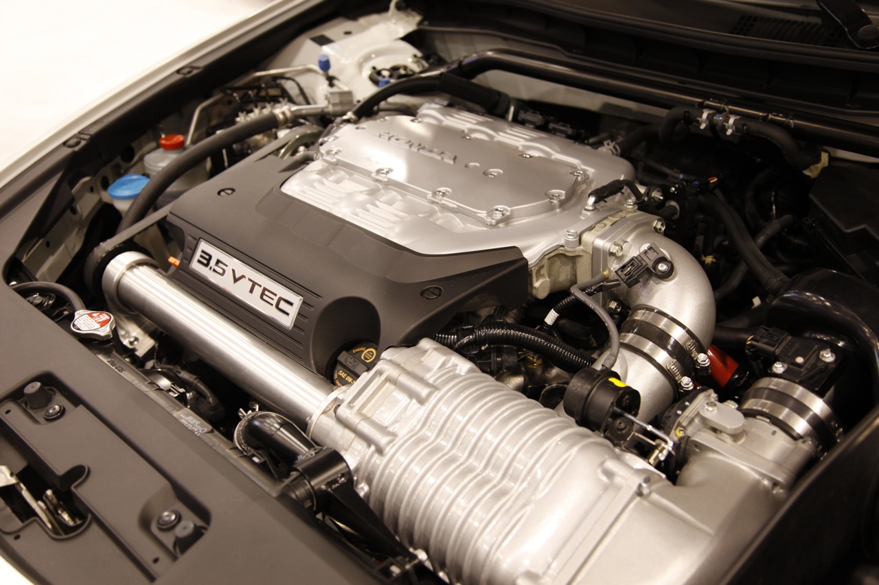

That looks like a Lotus Evora set up. :)

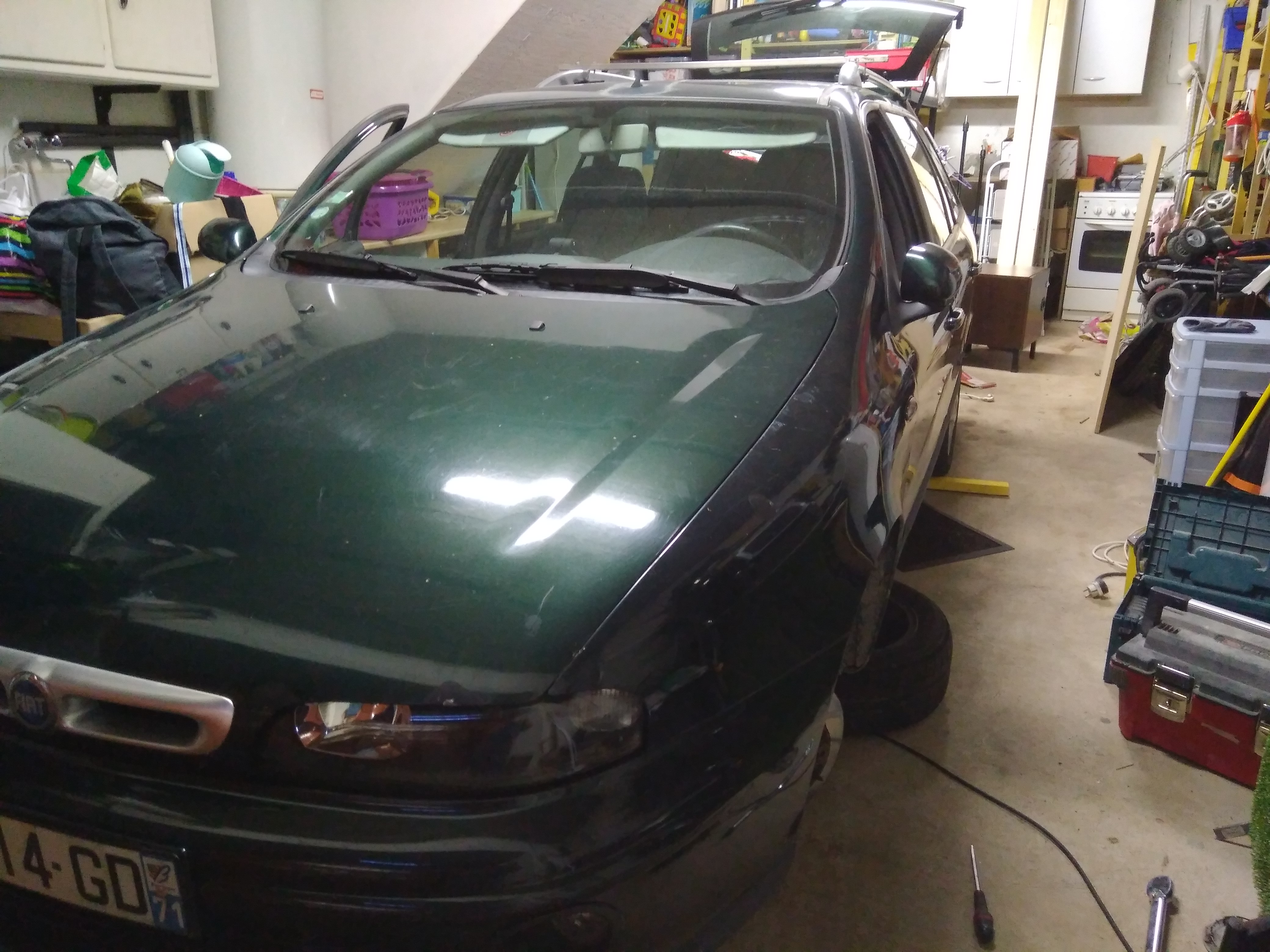

Left hand side drive shaft, suspension arms on both sides, and just for good measure, seeing as i have it all apart and will need the tracking done anyway, new steering arm ball joints.
This was not supposed to have happened today.
