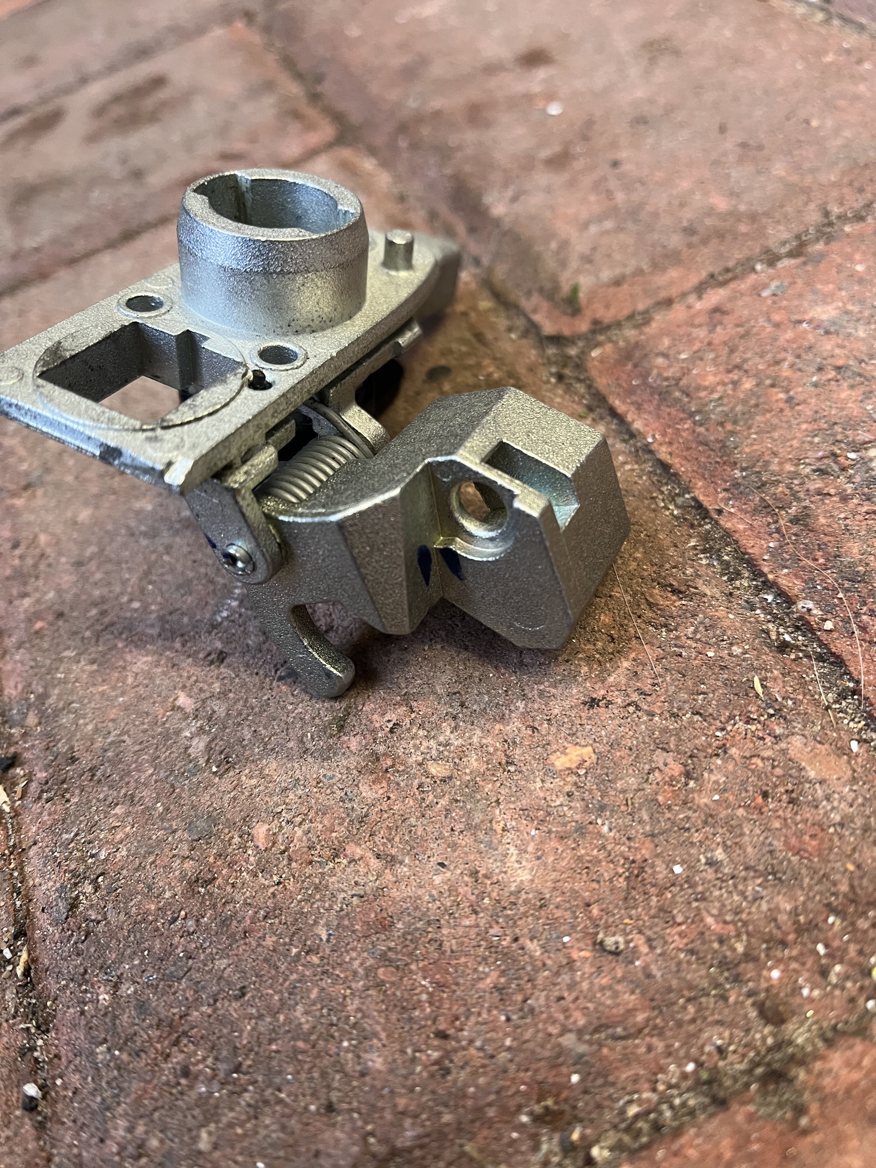

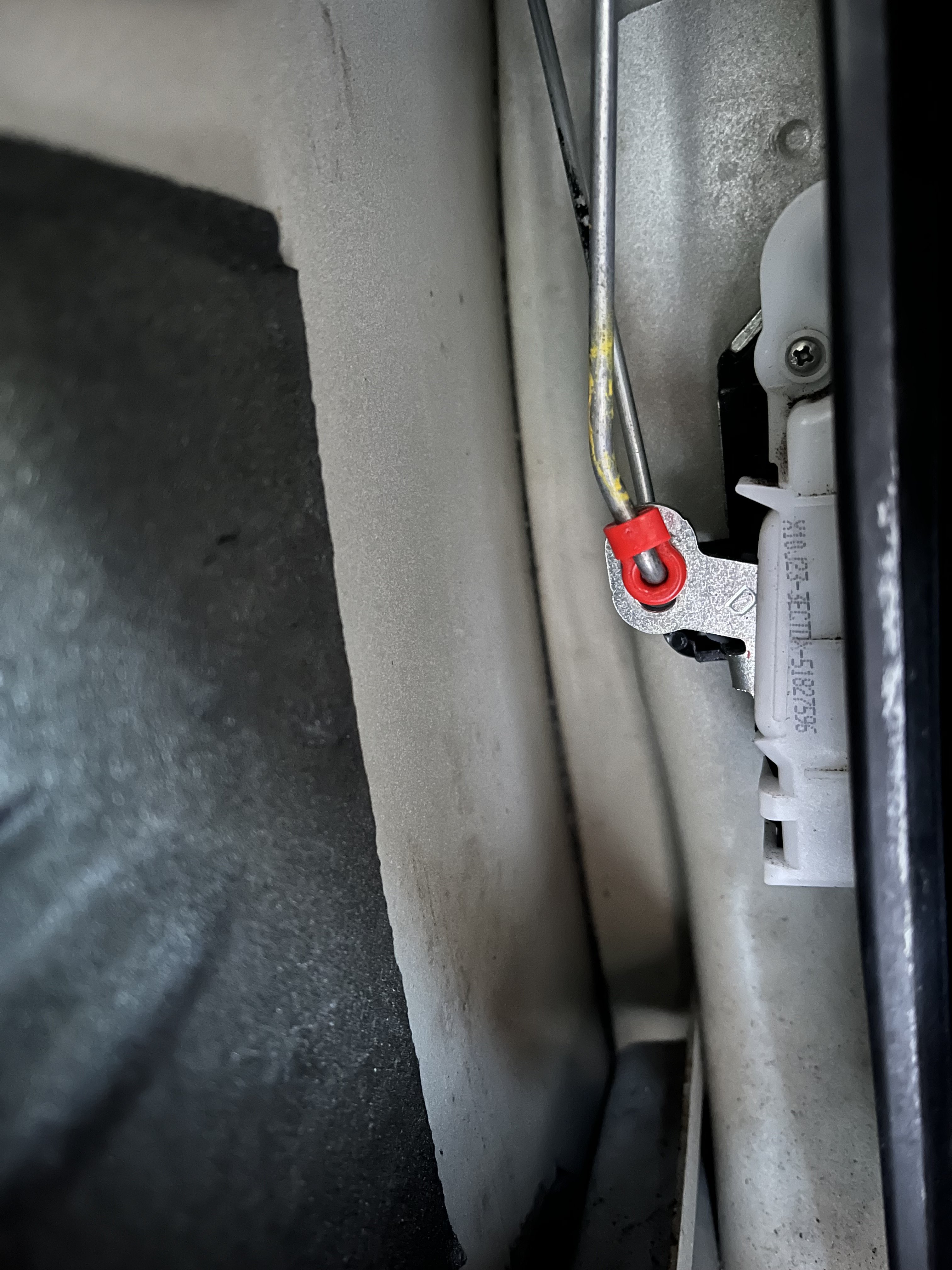

I have a 2010 Fiat 500 lounge
The drivers side handle broke, a common problem as I have been told
I bought a new handle from eBay. Took the door panel off, removed the old handle and even managed to swop the door lock over.
I put the new handle back on but the connecting rod keeps falling out of its hole.
It’s the rod that fits into the red plastic insert
This insert does not have a retaining clip like the other inserts. Just wondering if it should?
This is actually the bit that broke so I don’t have anything to compare with
Photo 1 shows the rod replaced
Photo 2 shows it fallen out after 3-4 times opening the door
Photo 3 is the original part stripped out
Photo 4 shows the lower section of this rod where the red insert has a retaining clip
Grateful for any advice
Thank you in anticipation

Link above from Varescrazy. They are not meant to have a tab at the top. It's only the bottom ones that have the little tab that holds it in place. That red clip you have at the top is actually the wrong one, that may be why it's falling out. Those are white and have little teeth that hold the rod in. It looks like someones been in there before you and used an old red one.

Thank you so much
This is actually a new handle from EBay which I shall be returning with appropriate feedback! 😡
