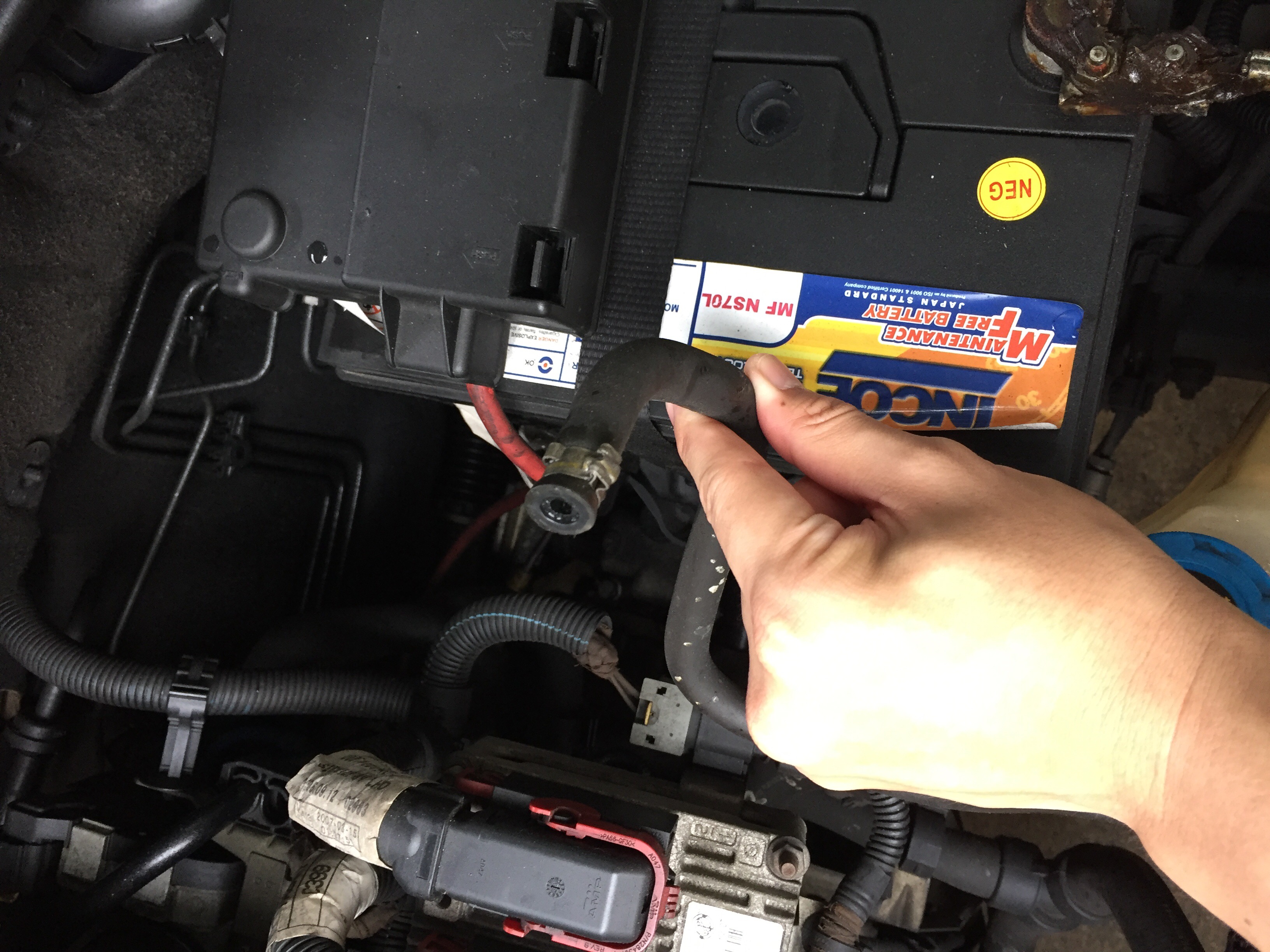

Oh just realised I missed the picture of the broken hose/pipe or part that was broken off..
The other end is attached to the coolant reservoir.

Yes, that's probably the little plastic spout that screws into the side of the themostat housing. A cheap and nasty solution if ever there was one! It's a relatively easy job. I got a Wahler thermostat (a good make) from Eurocarparts for about £35, I think. It has the same pipe but in metal.

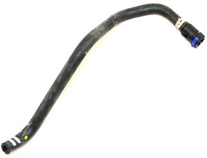

No it's not that part.
This is just the hose with the quick release connector.
part no 55703092

The quick release clip comes with the hose (it's not a separate part)
The other end is on the thermostat and it's metallic (even on the original fiat part)
That's interesting. Ours was plastic and I assumed it was original, but maybe the car had been fitted with a replacement one at some point?
The other one is plastic (the one connected to heater matrix pipes)
Yes, you're quite right, I was talking rubbish! I've just looked at the old housing (kept it in case I needed a spare temperature sensor) and it was, indeed, the larger diameter plastic spout that had snapped off.
