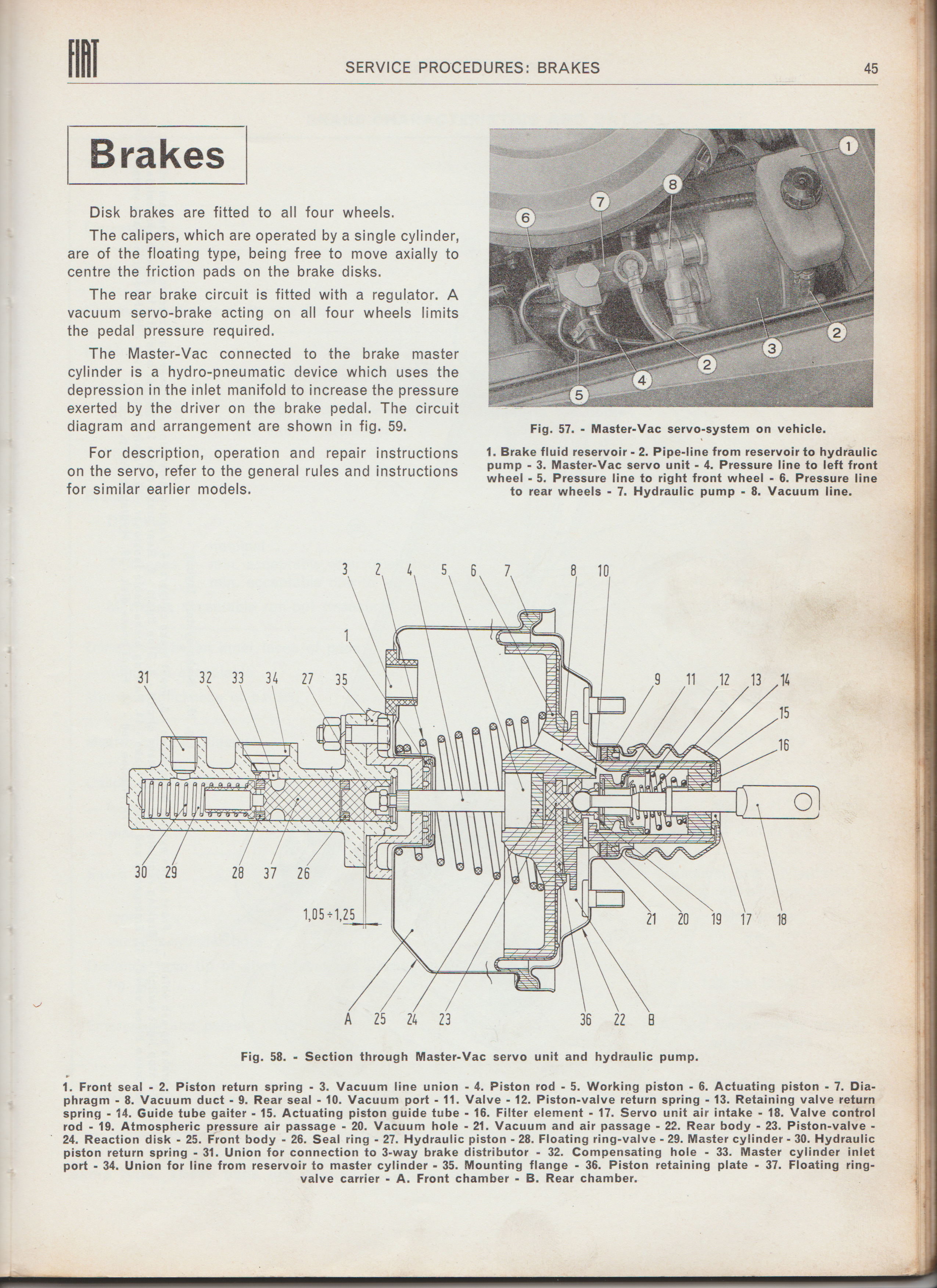

Hello all, I have a new to me 1982 Fiat Spider. Beautiful! Brakes were good but brake booster had vacuum leak. Installed new brake booster, and while I am there, changed master cylinder, 4 calipers and pads, brake lines, and brake compensator. Brakes are VERY WEAK. With engine on, I can push pedal to the floor (with some effort). I have changed the master cylinder twice now. In both cases, I bench primed and then primed in place as well. I have used multiple schemes to ensure no air in the system (push from the reservoir and pull from the bleed valves).. Beautiful clean liquid comes out the caliper bleed plugs. I originally did not change all the above, but in the process of trying to make it work again, I have progressively changed more and more, with new parts from Midwest Bayless.
Help!!!! I do have car experience and have restored some cars before but of course plenty of you know more than I do.
Some details/symptoms:
I did have to regulate the brake booster piston length to a very low amount to match the original one. I know if I "make it longer" then I cannot pass liquid through the front brakes. Now, it is just barely pressed when I fasten the master cylinder over it. All four calipers can be bleed very nicely.
When I press the pedal, it has maybe 1 or less of "Free play" (seems ok). The whole brake pedal travel is around 10 cms. At around slightly less than half the brakes are strong enough that I cannot push the car, but I should not be able to push the pedal all the way down (which takes some effort but still that is not correct). Again, I have primed the master cylinder several times and I can see no bubbles at all.
Somebody please take pity on me and tell me the obvious thing I am doing wrong...

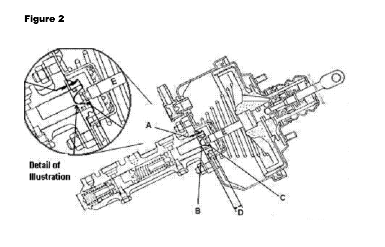

Brake booster (servo) pushrod adjustment should be set so that the tip of the pushrod protrudes 1.05 to 1.25mm ( 0.041 to 0.049 inch) beyond the surface to which the master cylinder is mounted on the brake booster, see diagram (disregard that it shows a single circuit master cylinder) below:-
To check servo is functioning normally, with engine off, press brake pedal several times to expend any vacuum, pedal should then be hard, hold the brake pedal down while starting the engine - as vacuum is built up in the servo, the brake pedal should drop a little but still be firm but probably a bit less so than before.

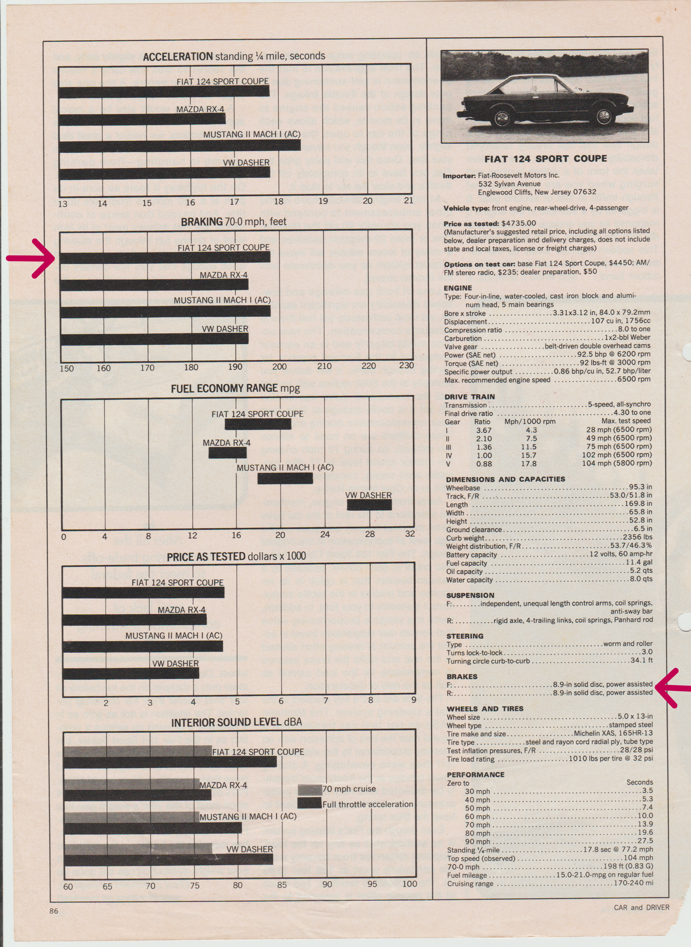

Incidentally I was interested in the Road test Brake comparison chart from @124BC1 as in the mid 1970s I worked for the Mazda dealership and often drove Mazda RX3s and RX4s with the Rotary engine in shall we say "spirited fashion" and found no problem with braking compared with other vehicles of the day, so if the Fiat 124 Coupe was giving the best braking figures, roughly in line with the Ford Mustang of that era and better than the Mazda, then quite fair for those days.:)

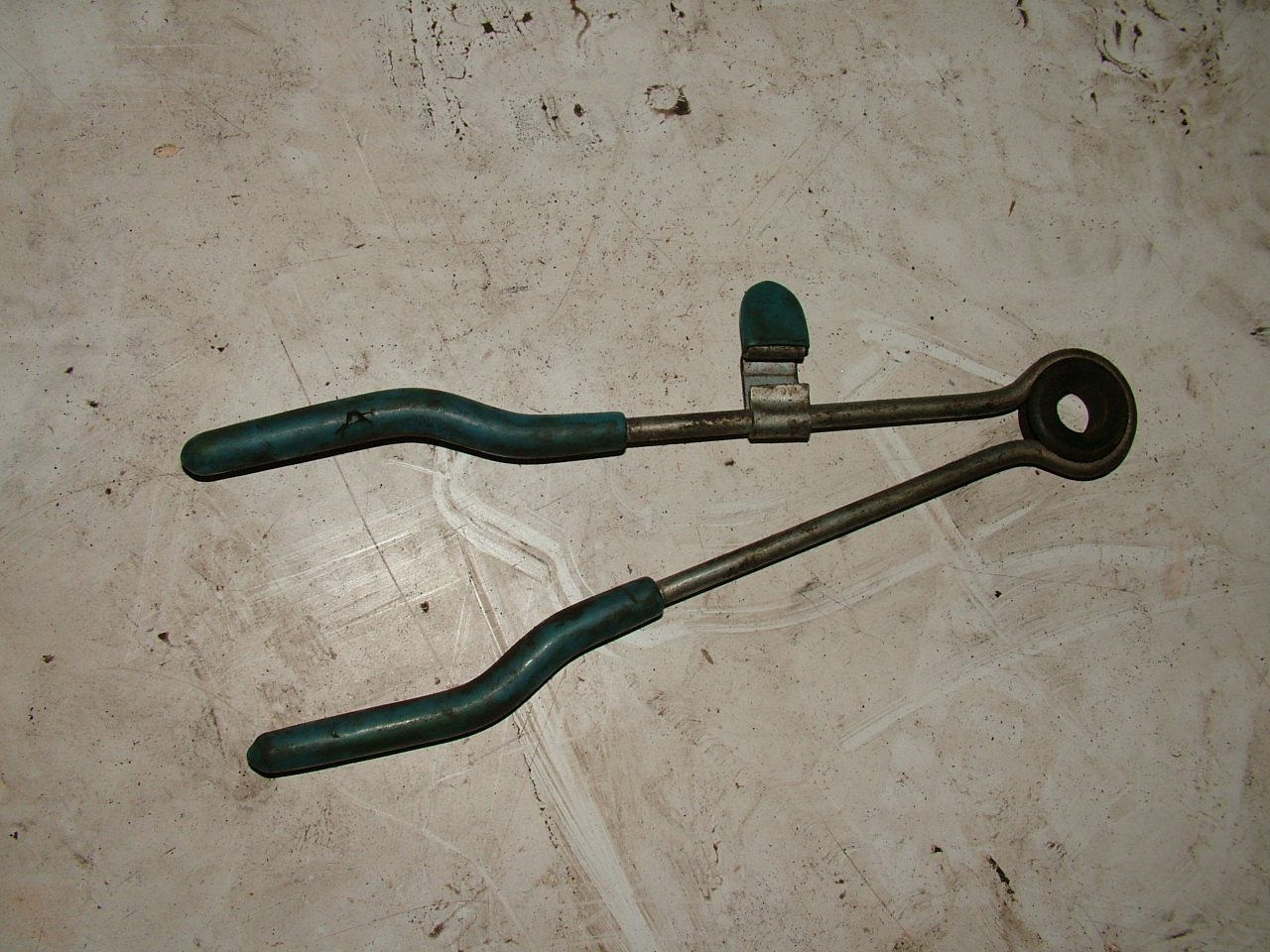

Re the brake pipe clamps, my Girling ones have died a long time ago , so now use this type, which are quick to fit and release.
As an apprentice, I recall my boss loaning a set of brake pipe clamps to a regular customer, but on return the guy was complaining about them damaging his pipe. He had fitted them to the metal pipes!!! :):):)
