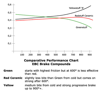

EBC Greenstuff have very good initial bite when cold but the coefficient of friction starts to decline as soon as they begin to warm up. Track pads are designed to do the exact opposite of that - generating higher friction/more stopping power as they heat up. See attached graph.
The bigger, heavier and faster the car, the less successful Greenstuff will be. EBC themselves suggest that they are suitable for "...lighter model Asian and European sports compacts". Greenstuff pads are fine for everyday driving and they do inspire confidence when cold - but I'd never use them on anything that's driven briskly, or where the brakes need to be at their best when hot. The Greenstuff compound is also pretty soft, so won't last as long as some others.
