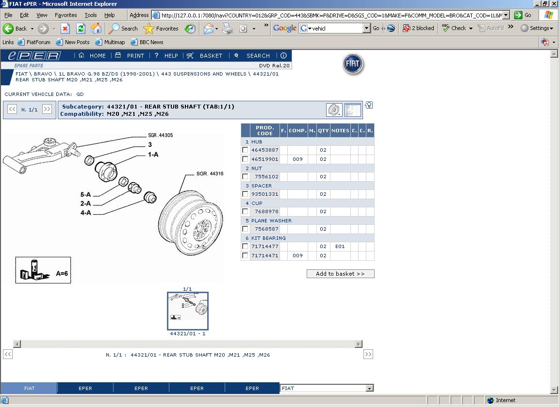

The 'hub washer'. Where does this fit into the scheme of things? Do you need to remove the hub to fit the parts behind it? Disc Guard/Calliper Mounts?
The Bravo's with drums, have a 10mm hub washer/spacer say, to accomodate the hub to match the size of the drum. With discs they are much narrow than a drum therefore the Hub needs to be brought in abit, therefore you need the 5mm hub washer/spacer to accomodate the hub with the discs.
And yes its the only thing to fit behind the Hub amongst the disc guard.
The part marked "Kit Bearing" differs in part number between the HGT 71714476 and all the others 71714477. Any idea what the difference is?
