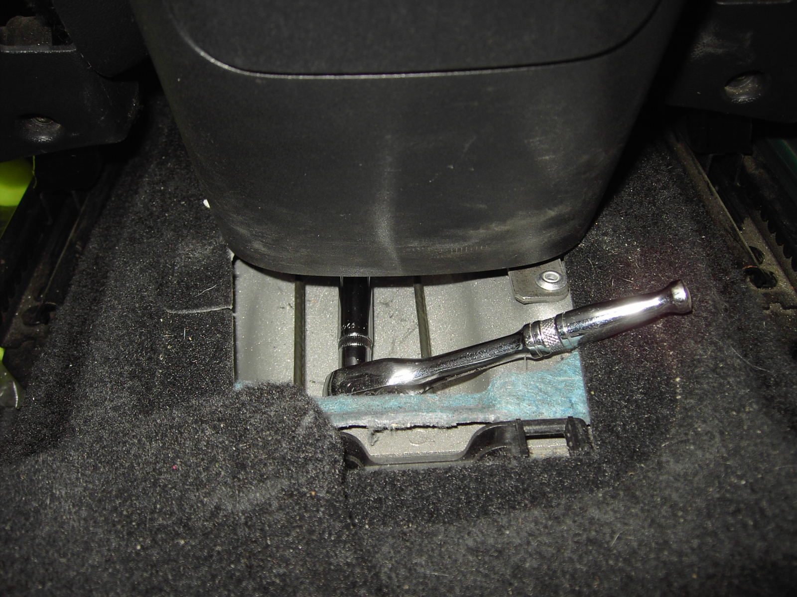

You will also need to fully release the handbrake cables from below the cover behind the centre console before retracting the pistons.
