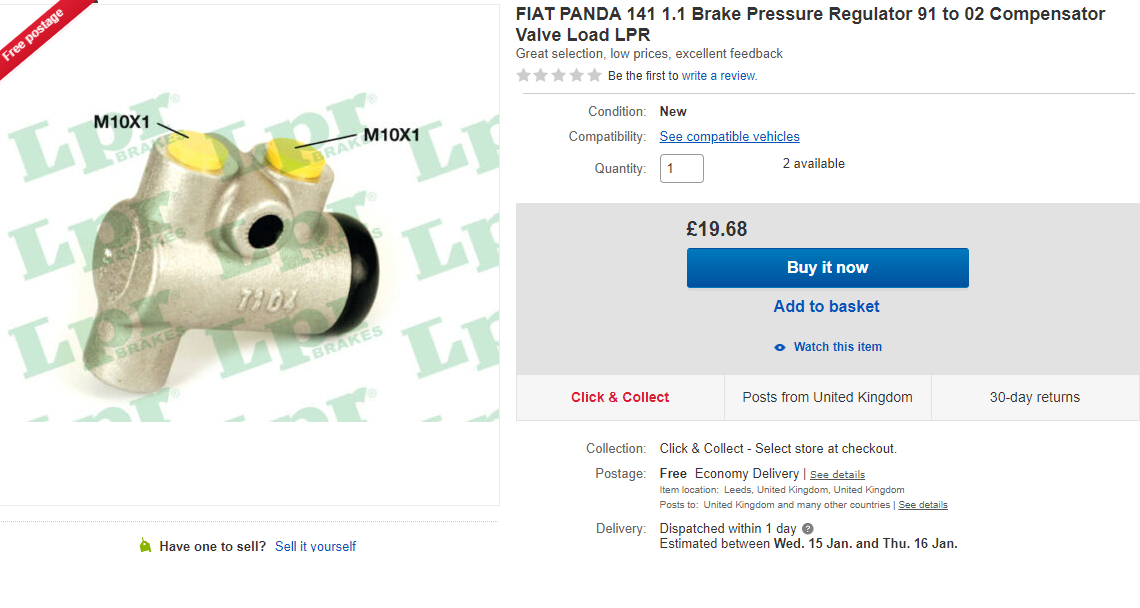

Those were broken on my cinquecento as well, the ones which I could find for cinquecento were very expensive around 60-80 pounds each, I decided to risk it and ordered some for another fiat I can't remember which one it was, either classic panda or uno since they were only 12 pounds each and they fitted and work perfectly with the factory brakes
Take a look at the pictures on page one, maybe it was one of them. I thought that Uno used just a single valve for rear brakes?
I think those were the ones I used, or at least they look the same, but the place where I bought them from had more pictures where it was visible that the pipe at the bottom has no exit, I don't know what it is for, its just blocked off :confused: and Im pretty sure I payed 12 pounds for them, not 20
