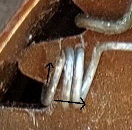

koalar Distinguished member Written a review Joined Oct 24, 2016 Messages 11,785 Points 2,851 Location Cheshire Apr 21, 2021 #21 without this angle the will never work whether latched as per jackwhoo or bent elsewhere Attachments temp.jpg 13.8 KB · Views: 32
koalar Distinguished member Written a review Joined Oct 24, 2016 Messages 11,785 Points 2,851 Location Cheshire Apr 21, 2021 #22 slightly concerned about the rest pull the rubber seals back check for weeping. Check both pistons slide freely springs have to be fully seated and hook in the direction of the pull as well as being bent. this spring is likely to fall off Attachments temp.jpg 68.1 KB · Views: 31
