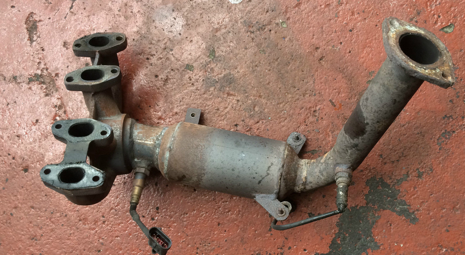

As for the exhaust manifold, any ideas why this isn't coming away? Can't see any other bolts unless there is some kind of bracket holding it in place?

That at least sorts that issue and I think the exhaust manifold is just the support bracket although there is absolutely no wiggle in the manifold. I presume this is normal as the bolts to the head are to keep it tight to the head rather than to support its weight.
This all make sense?
So can you tell me where the extra bolts for the exhaust manifold is? I've removed the 4 for the head where are the other 4? I have no heatshield on my manifold?

manifold
attachment.php
Thanks for the pictures. Lol. I've only removed the top bolts.
