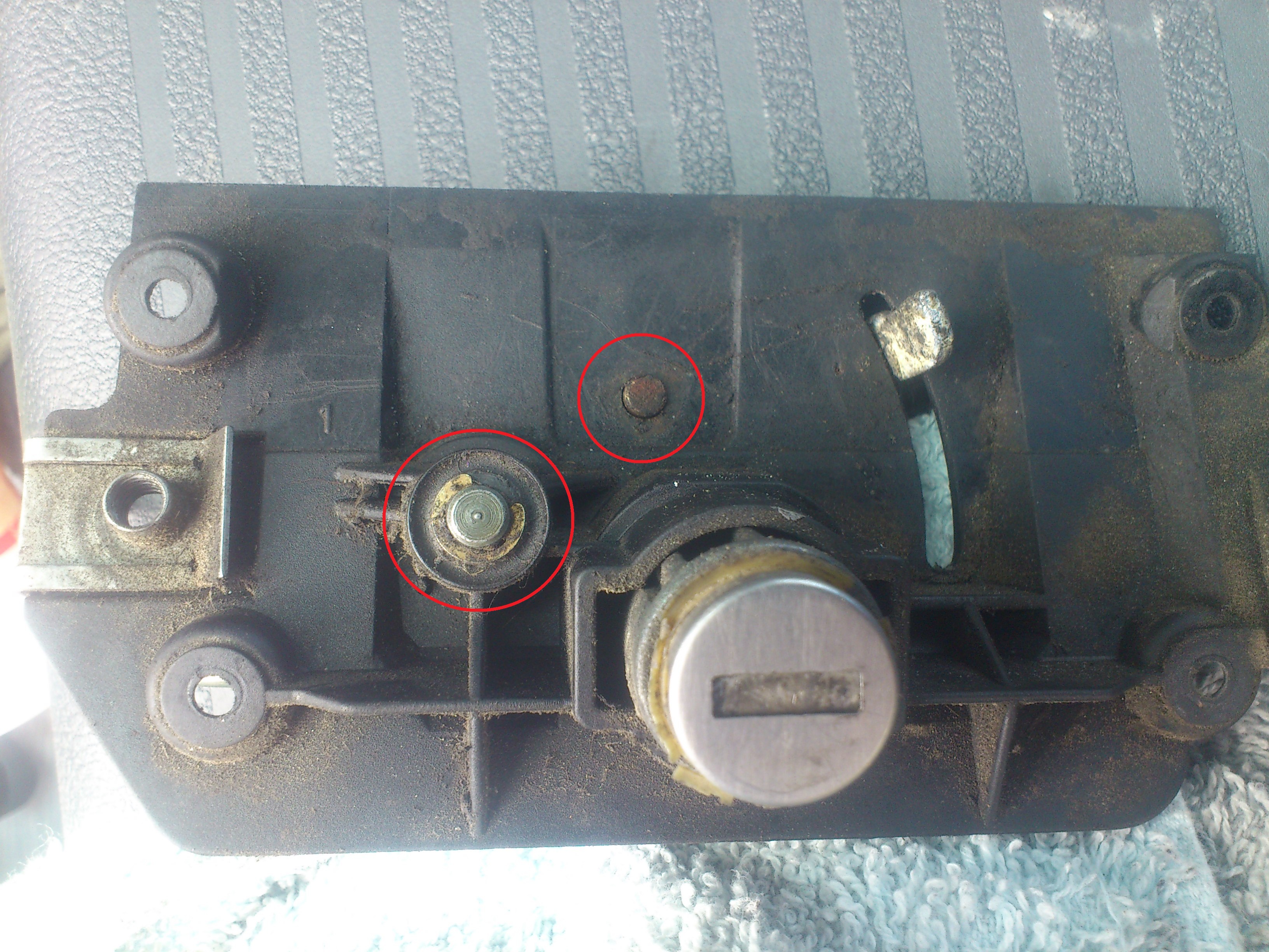

the rear wiper came off, and i proceeded to remove the reg plate lights, the exterior screws, then the inside moulding and whittled it down until i had the mechanism in my hand. after a bit of playing and looking at it, it seems a holding washer/grub is missing, how, and since when, i have no idea. It may have been loose in the assembly and fell out when i took it all apart, but i don't know, i scraped the floor with a large magnet, but no luck, it may be copper/brass. anyway, does anyone know where i might be able to get a replacement washer/grub thingy, or might it be easier to get a replacement from a scrappy, are the bravo mechanisms the same by any chance?
here's a photo with the red circles indicating what it looks like, and on the right, where it is missing.
cheers, Allan

So, after having a look at the bonnet, there are no washers in the form i need on the badge, there are washers, but they were a different type and size. so i resorted to looking in my "box of bits". I eventually found a piece of computer case corner bracing, if i remember correctly, this case was steel, but most likely it's aluminium, i drilled and enlarged the screw hole to 4.5mm, and then sawed down through the hole to the corner so as to be able to open it up easily, then i put it around the groove in the pin, and clamped it with a pair of pliers. to keep it from re-opening, i applied a coat of silver solder across the gap either side of the pin. afterwards i had to make sure it was filed down to the height of the pin, as the boot handle rubbed otherwise. botch job, but it works, and cost nothing. :slayer:
Allan
What you are missing is a very small C clip I think. Mine fell off a couple of years ago but lodged under the handle, it then fell off again but disappeared this time a couple of months ago.
I went to a couple of local garages and found one with an assortment box of C clips, a couple of quid later I had a replacement and a few spares. I suggest you do the same. The garage I was successful at was an old country garage, the two or three bigger more modern garages were no help at all.
Good luck :)

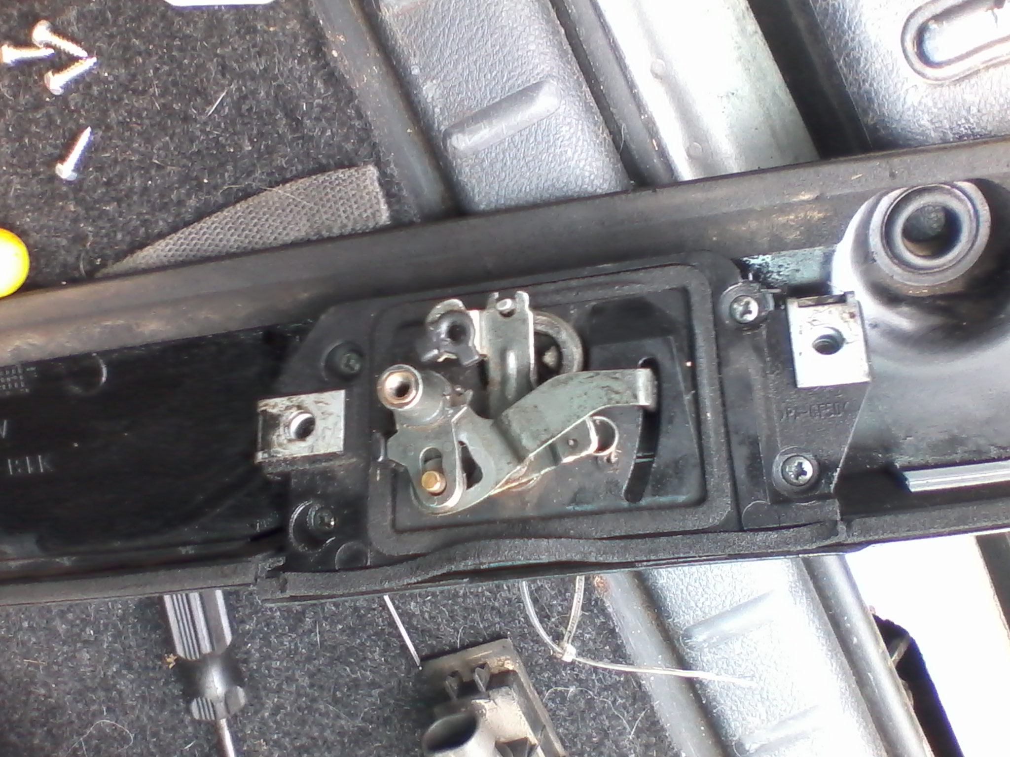

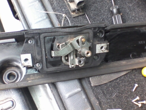

hey Charlie, here are some old photos' i found while digging through/organising the archives. Maybe they'll help if you haven't already got this far.

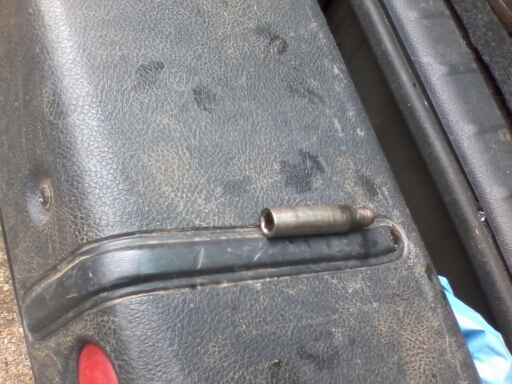

strip + lube rear wiper motor,
free-off / modify the tailgate latch / handle.
motor-marea 014.jpg with 4 x 7mm head self tappers removed
marea 018.jpg remove circlip + washer from splined / threaded end of shaft
marea 024.jpg refit M5 / 10mm HEX nut inverted. to protect thread when hammering shaft through motor
marea 028.jpg once it's gone so far, a bar / drift could be used.. or pliers on gear end and twist/ pull,
release oil will help here..,
on my 1st Marea the o-ring seal at top "spline" end had failed and shaft was REALLY Rusty,
stripped completely, wire brushed and re-greased..,
this one didn't want to pass the lower motor seal , so I just used oil in the spindle hole, and all was well.
didn't have a 7mm spanner / or socket to hand so I " improvised":D

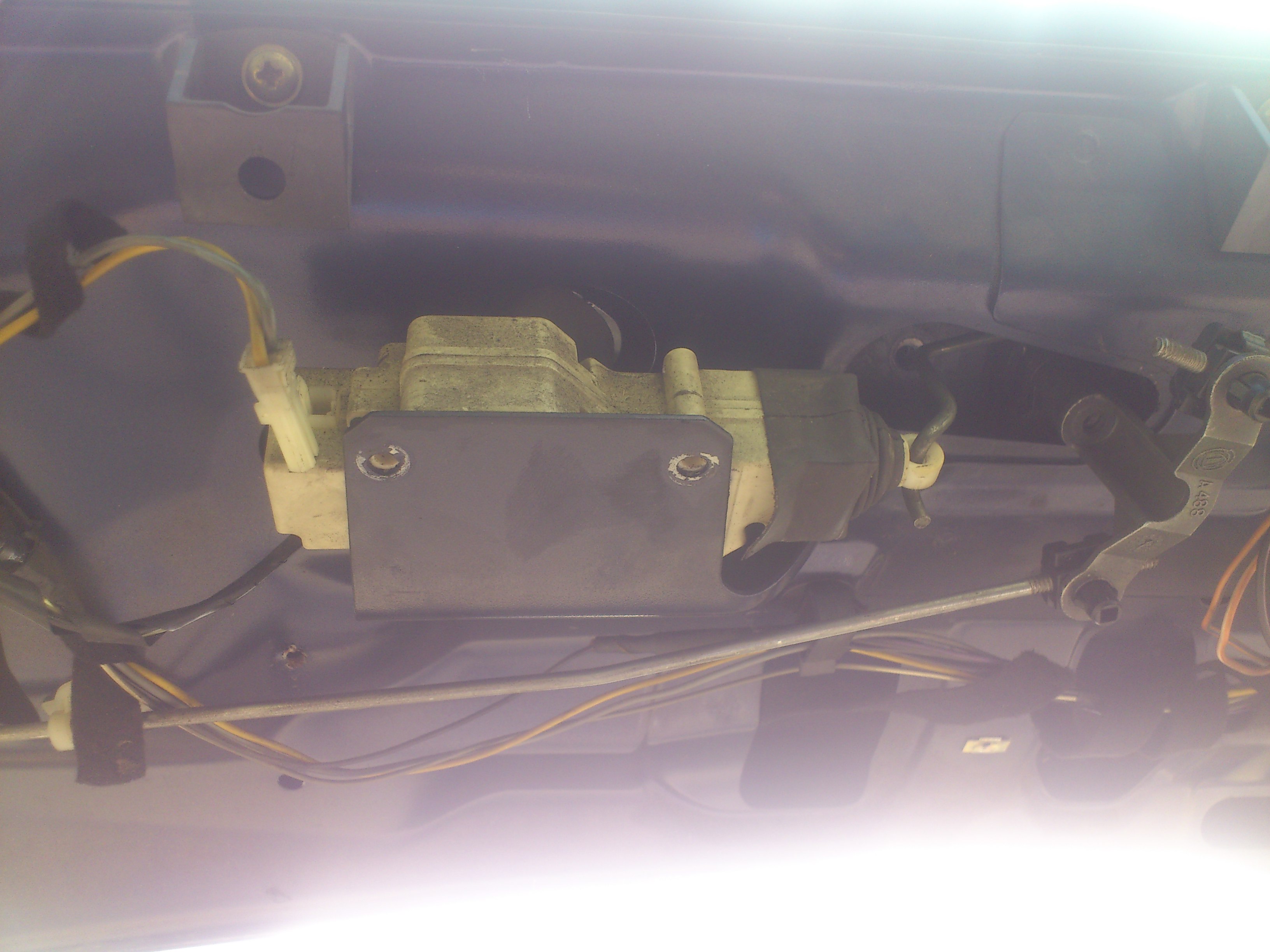

marea 032.jpg Lock mechanism - attached by 4 x self tappers,
easiest access is by uncoupling the Central Locking motor on Tailgate ( 2 x self tappers) and withdrawing the steel pushrod.
also found unplugging the 2 x rear numberplate lights simplified reassembly:cool:
Cheers Allan,
Your bottom 2 x pics ( with HAND);)
show you have to get around the motor to access one of the 2 x screws,
the other is on the opposite RHS of the tailgate, under the rubber boot,
they screw into these 2 x silvery threaded clips on the lock assembly
Charlie
