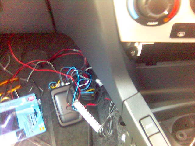

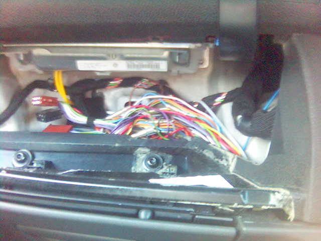

i've added a bluetooth car kit today..........has anyone managed to get the radio to mute as described in the stilo radio manual?

I think u can get cables from www.nexxia.co.uk or .com
Which kit did you get?? I am thinking of geting the SE one where you can have 5 phone profiles.
How did you get behind the console of you Stilo???
Not comfortable with pulling mine apart without some instructions (y)
I have a professional Nokia Car Kit fitted (not bluetooth) and the engineer said that the radio on the Stilo doesn't have a phone mute function on the back. They way around it was to have the radio cut out everytime the phone rings. The sound still comes through the speakers and when the phone call finishes the radio comes back on.
I'm not a sparky so don't fully understand but he did talk about splicing the wires.
All it probably means is that the stereo won't display phone or mute in the display. But just had a look at the nexxia site and they do the kit for the muting specifically for Stilo's.
He probably didn't have this, as it correct connectors. That is why he had to make do and splice the wires.

I just Bluetoothed mine through the Sony head unit I have installed not the standard Stilo one.
The only problem was finding a switched live, I used the cigi lighter power supply.
Looks great and works a treat, I fitted the blue tooth unit behind the upper glove box sleeve, the only part visable is the display which is fitted below the Headunit no visible wires.
