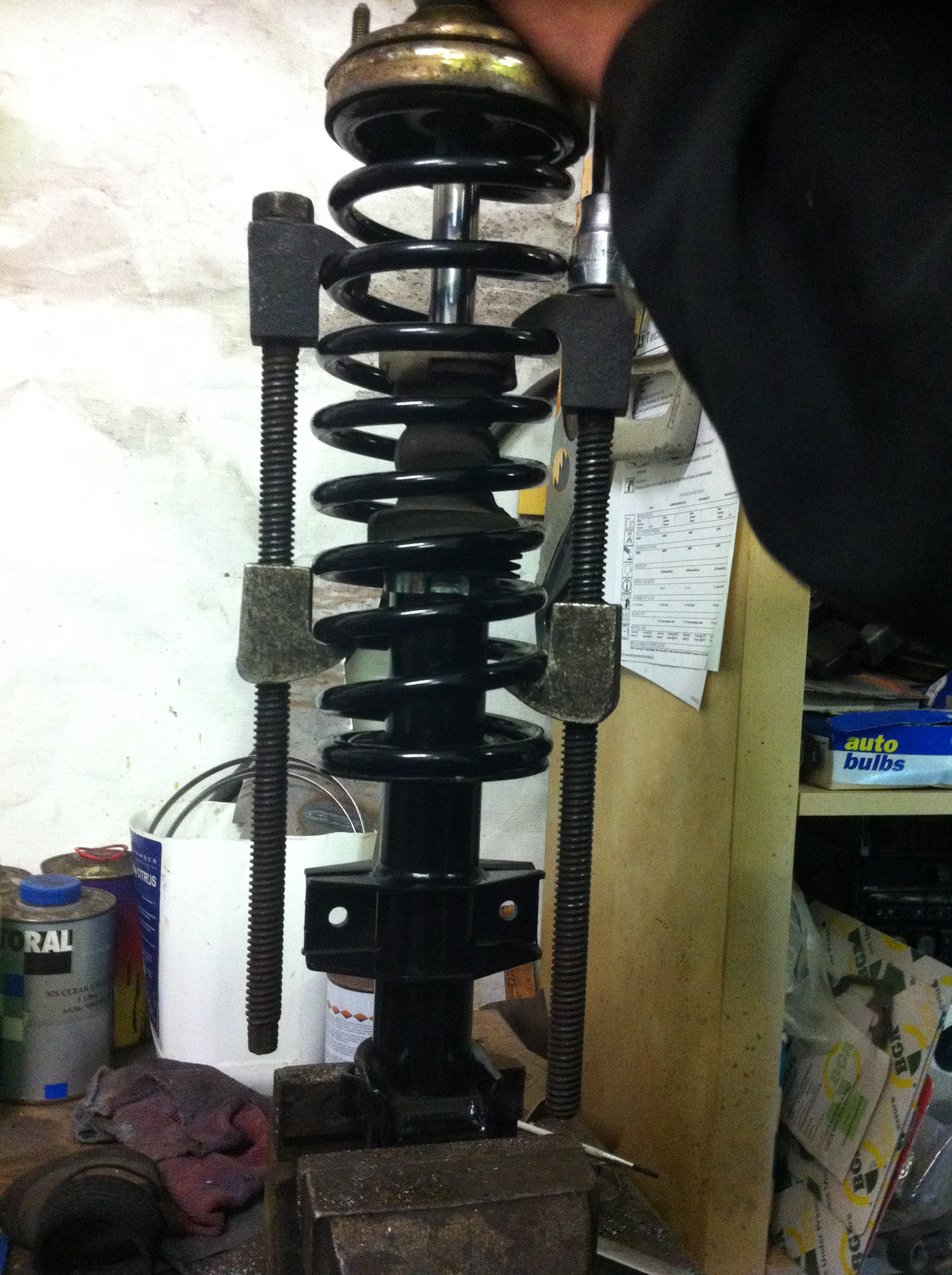

So, first job to be ticked off was new front shocks and springs. Gavin had ground clearance issues on our 4x4 weekend and I found that the front was slightly lower (about 1cm) than my own 4x4 Oslo.
Springs are original spec by Supaflex, shocks are Monroe.

Will be really interested to see if it feels less bouncy too. (y)
I had noticed it dipping more on our lovely smooth roads (spot the sarcasm Bucks County Council!) recently. I think the old springs, heavy bullbar, and some offroading finished it off! Poor old Howie does get some serious use - I'm so missing a Panda available for loading old cookers etc ;)

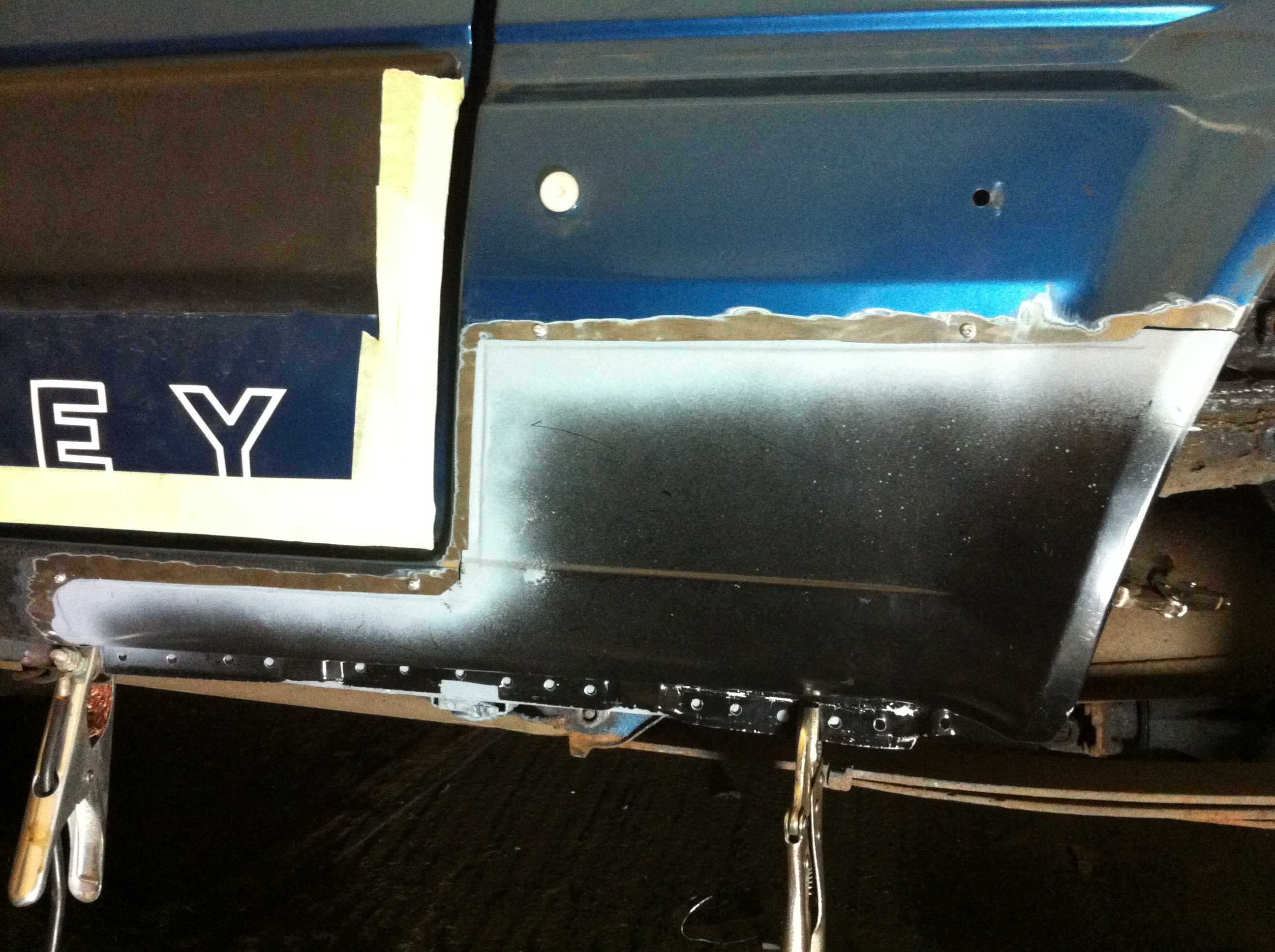

Since our return we have now managed to weld up the hole in the exhaust and make a start on the rust issues that will ruin his chances of getting an mot.

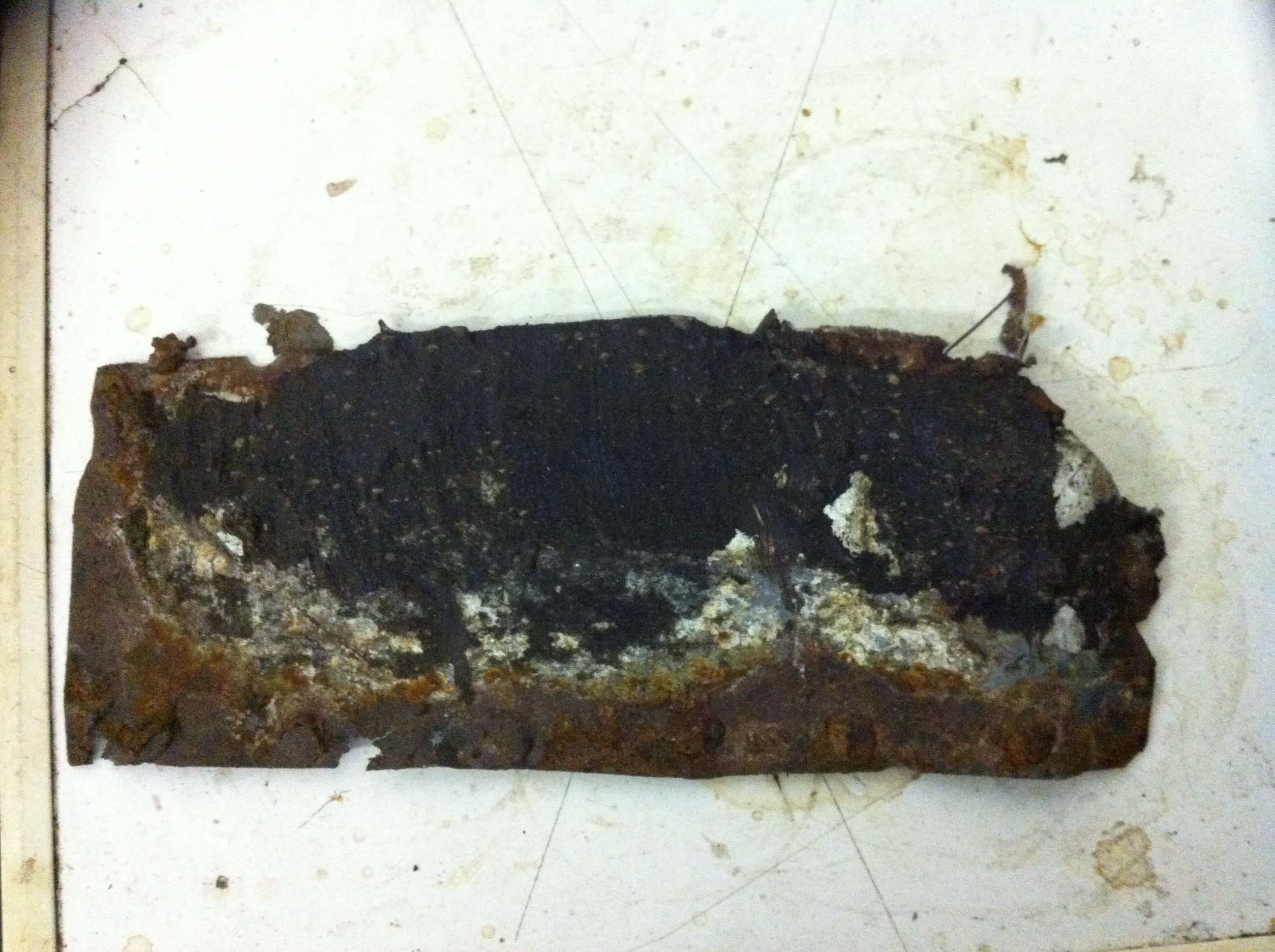

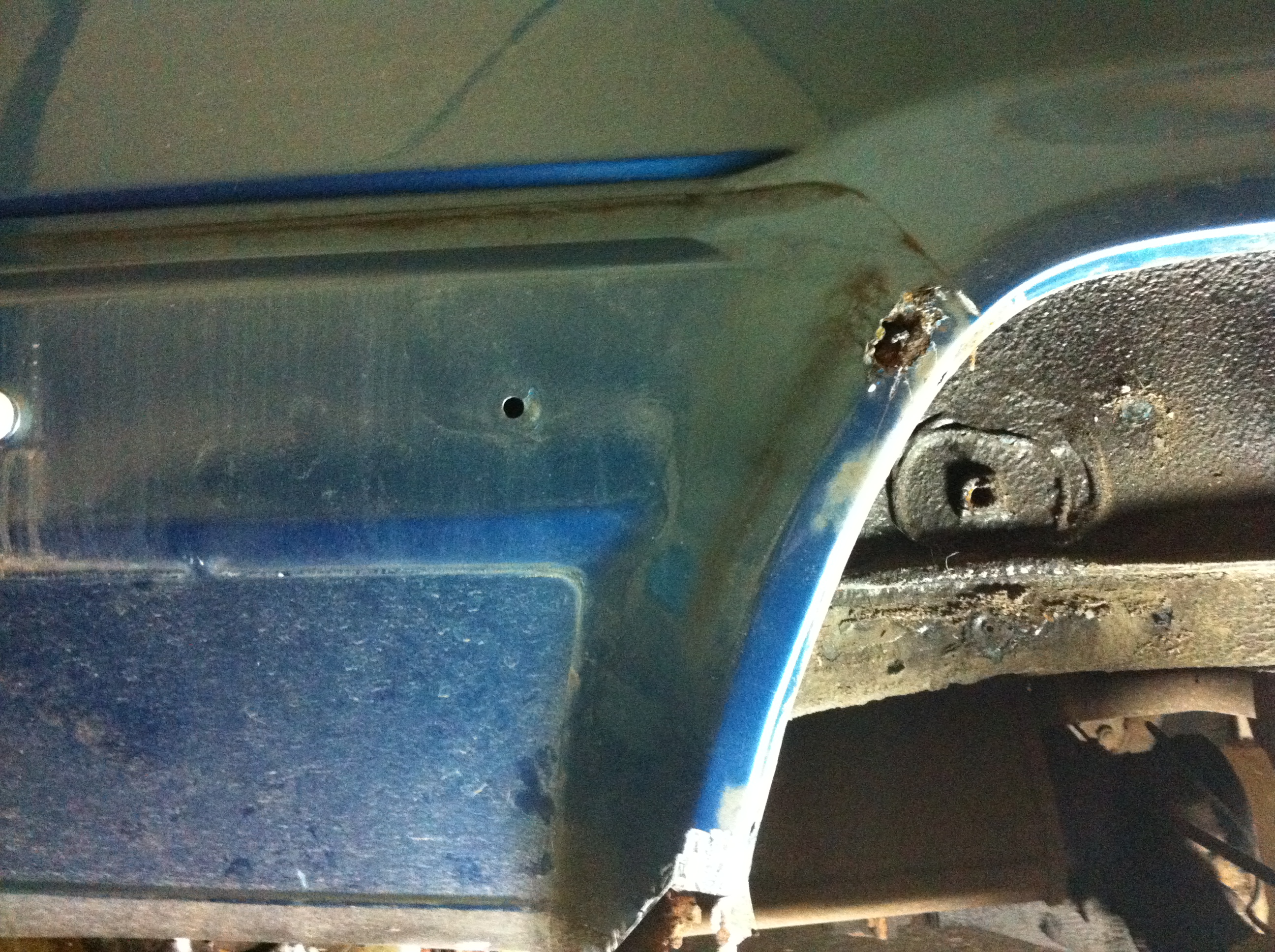

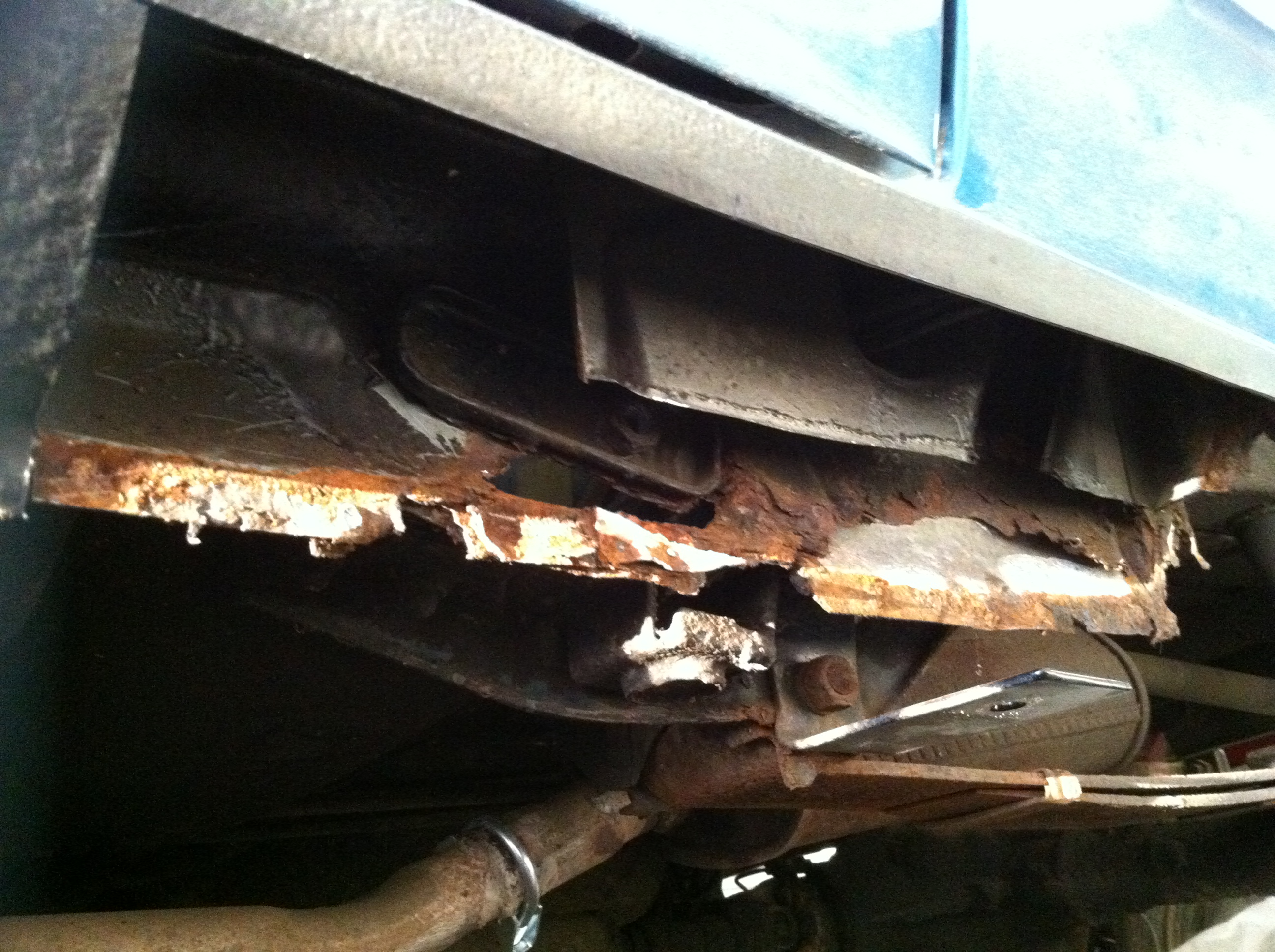

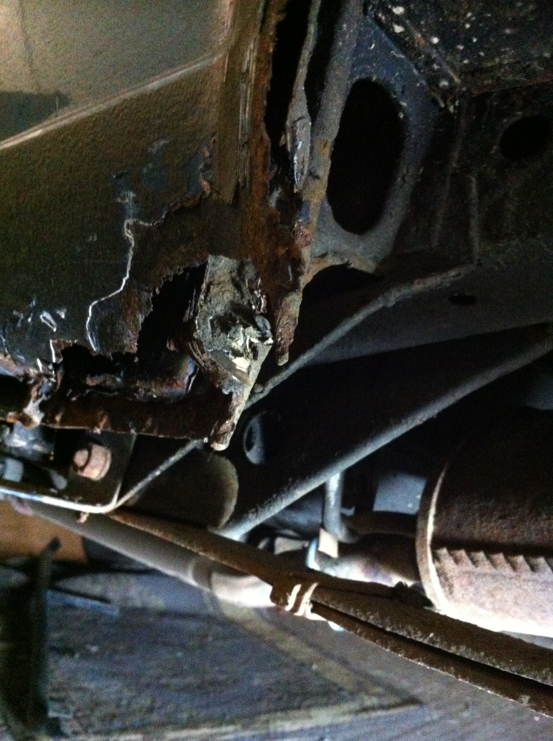

The areas we're having to concentrate on are the usual ones at the back of the sills. So far we've managed to repair the n/s sill, not a small job as the extent of the rust was far greater than what was visible. In Howie's defense I must say that there are probably quite a few Pandas running around that are just as bad if not worse.

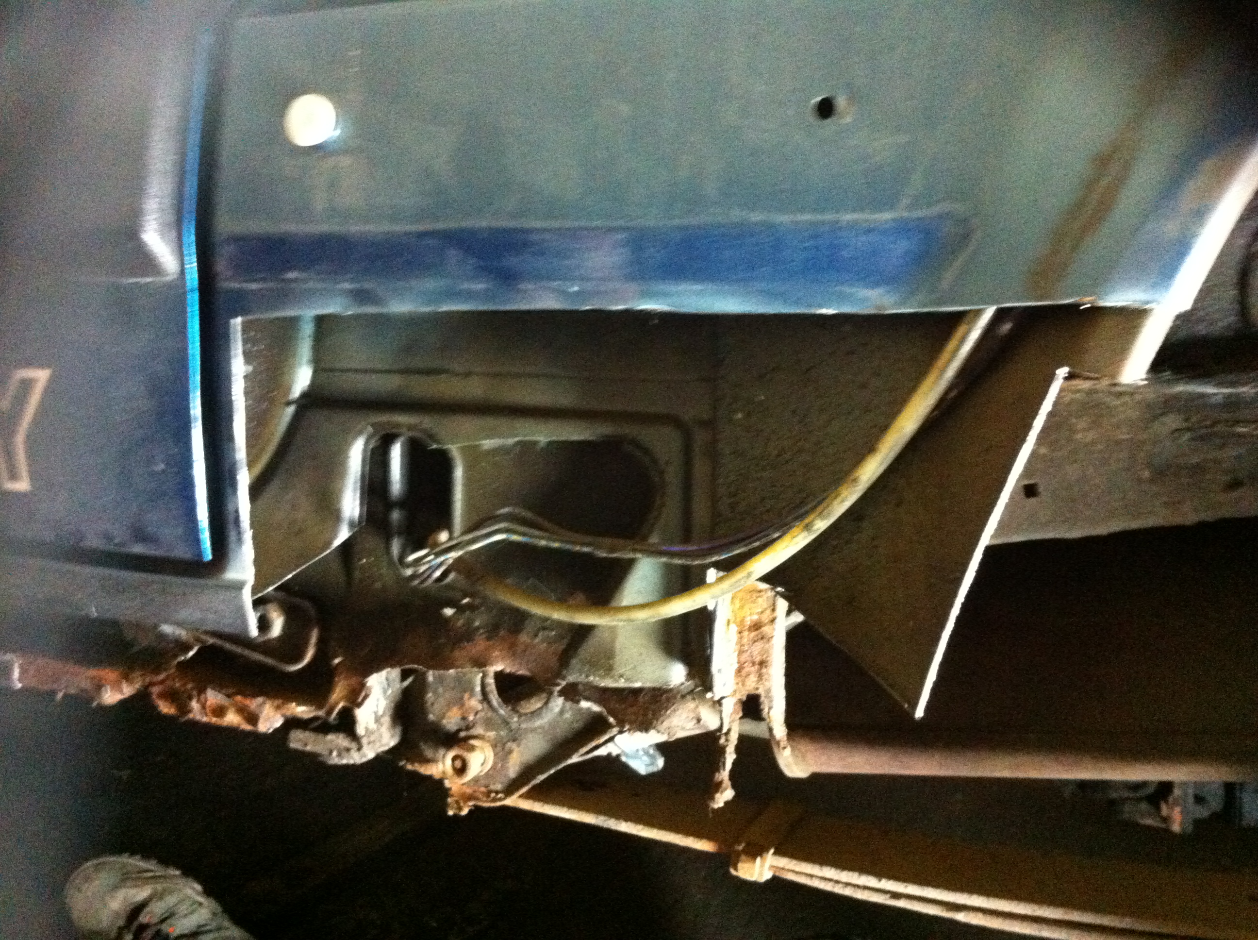

This is most definitely a keeper for Gavin so we're doing a thorough job which should last a few years. This means cutting away the outer sill to gain access to the rust behind, then cutting away that rust until you're only left with good metal.
There was evidence of a previous repair, a piece of metal that was barely tacked in to place, I guess it must have fooled at least a couple of mot testers though.......

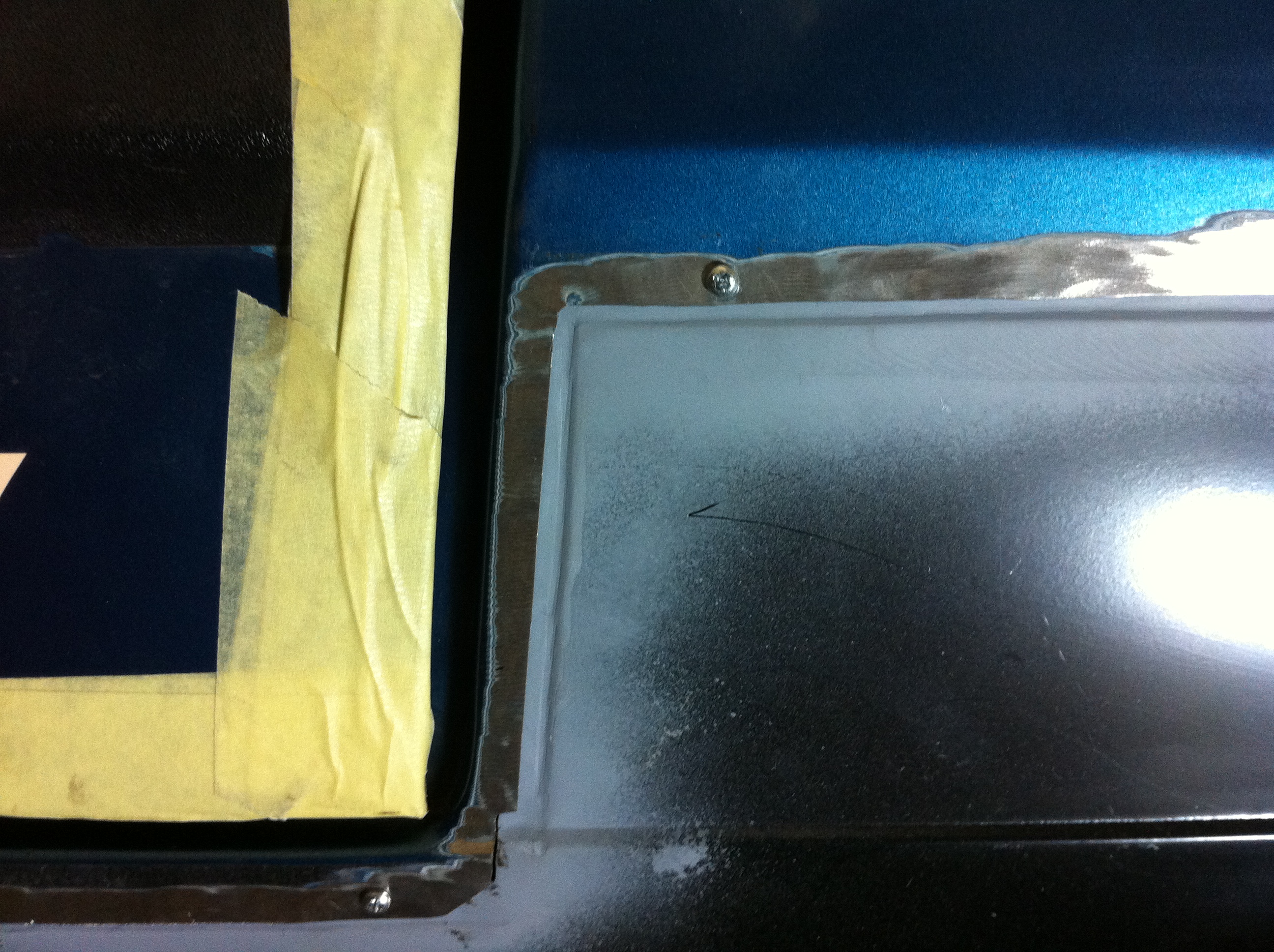

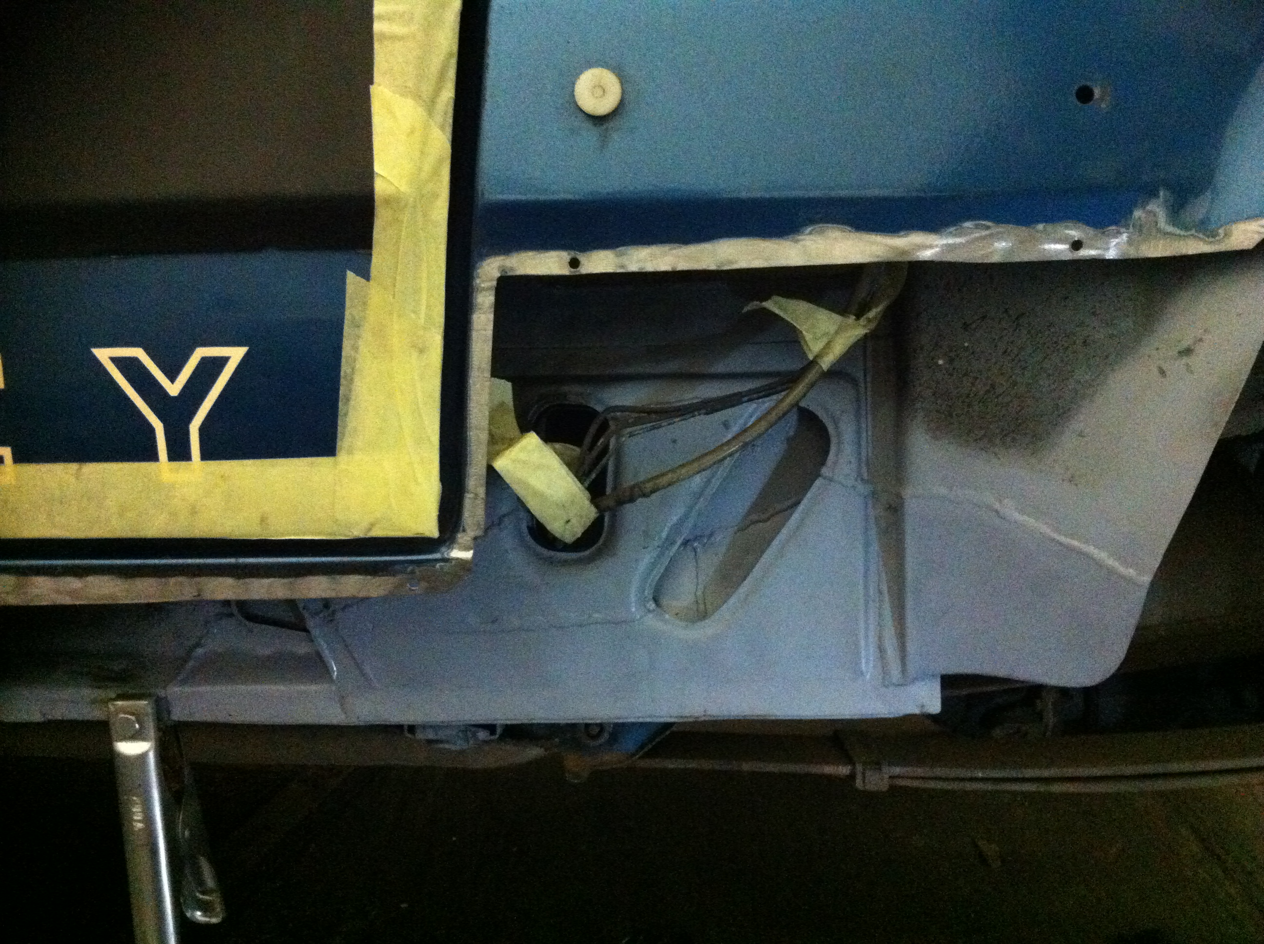

Next we started to put good metal back in, all the time trying to copy the shapes of the original panels. These sections were sprayed with weld through primer before fitting, then zinc primer once in place.
A new outer sill panel was then cut up to finish things off. We used a joddled joint where possible as this is much stronger. in fact the whole area should be much stonger compared to the few spot welds that Fiat try to get away with.
This took up most of last week so this week we'll be doing the same to the other side.
