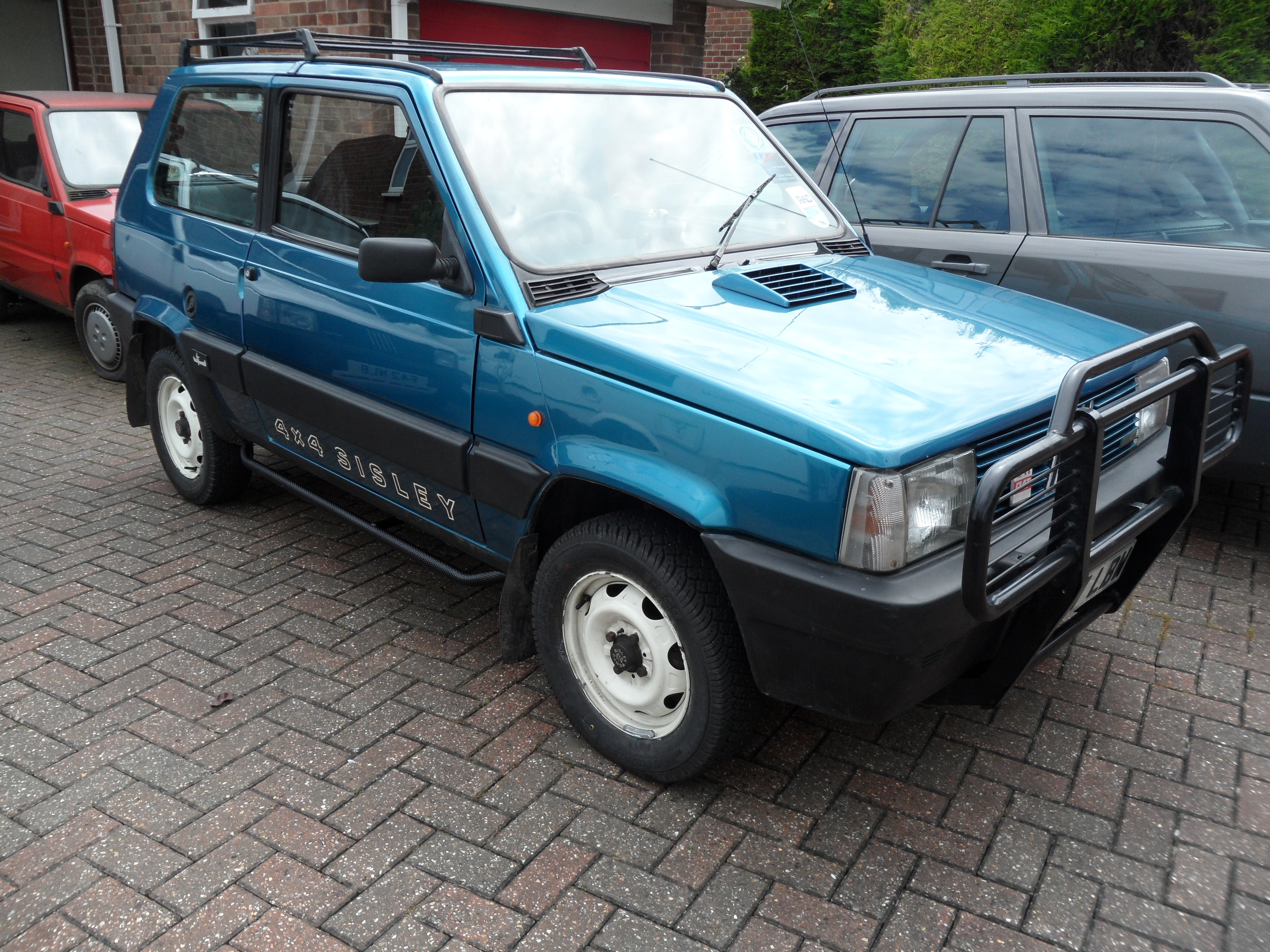

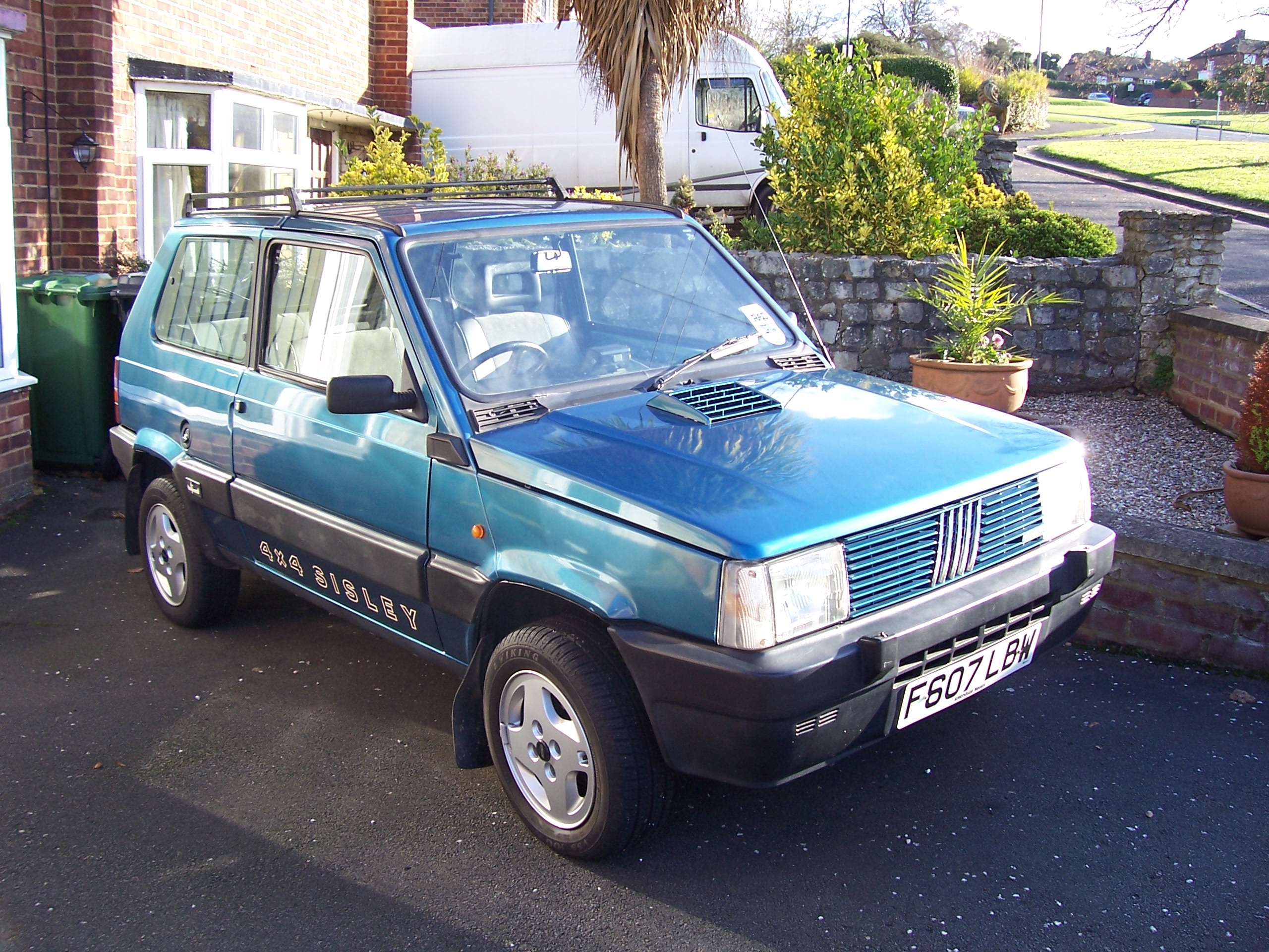

Completely original apart from the addition of period bull bars - these are great & it's amazing the new found respect from BMW drivers when you hurtle towards them! :D A few pics below including a brief spell on Cinq Sporting alloys.
I like the alloys Gavin, will go very well with the sumpguard. :)
Yours is the one on the left. I had to make it narrower at the front so that it fits between the bullbar struts. This meant there was only room for four rectangular holes instead of the six in the others. There you go, yours is unique :p. It's gone to be powder coated silver now, which is why it would look good with the alloys.

hmm.. i need to see how the bull bars fit onto the car... may make fitting the sump guard hard :/
Bullbars fit onto the brackets for the existing sump guard thing (the tubular thing under the front - technical description ;) ). They actually bolt straight on top of the existing structure but need a bolt with a few more turns of thread. They are a real bugger to fit on your own btw - it's like trying to wrestle a large metal hippo (weight & awkwardness-wise obviously, as fortunately it doesn't try to bite you Ahhhh) into place & you need about 3 arms to hold it and another 2 to get the bolts into place. (y)
yeah i did expect this, i have got a chain hoist in the garage to help hold it in place... longer bolts.. if they are standard thread bolts i am sure i can find some :LOL:

They fit into the jacking point and are tightened with a bolt. then at the back a bolt holds it to a bracket which itself is bolted to the front leaf spring bolt. really solid, you could pick the car up by them.
Cost, well the powder coating was £96 :( ( may shop around for this ). They could be painted to save money but I don't think it would look as good. I don't know how much they were to make as I haven't had the bill from the engineers yet. plus, I would have to source some rectangular bar as I'm guessing you haven't got two old jacks to cannibalise. Second thoughts, you probably have. :p
